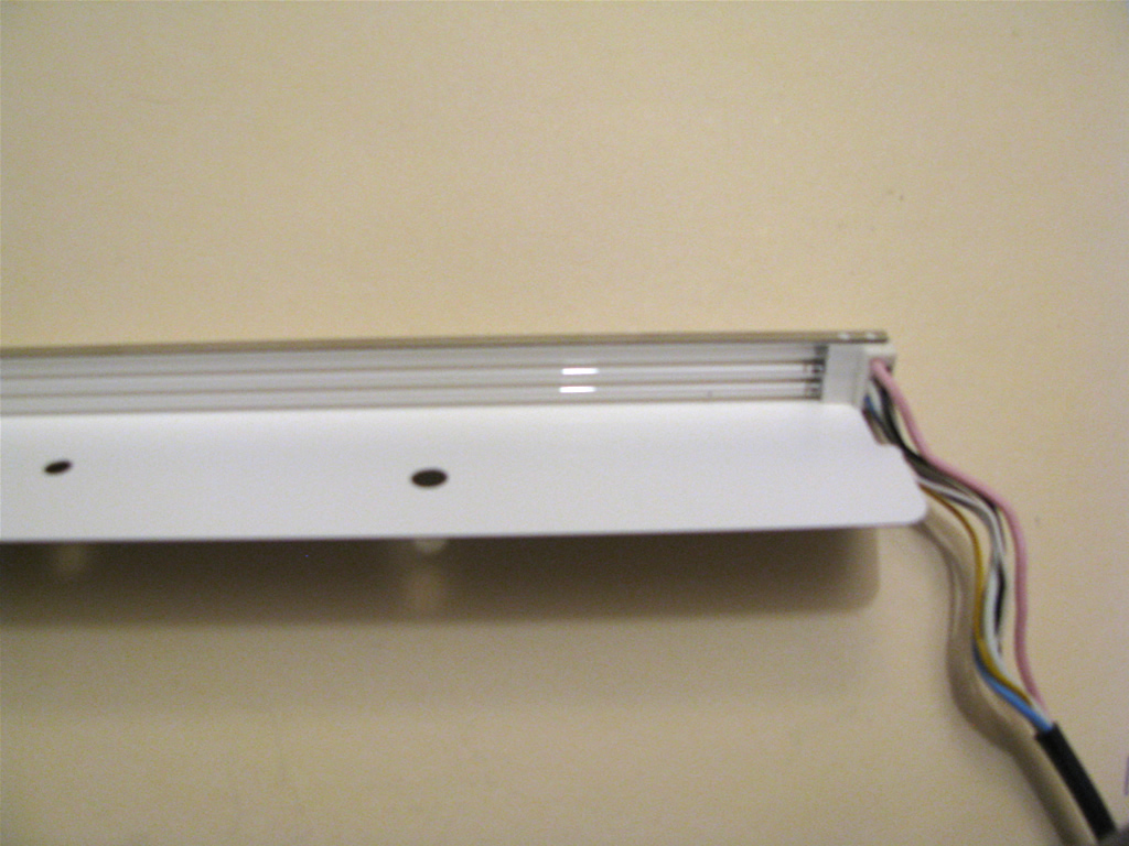

                                    For those who have never seen the guts of a panel here goes:
                                    Image 1: Essentially a metal tray with a sheet of white glossy plastic in the bottom. The angled pieces (wires attached) lying to the side each carry 3 CCFL tubes. These angled pieces slot in top and bottom in the tray creating a wall of light
                                    Image 2: One of the two angle pieces which carry the CCFLs
                                    Image 3: A 3/8 inch slab of clear plastic which sits in the main panel tray. On top of this sit 3 layers of plastic sheet (not shown). I guess they are polarizers, diffusers, or the like.
                                    Image 4: The failed CCFL return wiring
                                    Image 5: A bank of 3 CCFL tubes with wiring
                                    Image: 6 Closeup of CCFL ends with charring. White end piece is rubber and broken up somewhat with the charring.
                                    All the pieces are quite robust but I had to get my 17 year old daughter with her small hands to disassemble to CCFLs from the angle pieces. Have to go get some wire fine enough to rewire the CCFLs tomorrow, together with a can of compressed air and a microfiber cloth, the poor man's answer to a clean room.

                                      Glad to see that you found it. Since you are about to move this to the bone pile, you should consider trimming the end of the lead and re-solder to the tube bank. It certainly isn't an ideal solution but I brought one back to life this way and it's still running.
                                        Re: Samsung 215tw display cuts out
                                        I need to rewire the return leads to the CCFLs, shown in attached image. I've tried Radio Shack my only local retailer but can find anything of suitable gauge. Can anyone tell me what gauge wire I need and where I might order it, a part number would be of great help.
