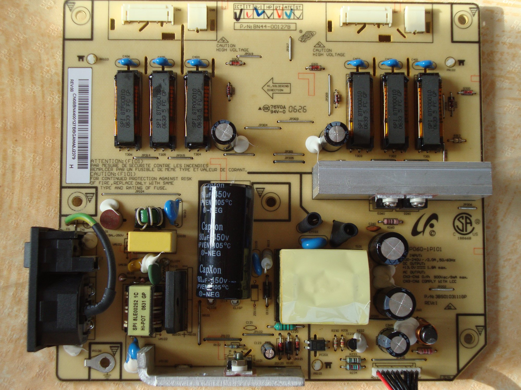

                      Originally posted by Mornagest View Post
                      I got the same issue with the same LCD screen ; according to a reparator, it seems it is an inverter problem, but I'm not sure exactly how to confirm that.
                      The problem is the same as Almoodie described : when switching the screen on, I get an image for about half a second, then it disappear until I switch it off and on again. The blue light that shows the screen is switched on is still lighted, so could it be a problem from the power board ? Is it still possible to buy a new one somewhere, on Internet ?
                      I thank you in advance ! (and sorry for my poor English as it isn't my mother tongue)

                      After many months of hibernation, I took the time to take some pictures from my cards... here they are, front and rear.
                      If you need anything else, ask me
                      Thank you !
                        The capacitor just left of inverter transformer T303 is bulged.
                        It looks like all the caps are Capxon. Capxon makes terrible terrible quality caps. See my standard answer on replacing caps (regulars may skip)
                        https://www.badcaps.net/forum/showpo...84&postcount=3

                          #72
                          Re: Samsung 215tw display cuts out
                          Once it is said, it looks obvious... many thanks !
                          I will try soon to buy a new one ; got a good electonic and electric store not far from my job.
                          Is there something special to do when soldering ? Got a 50% tin wire, does it fit ?
                          Thank you once again
                            As long as you have read my link above and understand the risks of NOT replacing all the caps, then go ahead. I'll say it again, Capxon makes terrible quality capacitors
                            Make sure your store sells "low ESR" caps.
                            Good old 60/40 with rosin core flux is my favourite.
                              Wow, I just checked the prices... it would be stupid not replacing all the capacitors ! It will cost less than 10 €, wire include...
                              OK, I will try to buy this tomorrow if I have enough time. And fix this as soon as possible.
