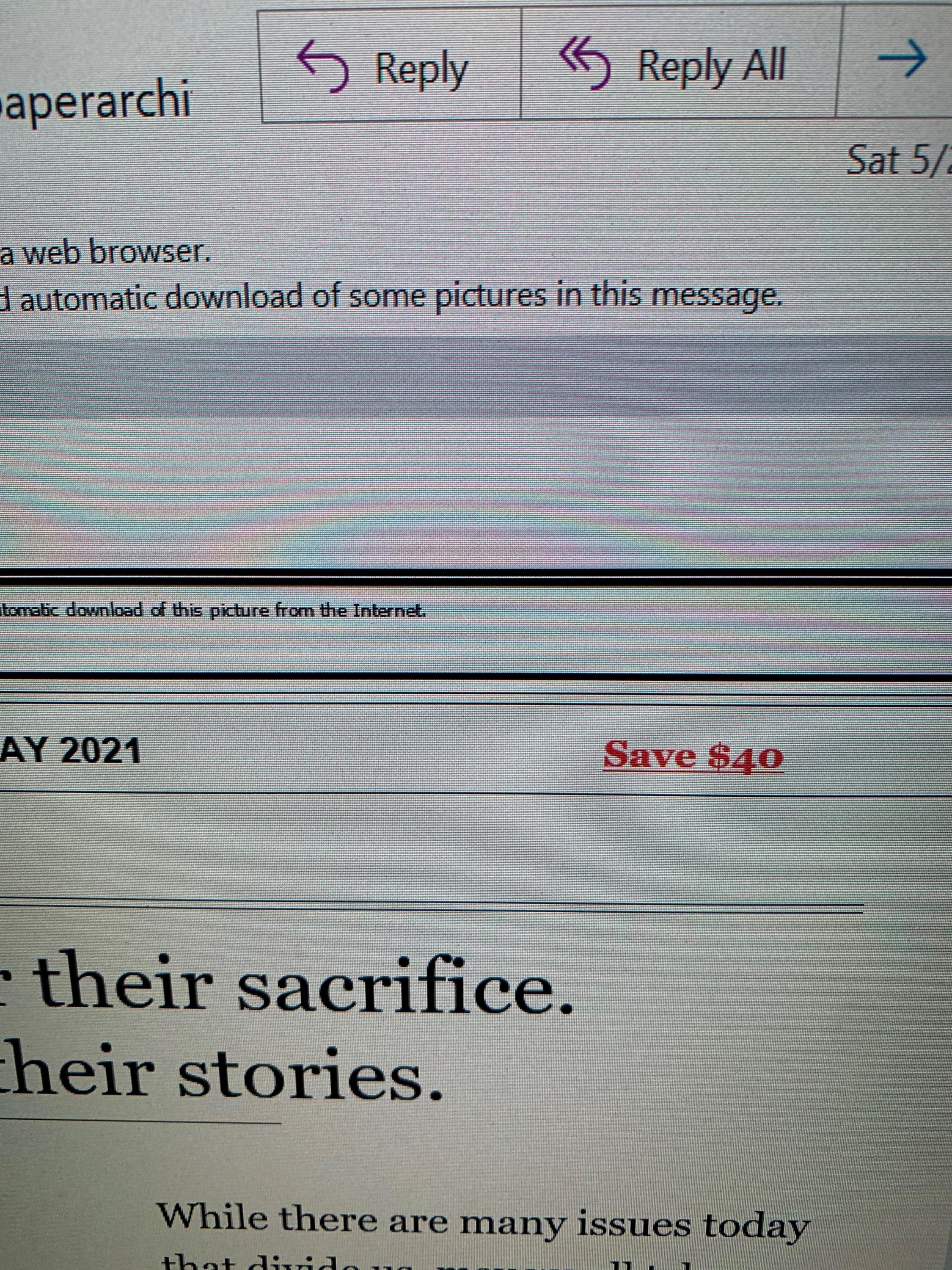

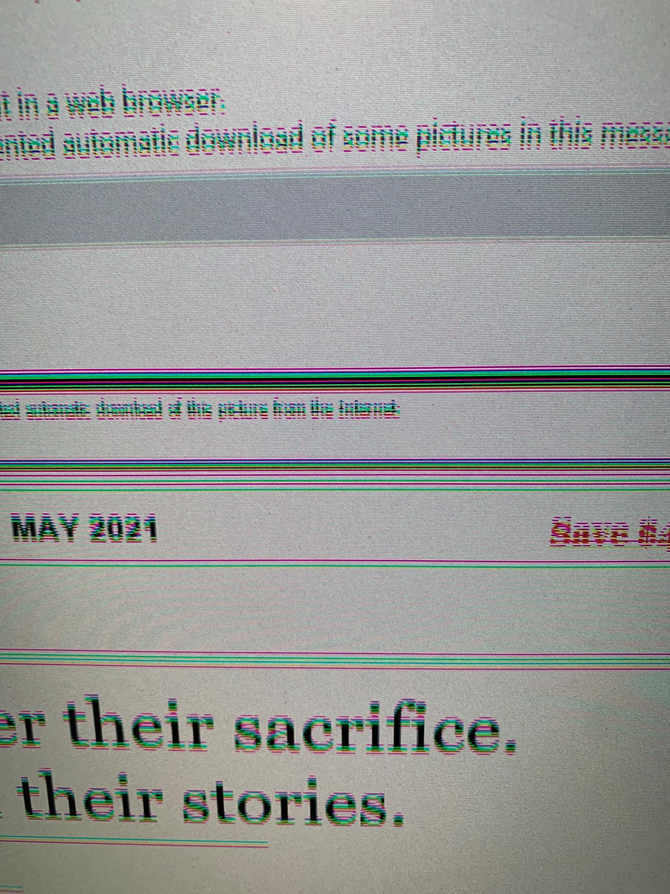

          Re: Dell 3008WFP Monitor Intermittent Text Shadowing
          The problem just happened again this morning. Here are pictures of the screen with the problem and after I turn it off and then on again.
              Remove LVDS cable between mainboard and Tcon, spray contact cleaner, plug it back in and give it a bit of a wiggle. Should fix your problem.

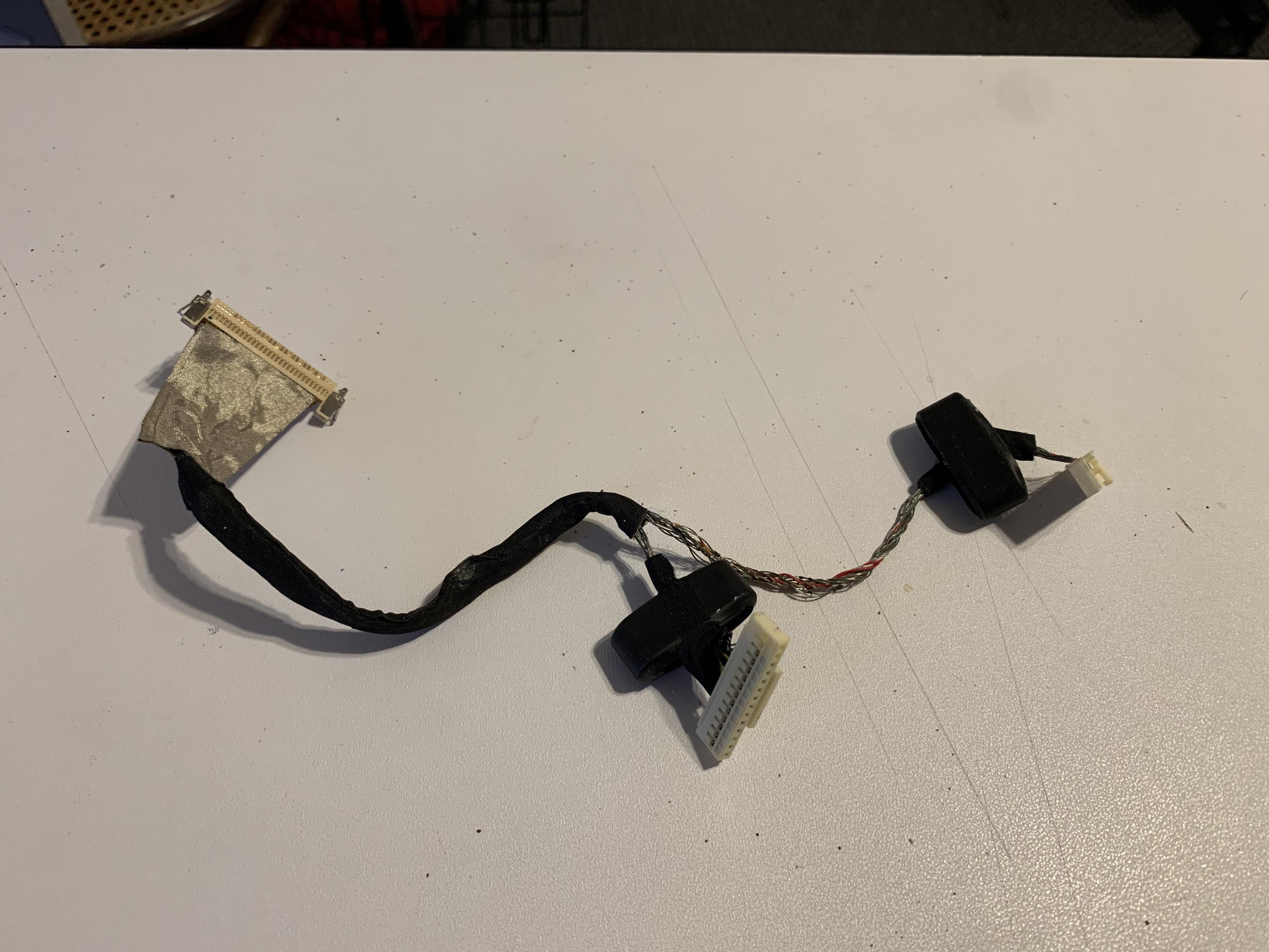

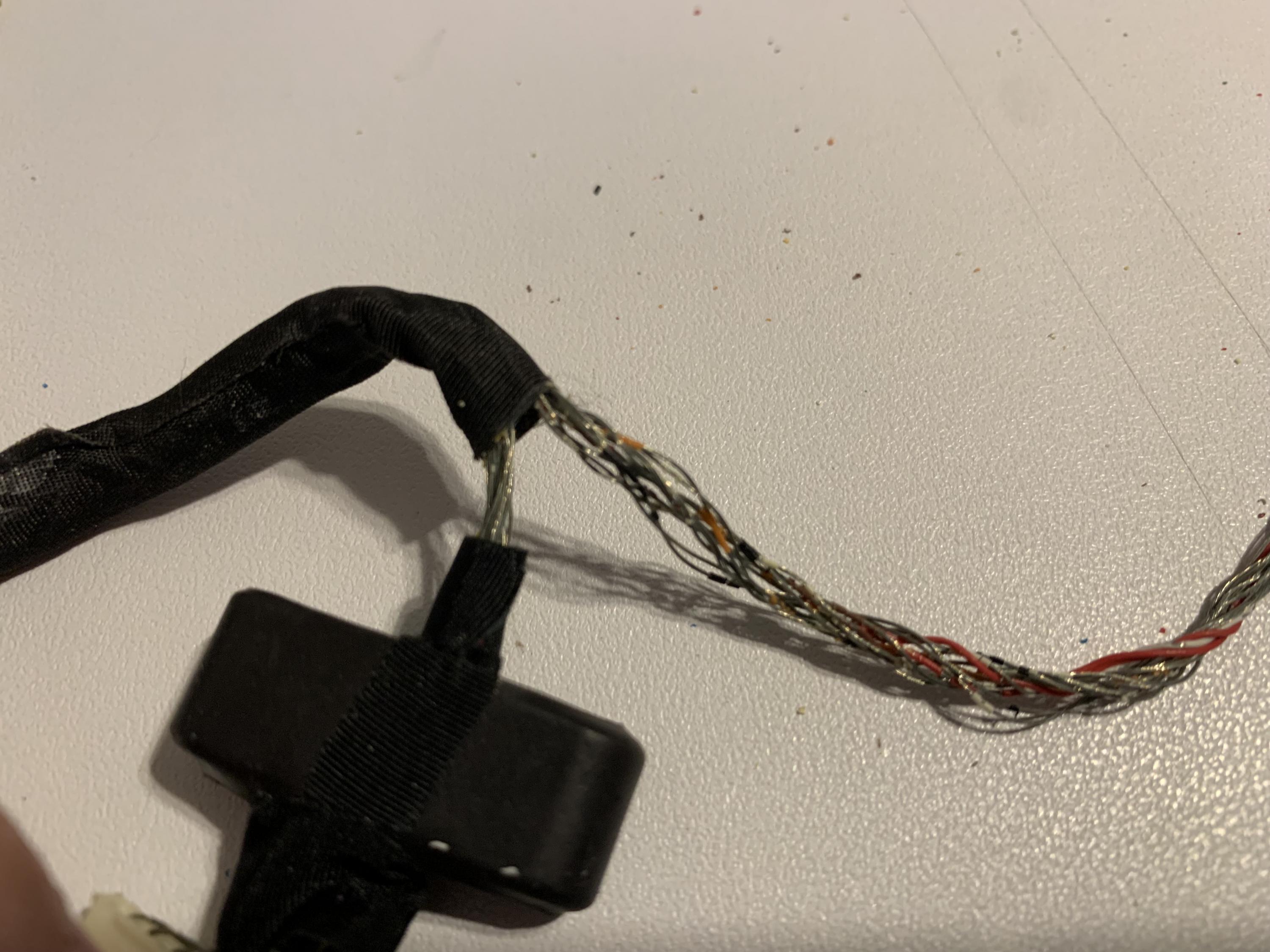

                            I reopened the case and removed the T-Con to Main PCB cable. It is definitely the problem. The wire coating is turning to powder and coming off allowing adjacent wires to short. Is there any way to get a replacement?
                            • Th3_uN1Qu3
                              Believe in
                              • Jul 2010
                              • 6031
                              • Romania
                              Ouch. Looks like the cable equivalent of the infamous brown glue. Check ebay. If you can't find it there, I'm sad to announce you're gonna have to stitch it together yourself. Not the hardest thing to do but definitely tedious and time-consuming. Will probably lead to a few new grey hairs.
