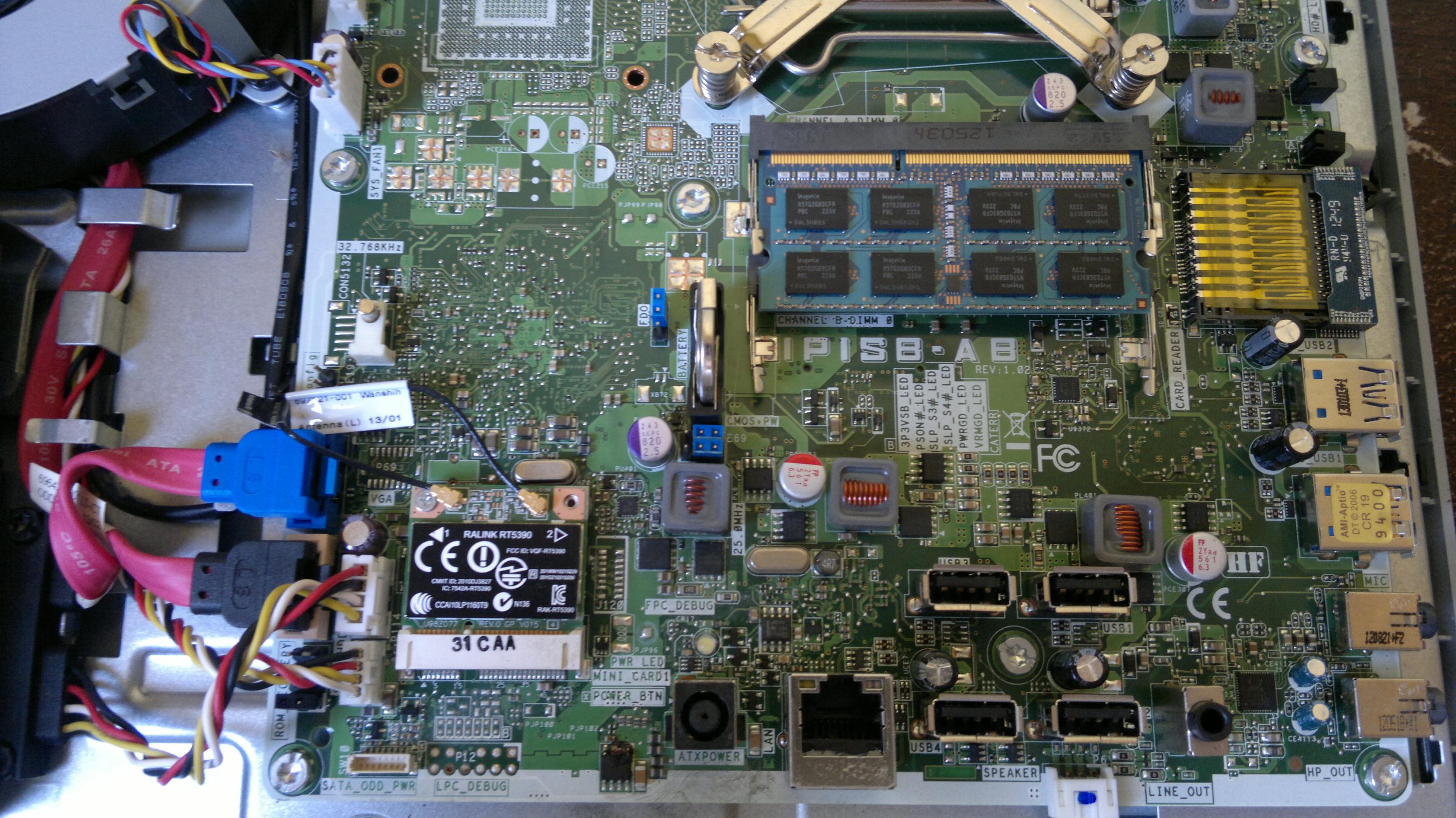

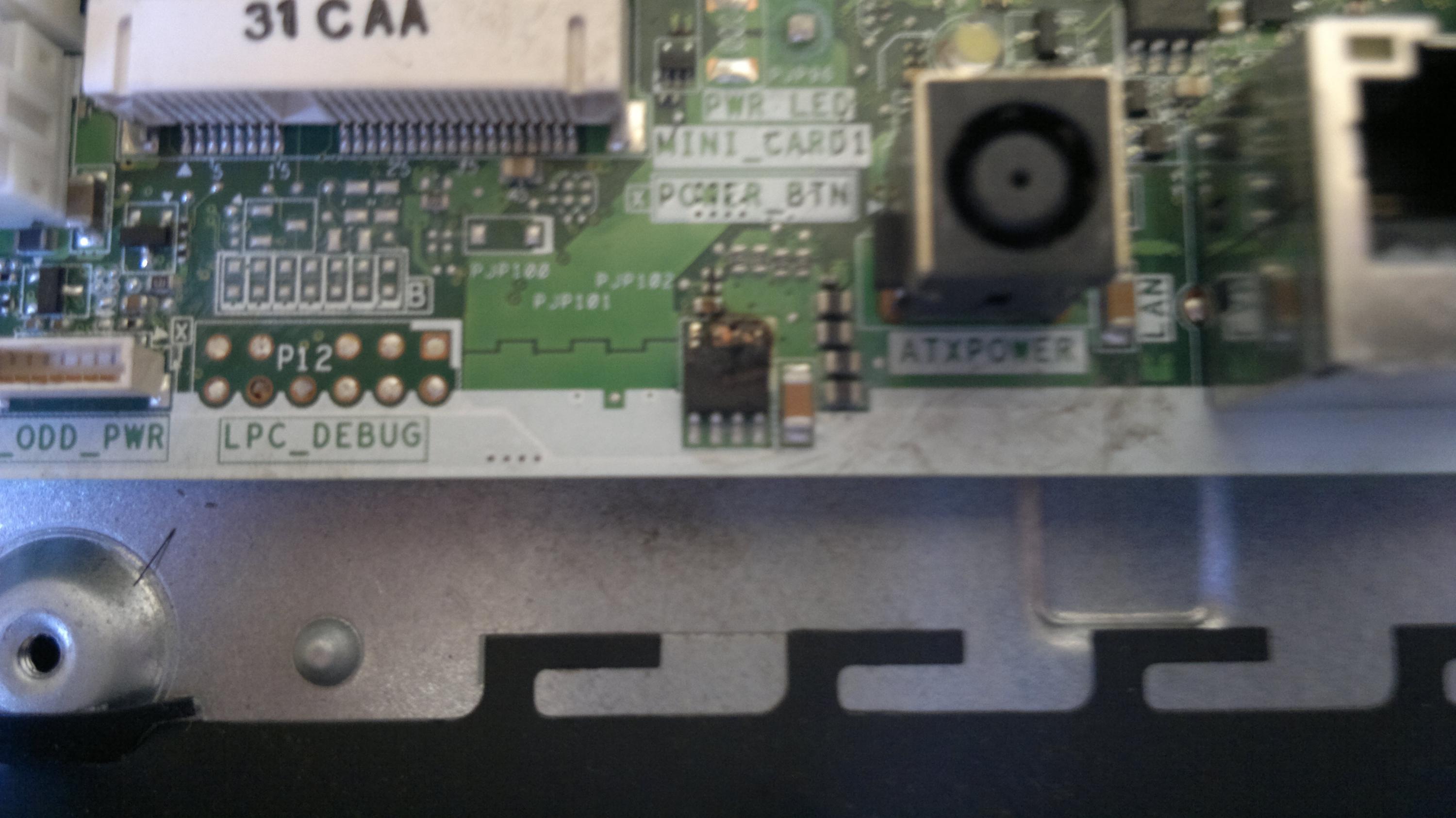

    Hi everybody, I have a problem with an All-in-one computer motherboard yesterday I opened my Pavilion 20 and found something, some simple but sad, a single piece was burned I think due to a overcharged.
    The main problem to me is the microchip is half burned and only have the legend "44D7A" besides the schematic o diagram is not on web, I searched the motherboard model IPISB-AB and only founded some pictures.
    Some could help me whith!?

    Judging by the apparent pinout, and the proximity to the power input, i'm willing to bet it's some P-channel MOSFET.
    The "44D7A" is more likely "4407A", which would indicate it's one of these:
    Before replacing it though, it would be best to try to track down WHY it failed - just replacing it might blow something (more), "downstream".

      Thanks a lot, this data is very usefull, I am going to replace it and check out all motherboard before turn on the laptop
        Re: microchip burned of motherboard IPISB-AB
        After you remove it, check for shorts on both sides.

          Dont forget to check your power adapter too if its faulty or supplying over voltage or its short to burn the chip. As khron666 said, check all other possibilities before changing the chip to test.

              4407A OK:novato:
