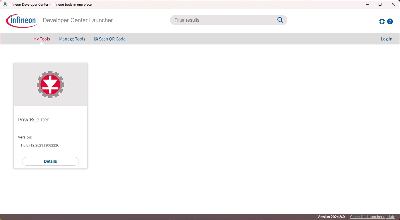

              I use the official version from Infineon.
              Register @ Infineon, download the Infineon Development Center Launcher, and inside the Launcher PowIRCenter.
              If you need hidden functions you can login with one of these logins:
              1ASUS1, HPONLY, LENOVO, DELLONLY, SONYONLY, MITAC, ARISTA, M2, IR3570A, R1BPATCH, FAE, MOUNTAIN, POWERUSER, TERMINATOR, FATOOL
              Click image for larger version  Name:	Development Center Launcher.jpg Views:	4 Size:	96.2 KB ID:	3530565
              More under:
              https://vlab-su.translate.goog/viewt...pl&_x_tr_hl=pl
              Change translation to our language.
              And should you despite that need a key:
              https://t.me/firmwarepwm/7522
              Use it better on a temporary VM Machine, or a temporary Windows machine.

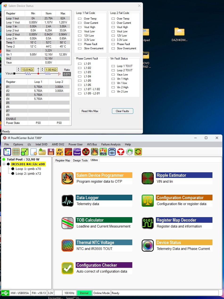

                    On the Motherboard VU1(ir35201)
                    Connect SDA to the VC13 (pin 24 of the ir35201)
                    Connect SCL to the VC11 (pin 25 of the ir35201)
                    GND to any ground pin
                    Connect the PSU 24pin and the cpu power pins
                    Turn on the board
                    OpenPower Gui or IR PowIRCenter
                    Auto populate
                    Scan Full Address Range
                    Click on the card on the left
                    Click on the multi device programmer button (flame)
                    Click on select configuration and select the file "IR35201_MSI_MS-7C37_AMD_X570_8n2_RevA_AC_2019-01-15.txt"
                    Then check the trim and user boxes
                    Click on Program and Verify
                    With a little luck everything passes
                    • smic717394
                      • Jun 2017
                      • 95
                      • Spain
                      #30
                      Hi, I got the board running, thank you for the firmware. I´m now installing windows, how Do I test if all the cpu phases work fine? I runned OCCT CPU and then Limpack few times about 2 hours, so far no fire I tested with a Ryzen 1200. Should I up the game and put my Ryzen 7 5800X3D in?​
