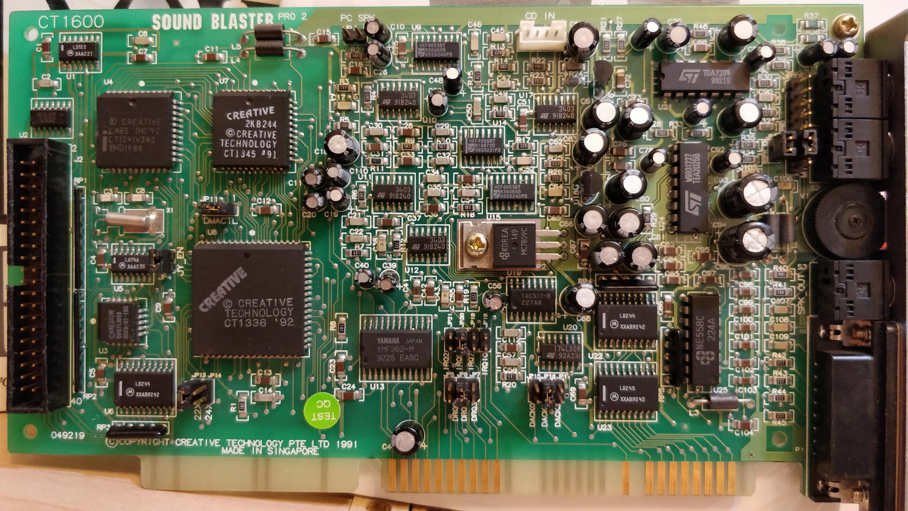

                                  I'm new here and a little late for the party....
                                  I just got a SB Pro 2 (CT-1600) and was thinking about replacing it's caps to build a 486 PC in the (near?) future. I can't test if it works right now and how bad it could sound, anyway would like to start getting the caps I need..
                                  I may be able to read the caps labels myself but maybe someone has a list of all the caps needed? What brand to get? any schematics around?
                                  I'm exited about this project, what I had back in the day was a Pro Audio Spectrum 16, (which served me well) and now, 30 some years latter I got my hands on one of this....
                                  I'm handy soldering stuff so don't worry this isn't new to me.
                                  I'll make sure I test it before and after of course....
                                  Thanks in advance, I hope someone reads this lol,
                                  Dusko.

                                        Re: SoundBlaster Pro 2.0 recapping
                                        Hi and thanks for your reply,
                                        my idea is to make this card sound the best it can, I'm aware it's an old technology and by no means is hi-tech, (it was basically for video games). I want to make sure that it doesn't lack any frequencies due to bad caps. I didn't do a lot of research yet but it looks like Japanese (Rubycon) caps are among the best, and easy to find on e-bay.
                                        Please feel free to correct me if I'm wrong or if you have any ideas, that's why I came here for.
                                        Also, here is a picture of it,
                                        Thanks for your time!
                                        Dusko.
