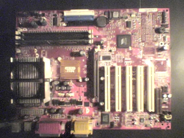

    Hello all...
    I got a problem here with a K7T266 Pro ver2.0 board.
    This pc has run great for months...no freezing... no restarting...
    No signs of anything going out.
    Anyway.. I restarted the pc, cause it has been running for a while as usuall.
    and I wanted a fresh boot. and now it does NOTHING!
    and no I didn't change anything..
    (1) The Monitor does not kick on at all.
    (2) Hard drive light does not light up. (so its nothing that's on the drive.)
    All Fans come on, cd drive lights up.
    The floppy does not light up.
    If I unhook the cd drives power.. the harddrive red light will just stay on.

    What would be very helpful is a picture of your motherboard or a list of capacitors that are currently on your board. If the capacitors are known bad brands, then it is highly likely that this is the cause for your misery.
    Best of luck!

      Ok, Here are the brands that I see on the board.
      () KZG
      () Rubycon
      () G-Luxon
      () Teapo (Its probably this one.. for it rimes with cheap-o. lol)

        Here's one pic, although not very good.. can't see the cap conditions.
        I'll have to get out the webcam later, it takes better pics than the sony clie.

            Yes that picture is not too great, however it is a start.
            Of the capacitors that you have posted before, G-Luxon and Teapo are known bad brands. I have not heard of KZG capacitors before, however I heard them mentioned in other posts here and there. I do not remember off the top of my head whether they are good or not. Rubycon's are quality capacitors.

              Here is my cap list:
              Teapo: (10 of 'em) 1000uf 6.3v
              G-Luxon (3) 1500uf 6.3v
              Rubycon (8) 2200uf 6.3v
              KZG (3) 1500uf 16v

                                    Re: K7T266 Pro2 help needed. "Died"
                                    [1500uf 6.3V] sub to: (2200uf 16V)
                                    [1500uf 16v] sub to: (2200uf 16v)
                                    These should be fine, however you may find that 16V capacitors will not fit in the tight locations on a motherboard (or at all). When I recapped my motherboard, my biggest issue was not the rating but getting ones that will fit!
                                    Make sure you measure the diameter of your current capacitors before you buy new ones. You do not want capacitors that will not fit!
                                    Also make sure you get proper Low ESR capacitors, check out the FAQ section on this forum as to which capacitors are good and which are bad or just ask the question in this thread.
                                    If the processor is bad, I would say that the PC would not boot at all! However that has been with all the cases that I dealt with, I am not sure if it is possible to have a sort of working yet not working processor. However I know for sure that this can happen with memory!
                                    I am unsure whether memtest would fail if there was something else wrong on the board. Memtest fully tests memory, if memtest is failing it's tests, then your memory is not working right. Therefore I guess your memory may be not working because it is faulty or something is not right with your motherboard.
                                    However it is essentially a guess at this stage. All you know is that your memory is not working right. You do not know the cause or why it is not working right.
                                      Thanks for the cap info... It has plenty of room for any 1500uf size.
                                      Yeah, I wasn't sure about the memtest either...i figured it would fail even if the ram is good or bad. I just wanted to see if it would actually run the memtest. and it did. booted it right off the cd... and ran good. besides that it was failing all the ram test. Kinda sounds like bad ram after that. but i guess it could also be a bad cap not supplying enough power for the ram slots.
                                      A bad cap near the ram, bad ram, or both? huh huh..
                                      * Anyone here with a bad cap board,that can try memtest? LOL
                                      I'm gonna look in my internet pc[one im using now], and see if it also uses ddr ram. That way if I go buy ram and it don't fix it, I can add it to this pc.
                                      I kinda wanna turn this pc off, snag the ram out of it, and check the other pc... But the way my luck has been lately, the other pc would damage my ram, and I'd be s.o.l. So I'm not gonna try that just yet... huh huh...
                                      Thanks for the help shadow and all.
                                        Memtest can't really isolate which component caused an error. It just knows that it didn't read back the values from memory that it expected to find there. This will easily happen with an unstable motherboard or processor, just as easily as it can happen with bad ram. I've had it happen for any of those reasons.
