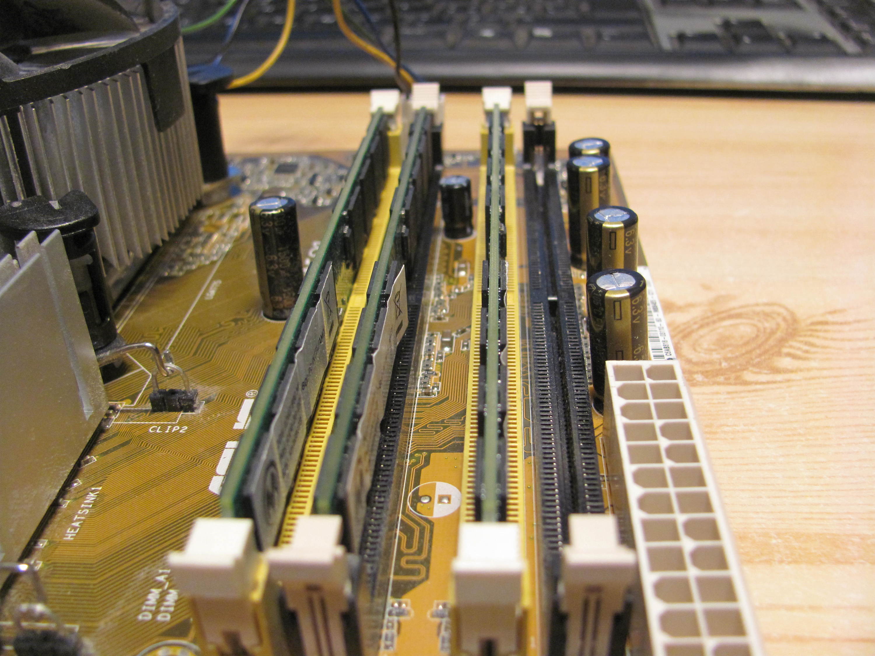

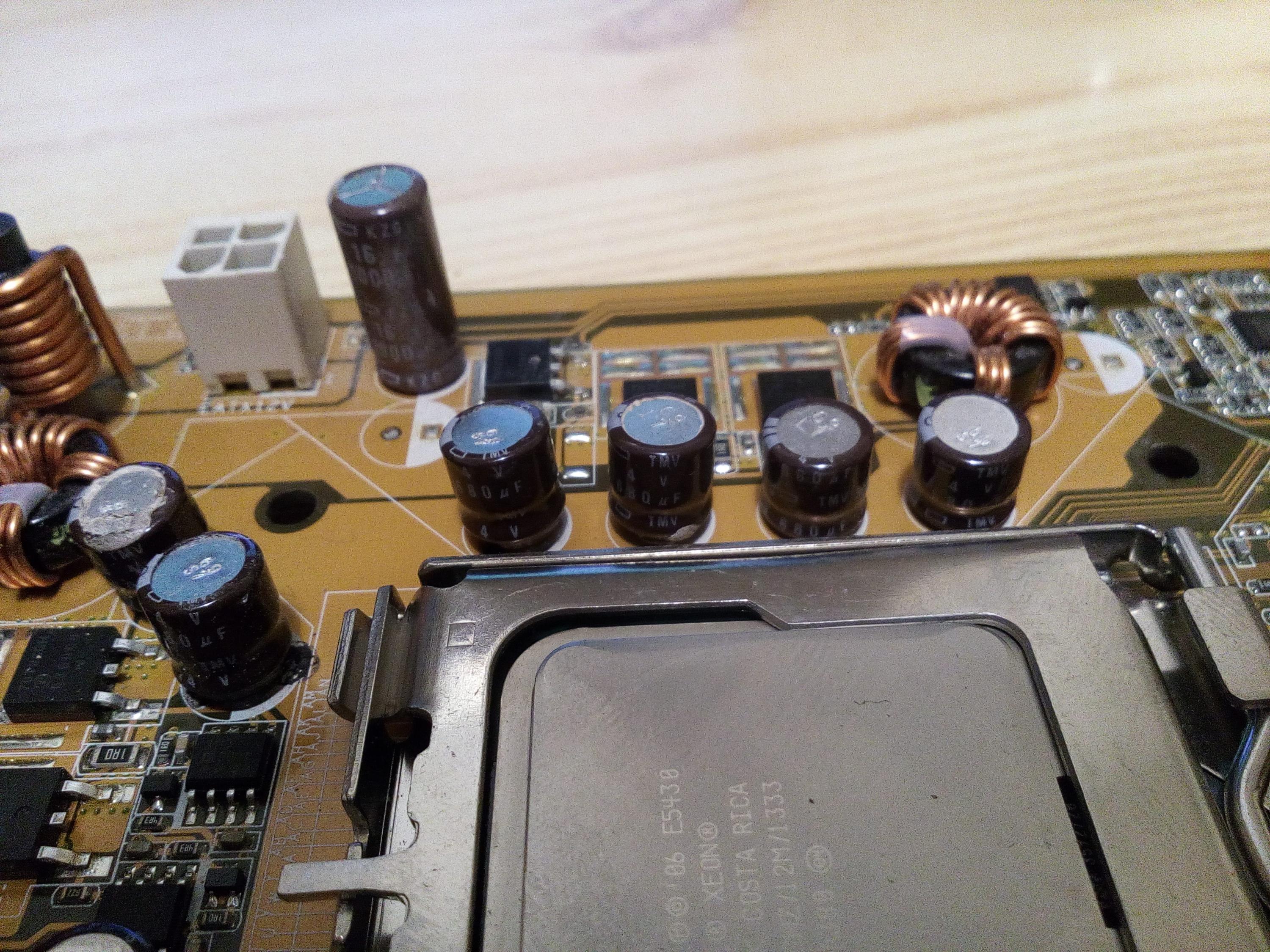

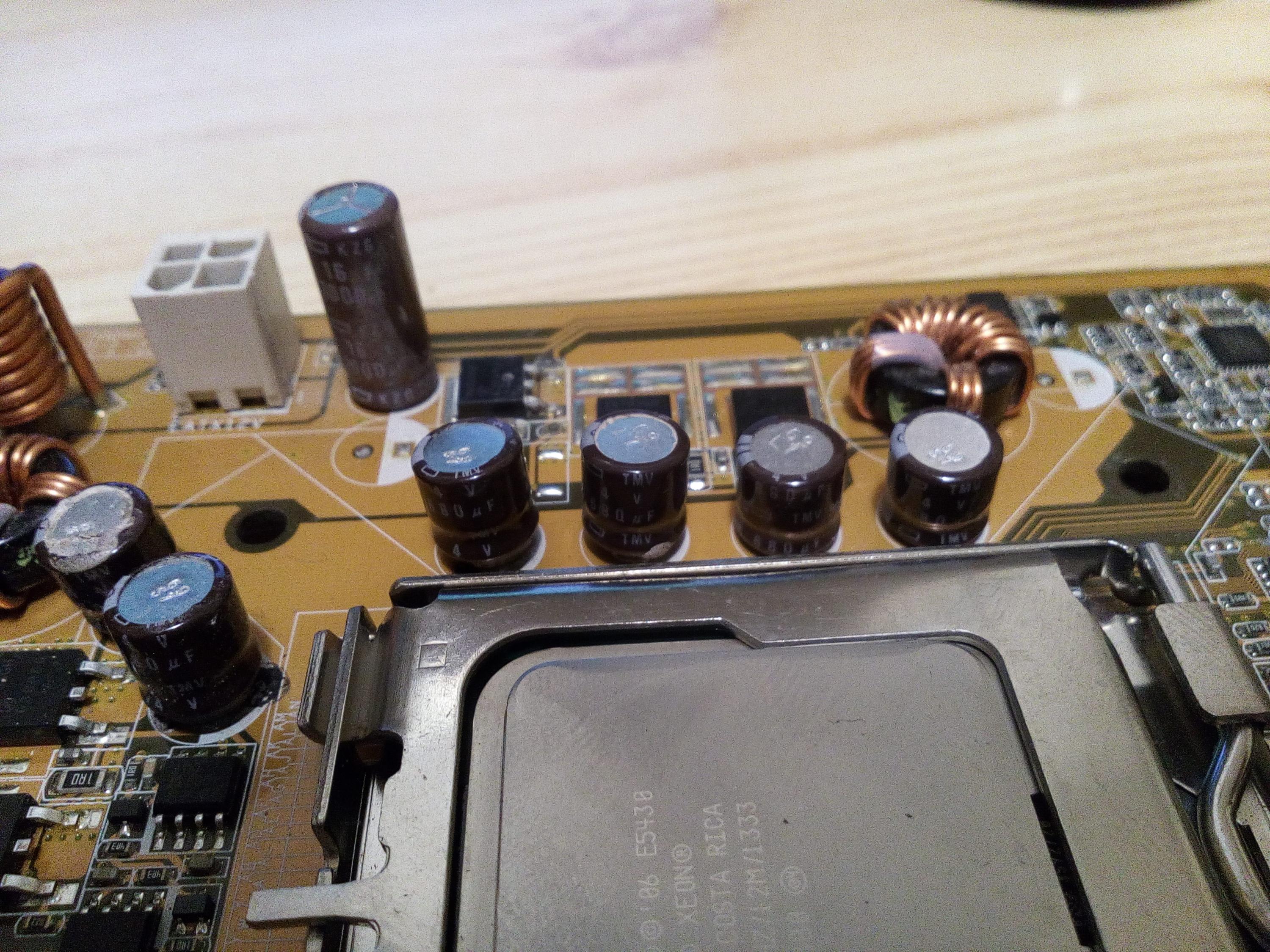

    I was doing the 771 mod on one of my computers (with Asus P5B) and when I took the heatsink off, I found the caps around the socket to be leaking. They are TMV 4V 680uF, which, I guess, are used on vrm output. I will need to replace them, but I haven't been able to find the datasheet for them.
    I would like to replace them polymer, because I think are better and more durable. But when searching for polymers locally, I found them really hard to get in the Czech Republic. I managed to find a place that has X-CON ULR, which seem like quality caps (at least from I was able to find). But I don't know if they are good replacement for TMV.
    I also don't know which capacity to choose. I found somewhere, that when replacing electrolytic with polymer, the capacity should be halved. I'm able to get 330uF 16V, 470uF 6.3V, 560uF 6.3V, 1000uF 6.3V, 1200uF 4V with size that fits the board.
    So my questions: Is it a good idea to replace them with polymers? If so, are X-CON ULR a good replacement? If so, which capacity to choose?

    That's strange, I would expect such a board to have solid polymers already! (Got pics?)
    Anyway the Samxon ULR will work well, but do stay close to the originals capacitance.
    The part about halving only really applies to old boards where quite high capacitance ultra low ESR caps where used.
    So I'd go for the 560uF 6.3v which are within 20% of the originals...

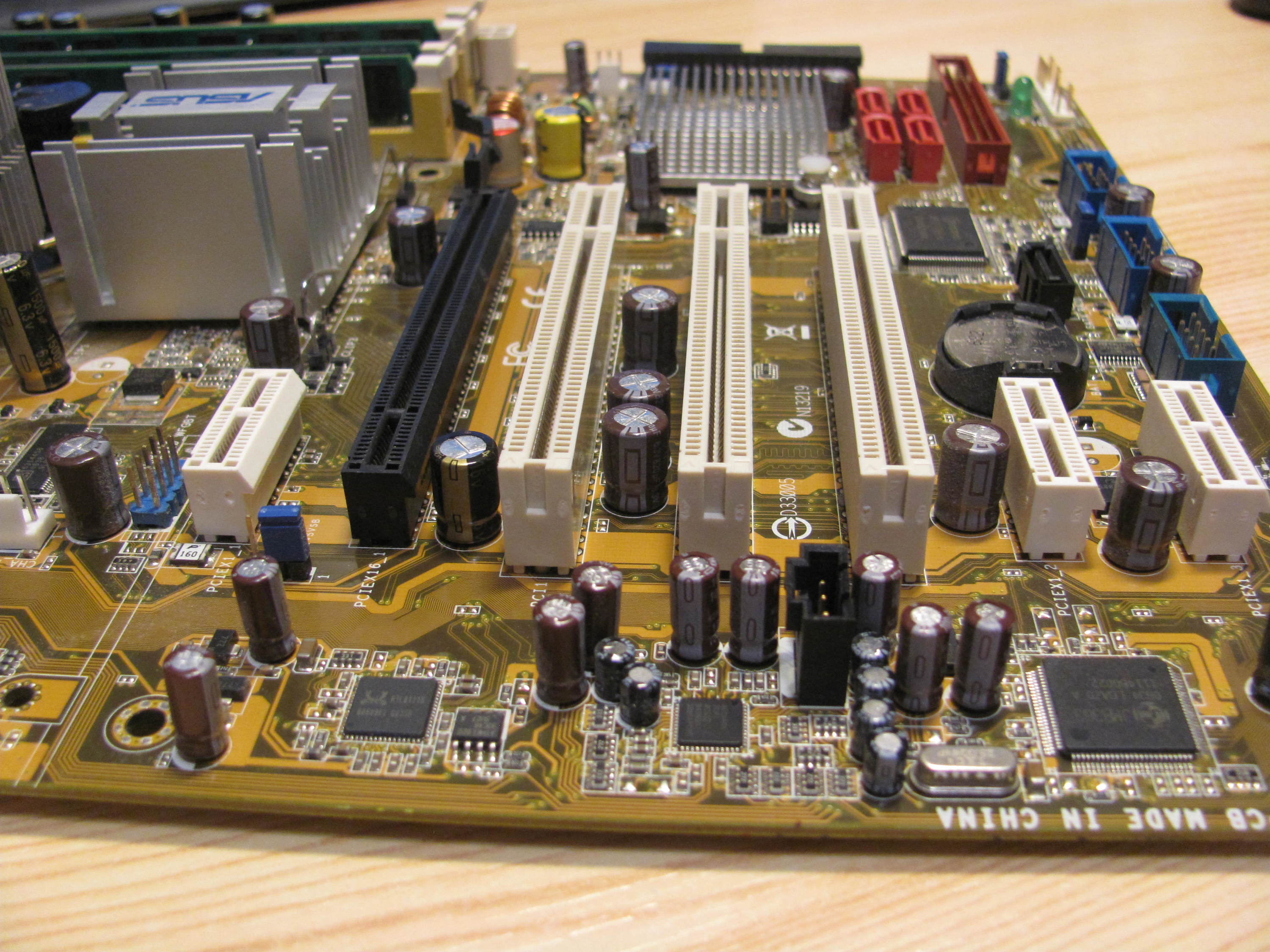

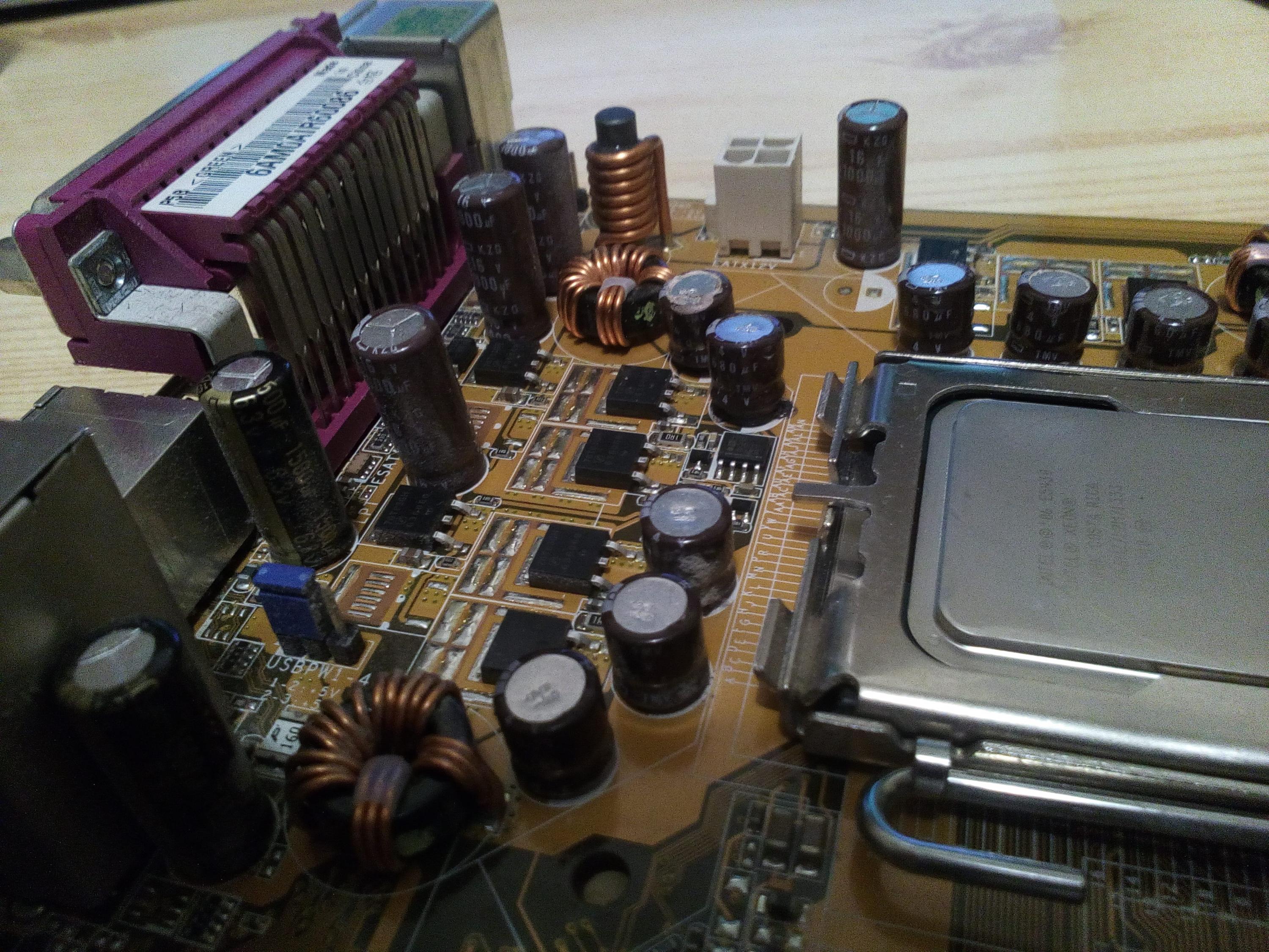

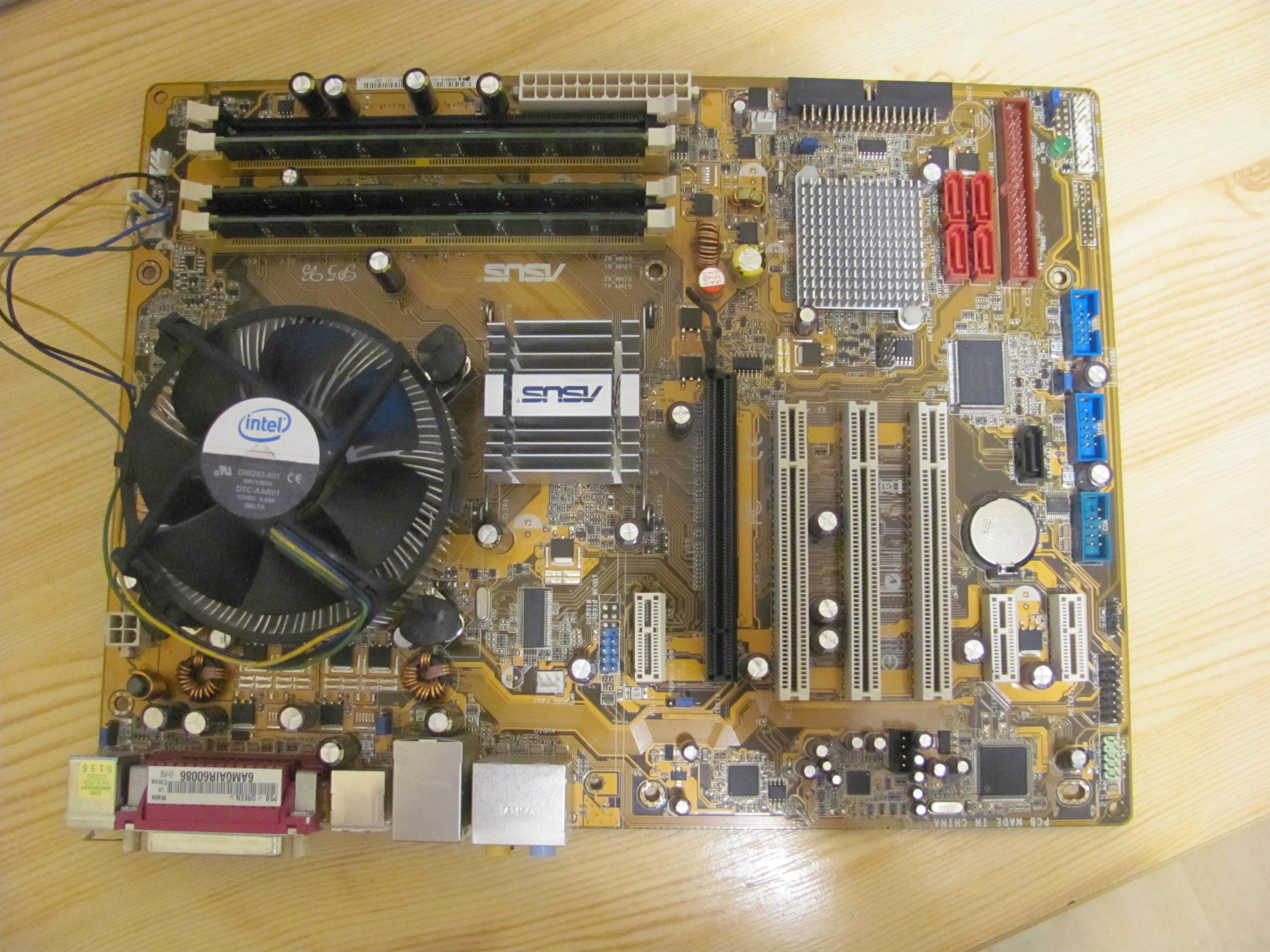

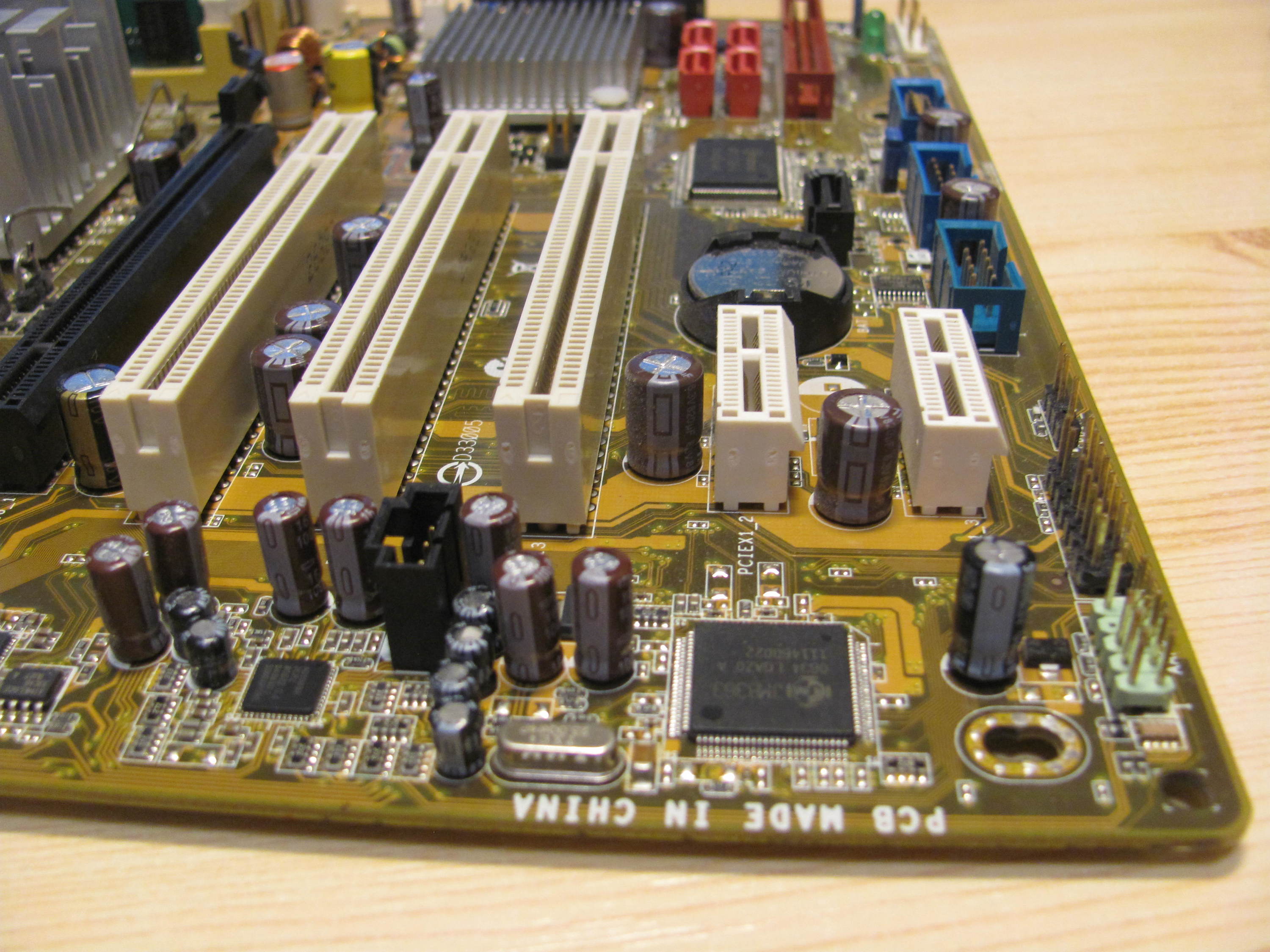

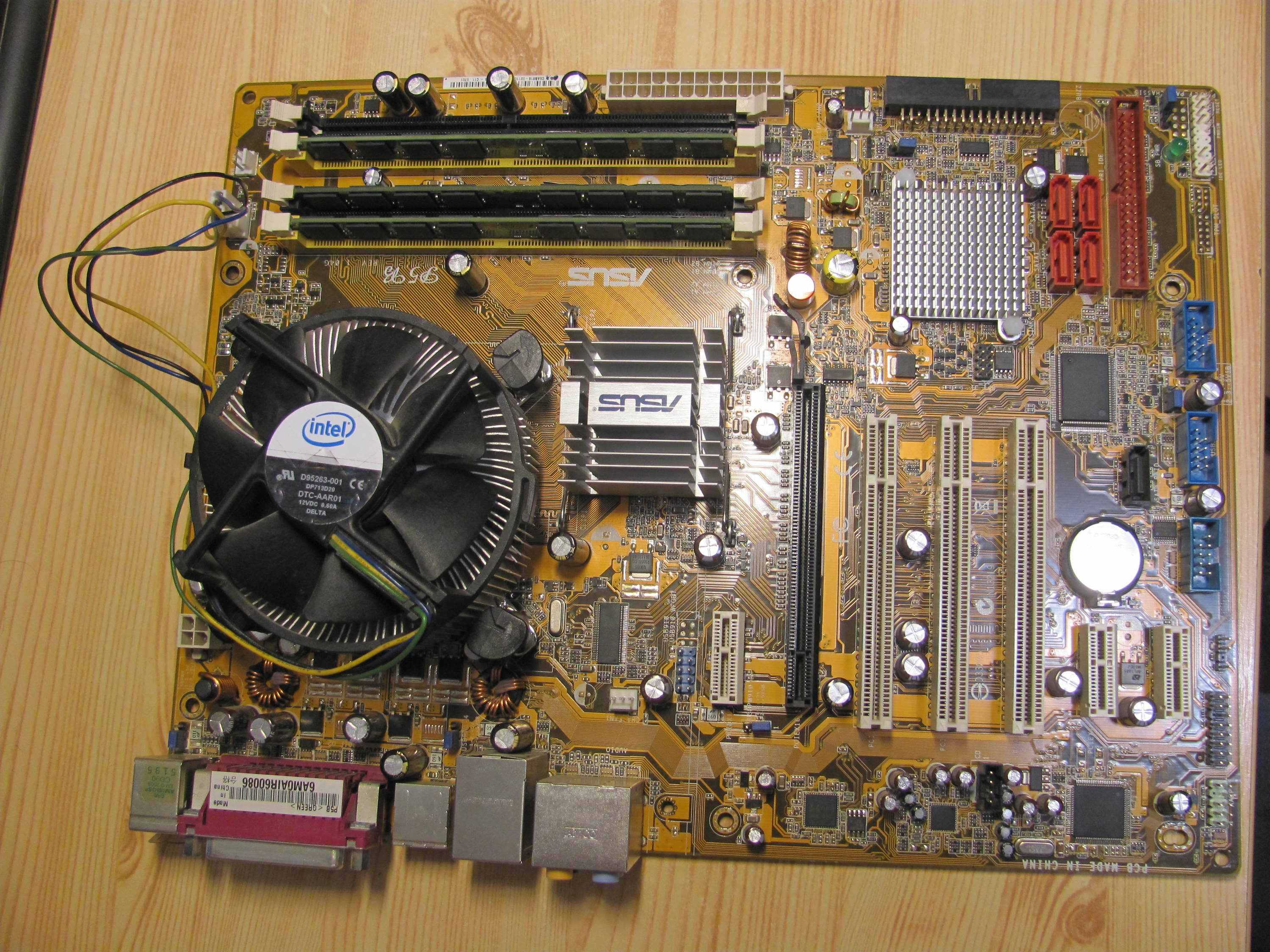

      Thank you for your answer. These are all the photos I took. I haven't taken a photo of the whole board, so I found one on google. The bad caps are the 9 caps around cpu. I can't take more photos right now, because I already assembled the computer back.
      It's quite strange that the computer is running fine, I wouldn't have noticed the caps, if I hadn't disassembled it for the mod. I know that it's probably not a good idea to let it run like this much longer, so I would like to replace the caps as soon as possible.
      So the 560uF caps should be fine?
      I would also like to overclock it a bit (FSB about 400MHz). Could the lower capacitance affect overclocking?

        The 560uF caps should work fine.
        I can't locate a datasheet for your original caps but I'm confident they will have lower ESR, being true solid polymer caps...
        And thus they should allow you to overclock the CPU higher, but not the memory or chipset obviously.
        On that note I noticed you have KZG caps on the board, I'd tell you to change them but on the other hand if the board is working fine maybe leave well enough working...

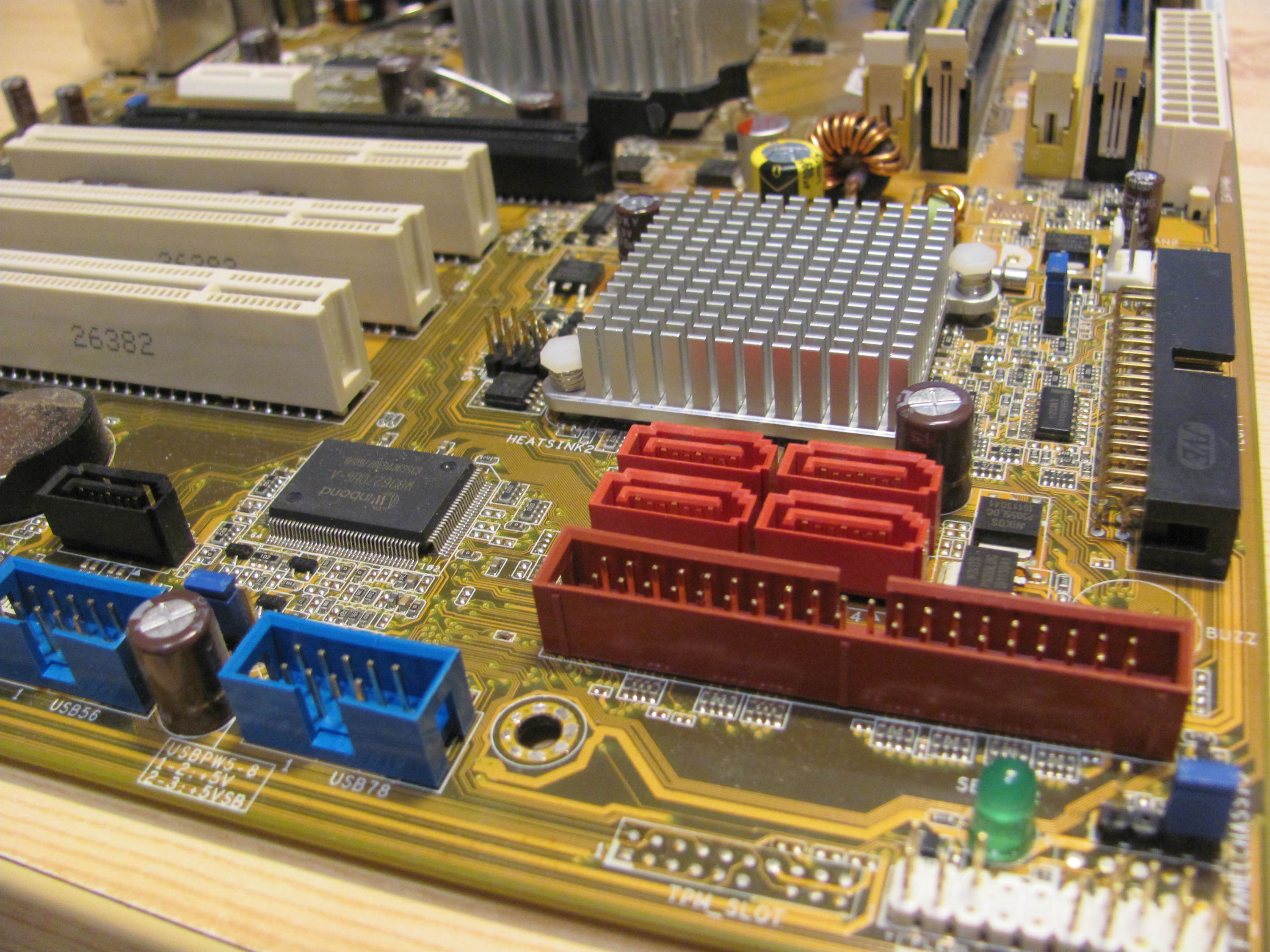

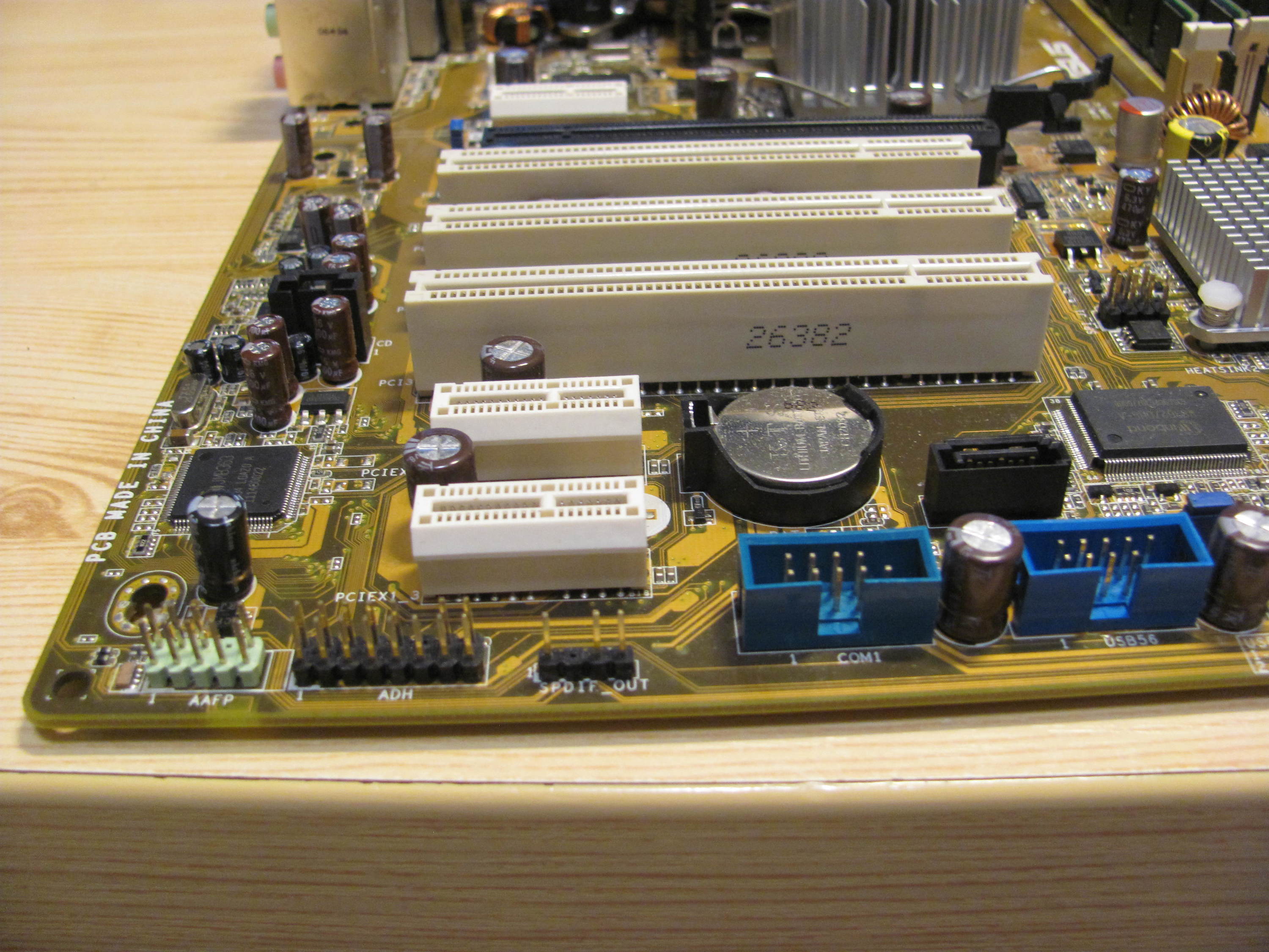

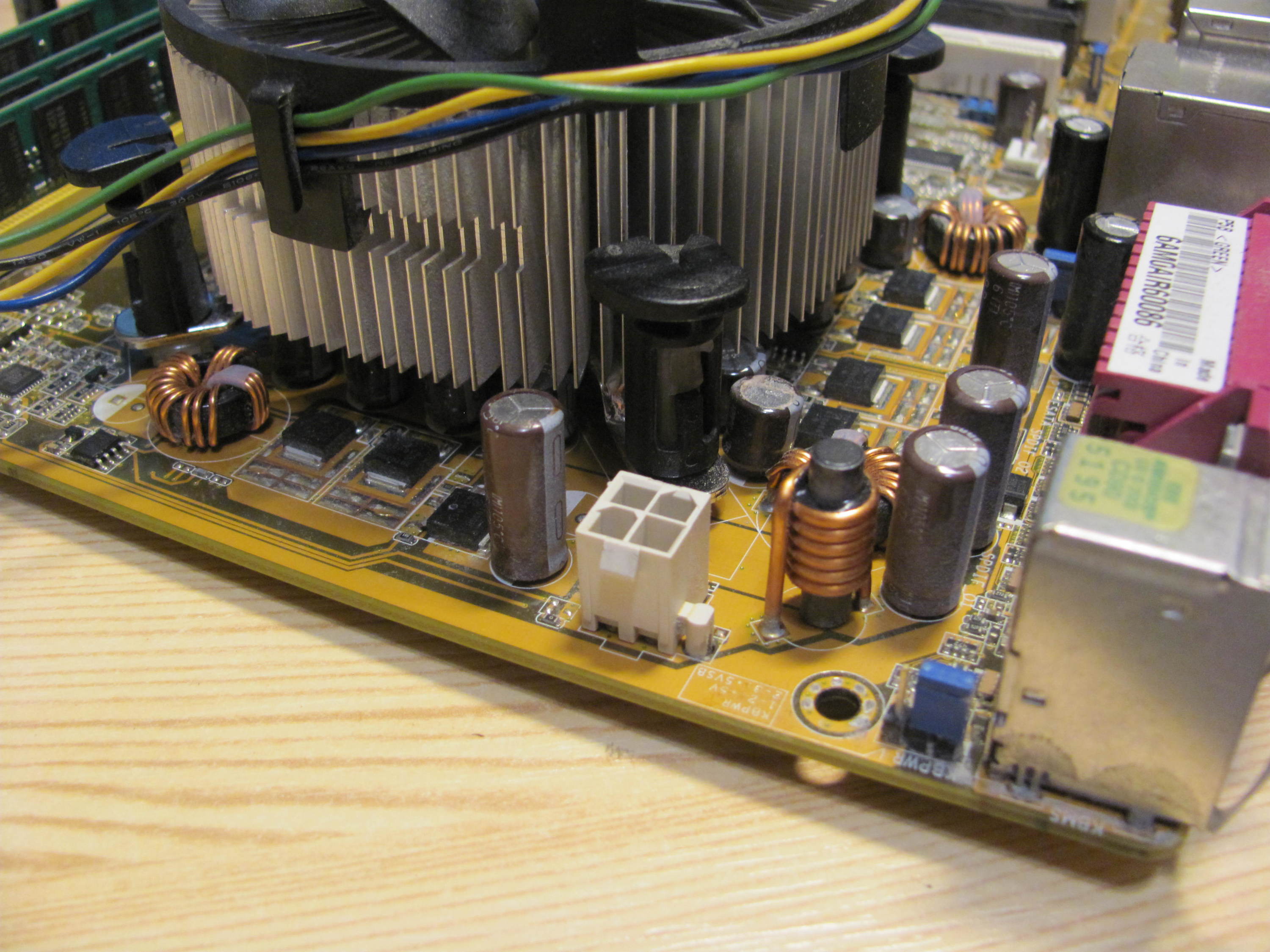

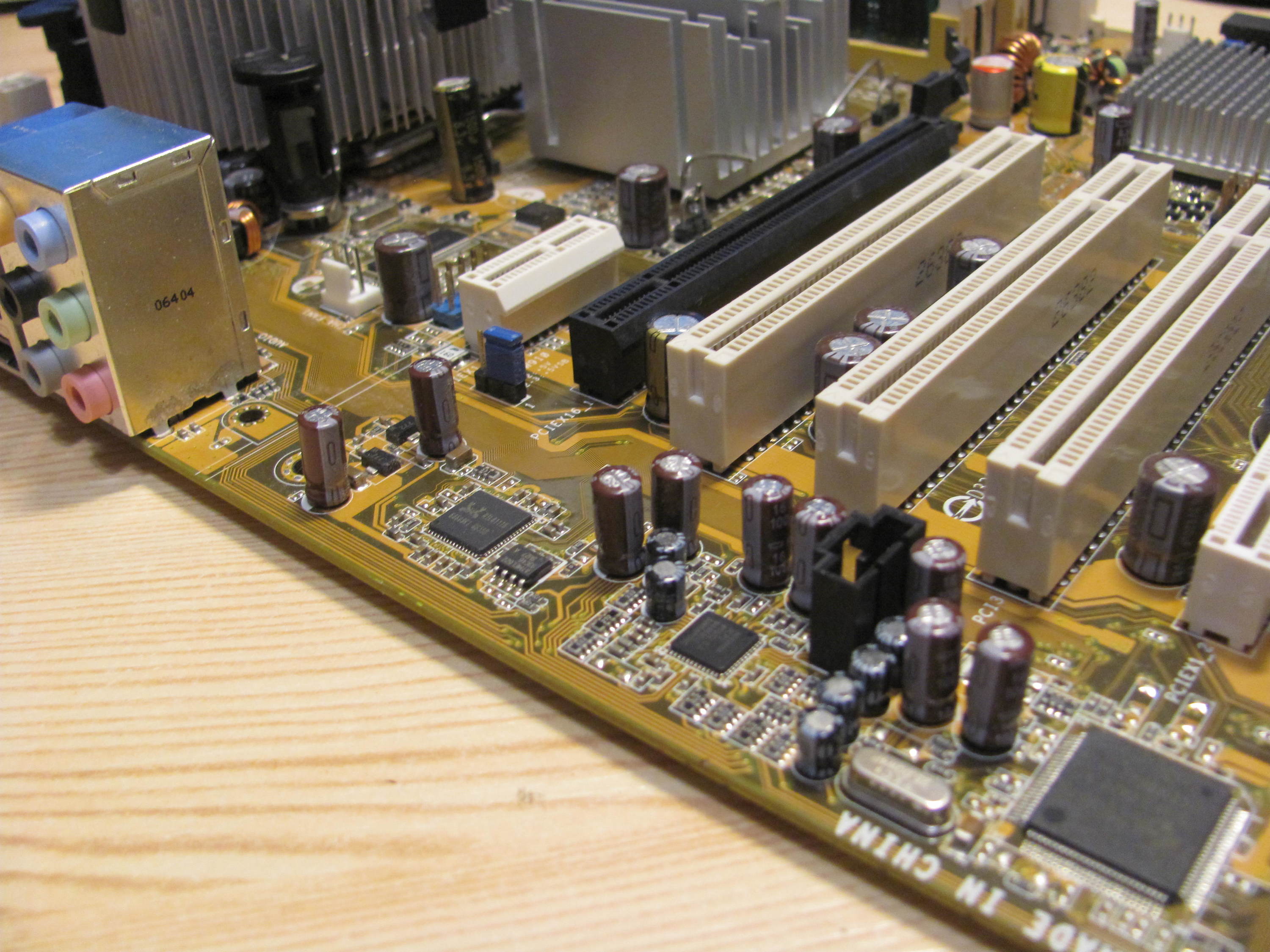

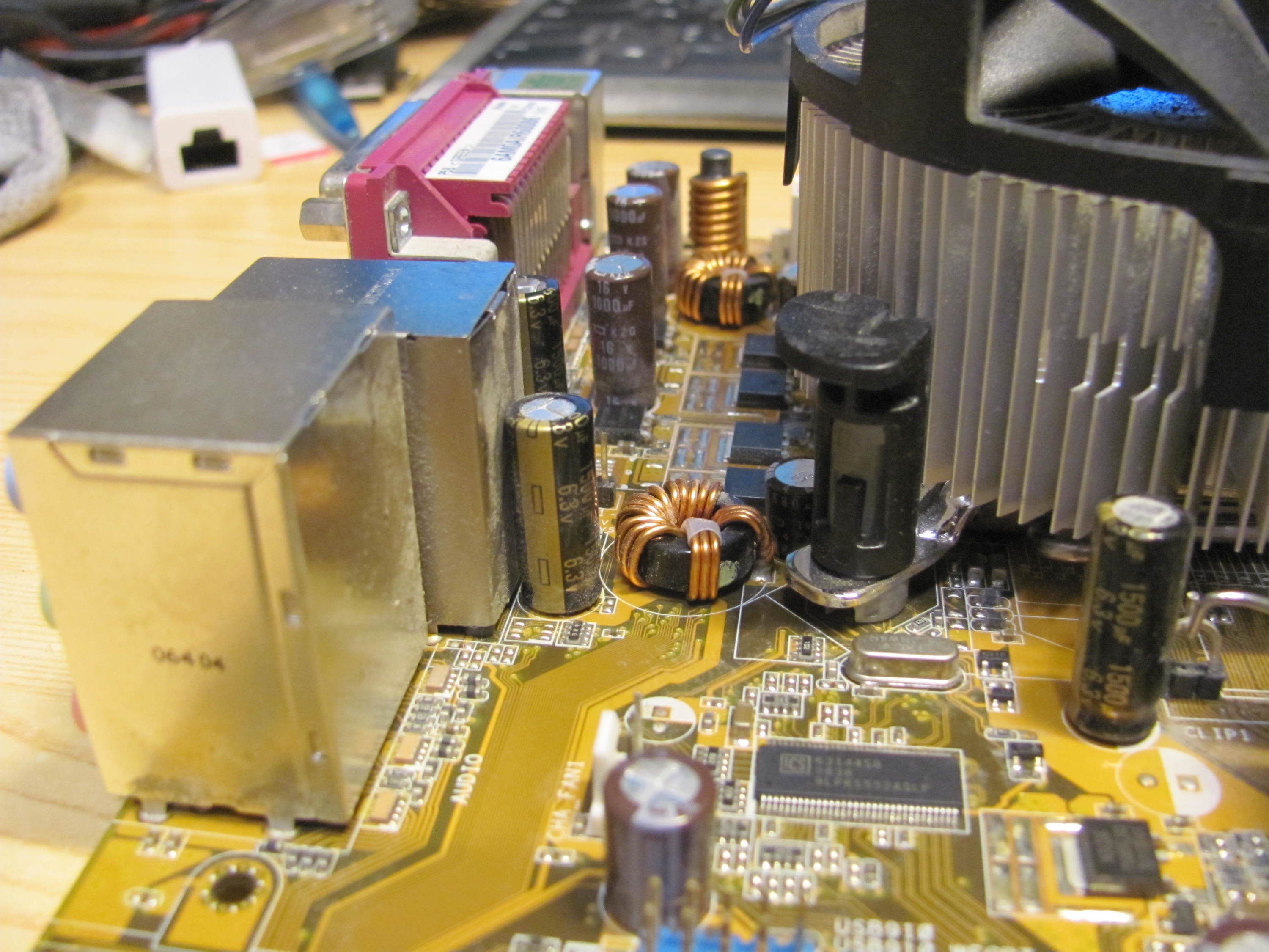

                  So I took the board out to take more pictures and make a list of all caps.
                  4x KZG 1000uF 16V
                  9x TMV 680uF 4V
                  8x FJ 1500uF 6.3V
                  11x TK ATWY 820uF 6.3V
                  1x KY 470uF 6.3V
                  10x KMG 100uF 16V
                  2x HD(M) 330uF 6.3V
                  1x M 6363U 680uF 6.3V
                  1x FJS 470uF 16V
                  Only TVM are leaking, all of the others seems OK. Which of them should I replace?

                      No, it seems that all KZG, at least those produced from 2001 (their inception) to 2008 (I don't recall a report of a failed KZG with 2009 datecodes or later), are prone to failure because the electrolyte is simply unstable. Way too many reported failures, especially in storage, for it to be limited to a bad batch or two. They sometimes last 24/7 because it only takes time for the electrolyte to break down and outgas, and heat only accelerates all failures. I noticed that the OP's board is full of Toshin Kogyo ATWYs - those are also reputed for their unreliability, as are the ATWB series.
                      Chemi-con is considered a good brand. The series to avoid from them are KZG, KZJ, KZV, TMV, and TMJ. The TMV is probably about equal to Nichicon HZ. All those series are out of production anyway, superceded by polymers.

                          470uF is too low when the originals are 680uF. typically on these lga775 polymer cap boards, i've seen them use 560, 680 and 820uF caps for the cpu vrm output. either of these 3 will work. 470uF is too low and may cause inexplicable glitches when using a more power hungry cpu like a quad.

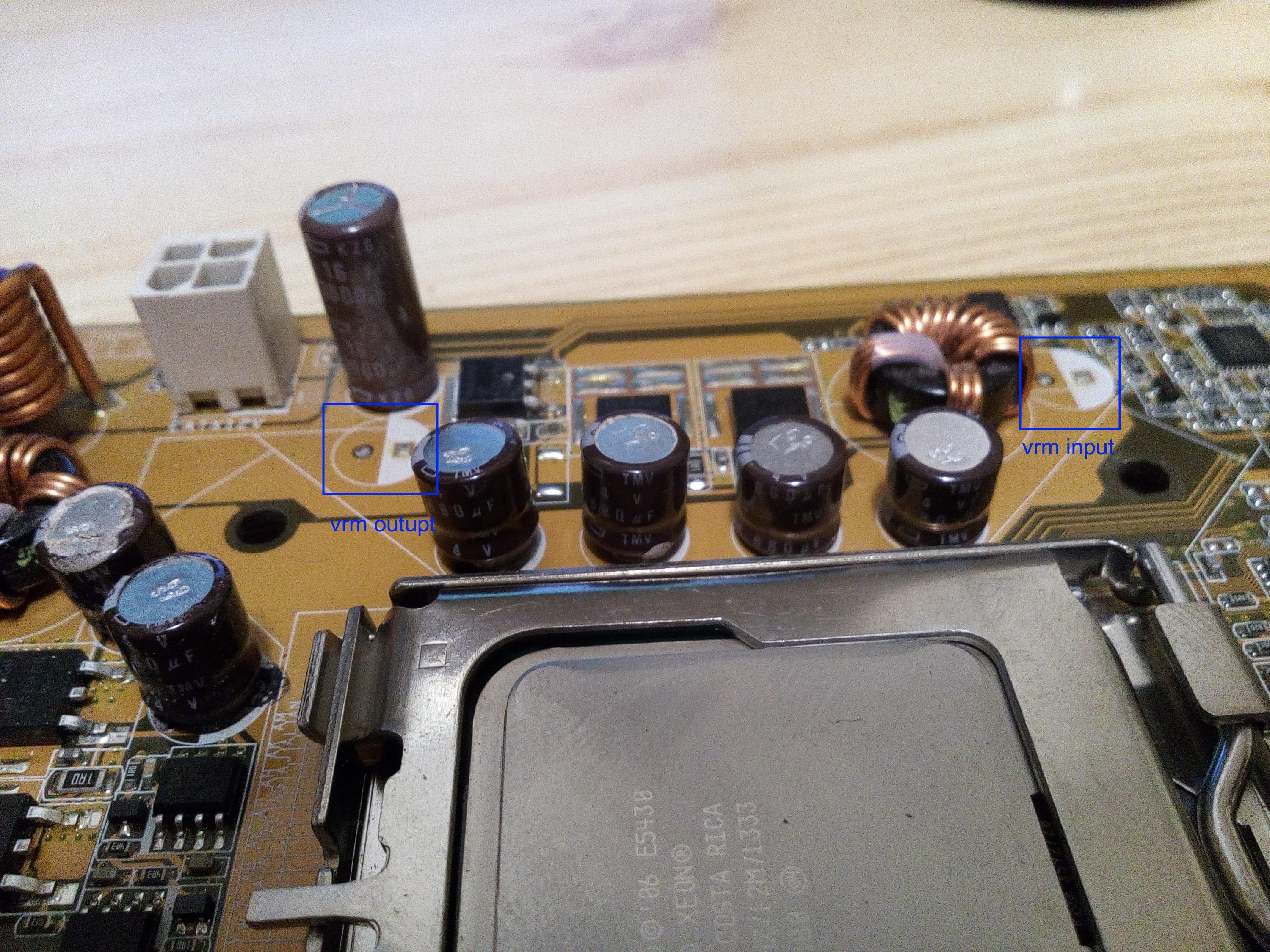

                                Here's what you need to change:
                                4x KZG 1000uF 16V
                                9x TMV 680uF 4V
                                You also have two unpopulated positions on the VRM. The one on top is a 16V, the one on the bottom is VRM low ( 1-5V). You should fill those.
                                Don't leave a CPU in there while you're doing it. It's better to protect the pins with a plastic shield or perhaps a junk old 775 CPU you don't need.
                                470uF might be fine, even for a quad 771 xeon, because they only typically consume 80W (eventhough they're specified at 90-120W).
                                This is especially true if you're using polymers and if you're adding the missing 10th cap. This way, you're only losing 1420uF (6120 - 4700).
                                I've done a few of these boards so far. One was a polymod with 16V 270uF Nichicon LF on the high and 2.5V 820uF FPCAP on the low, and the computer this is being type on was Nichicon HZ 1800uF on the high and some 8x8 polymer on the low.
                                So far yours is the first I'm seeing with TMV. All the one's that have been worked on here so far have had those 8x8 Panasonic FL.
                                I'm attaching the modified BIOS for the Xeon microcodes.
                                BIOS
                                Don't expect too much in terms of FSB control with this board. Its FSB ratio divider isn't exactly something to write home about. You might get a bit frustrated with it, but once you learn how it works, you should be fine.
                                Another tip is to take your time when working with this board. Desoldering and clearing the holes on these boards isn't something that should be done flippantly. Take your time, and if you're finding that the bottom pads are being ripped off (which is not a complete loss because there are pads on the top side as well - albeit they are more difficult to get the lead to adhere to while soldering from the underside of the board), take a break, and pursue your strategy differently.
                                Finally, pay close attention to that "TK" cap near the southbridge heatsink. It's always almost the first one to bloat on this model. Definitely consider using a polymer for that particular one.

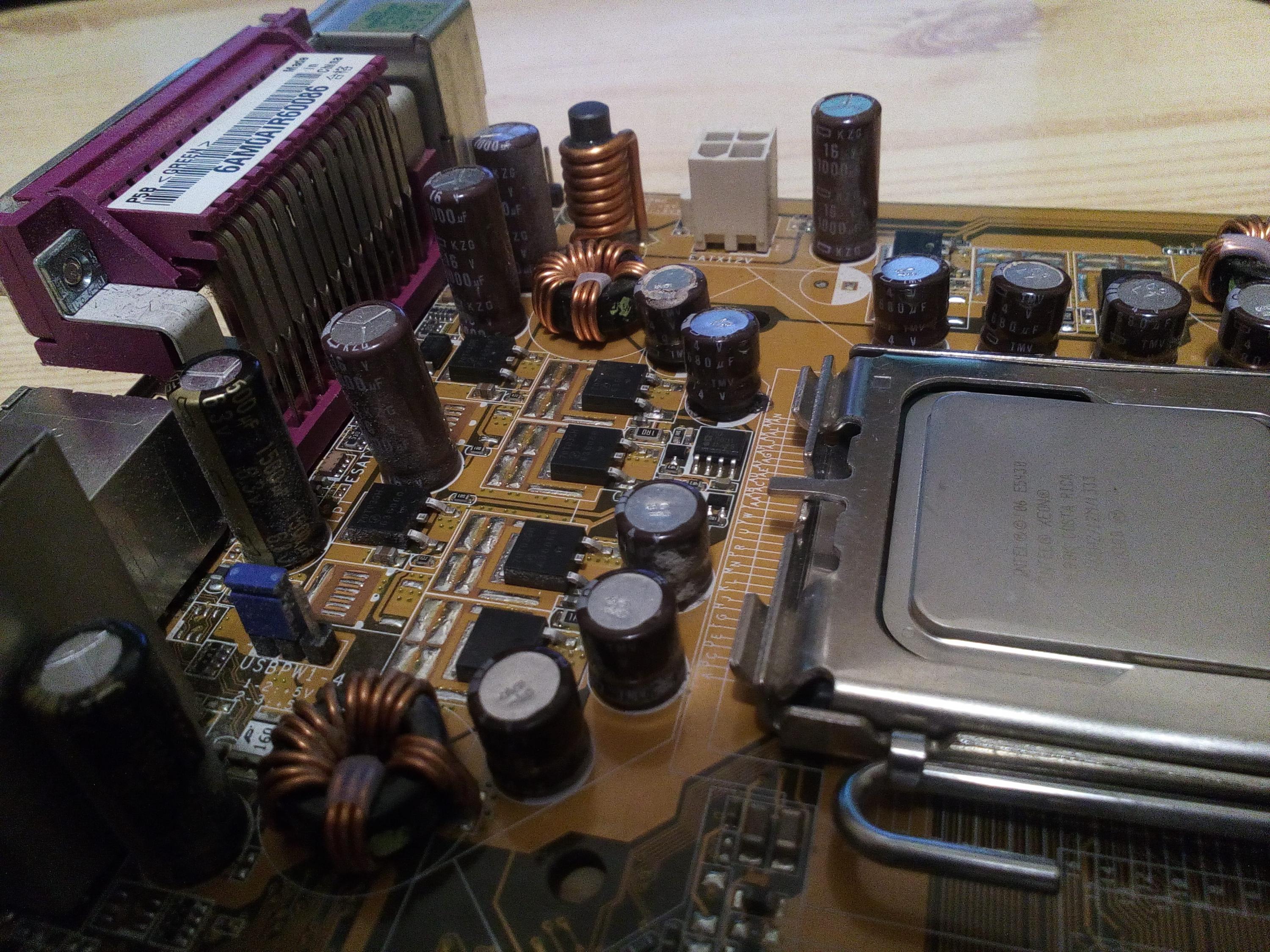

                                    I've decided to replace all the TMV and KZG caps, because they are on the cpu vrm. But I'm not sure about replacing TK ATWY, they all look OK. Do you think that it would increase stability when overclocking?
                                    Should I also replace the KZG with polymers?
                                    I've also remembered I have one broken board lying around. I've checked and found that there are some polymers there that I could reuse. There are ten caps around socket, which I think are 820uF 2.5V, but they are in 6.3x8mm form factor. Do you think that I should try to fit them there? There are also 4 other polymers. I don't know which models they are, but I'm uploading photos of all of them.
                                    I'm not sure what unpopulated positions you mean. I've marked it on the photo. Is that correct?
