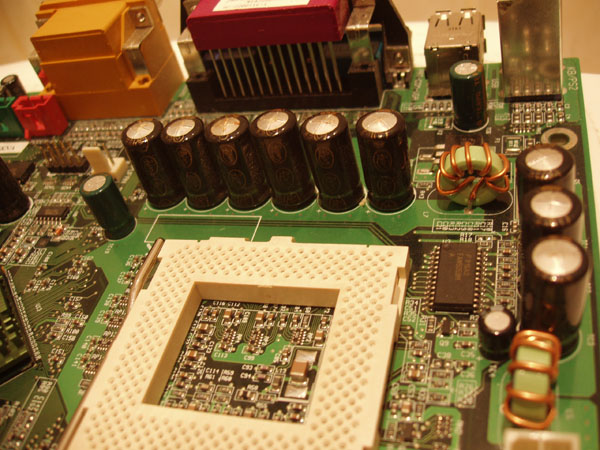

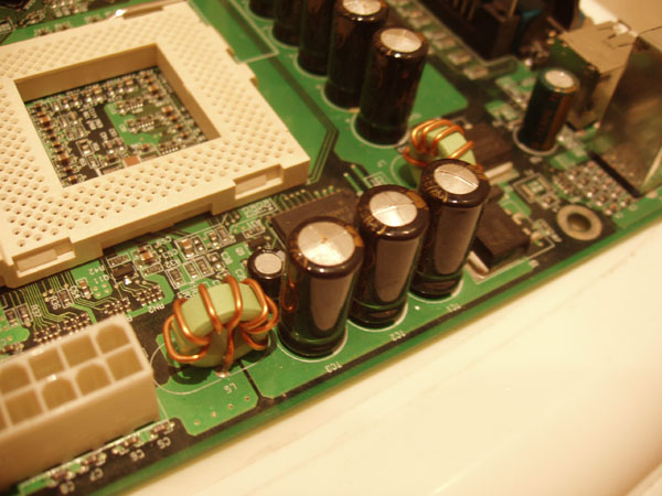

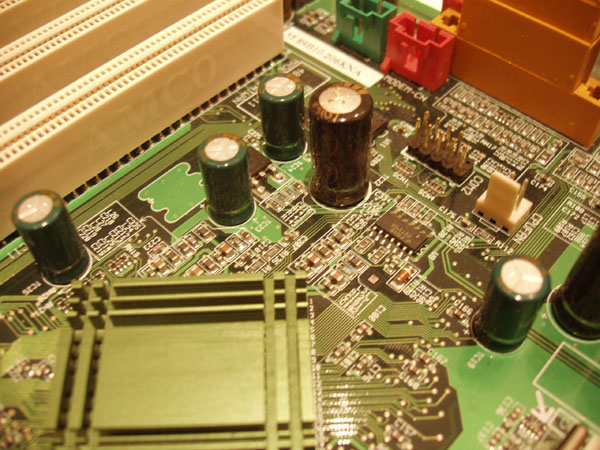

    Aopen MX36LE
    This is already the second MX36LE I am recapping (the other one has been working flawlwssly over a year now). All the caps 1000 uF or greater were bulging, the 1000uF have already been replaced on the photos, 1500 uF Lelons are waiting to be replaced (I guess I will use a smaller amount of 2200 uF caps for economical reasons).

    replaced the 1000s with teapo?

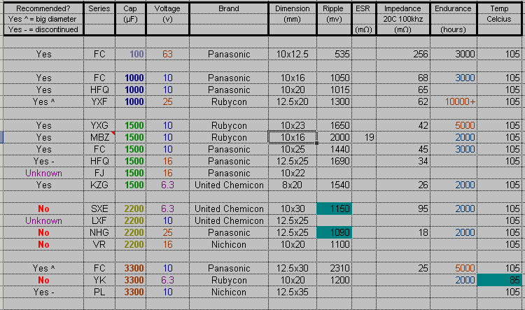

      oh my oh my... it's not a good idea to use those teapo.. but for a short time/periode maybe its good... look at the faq section on this forum there are a thread of good capacitor pics...
      those tepo is the culprit of my abit kt7 and 8k3a problem...

        by the way, in search of good caps, i have made some collection and comparison.. maybe you will make use of it...
          These were replaced before I started to read this forum - some time last autumn (found the board in my dead motherboard box yesterday). I guess they are still better than the old bulging caps, aren't they?
            to answer your question, i will say yes..

                if you know all in a group are in paralel you can do that.
                but stuffing 2200's in where the 1500's were wont hurt.
                in fact it may be more stable.

                      @Sulbert: If those Teapos are new, according to the wikipedia article, they'll be okay. However, I'd put a known reputable brand like Chemi-con or Panasonic in because Teapo was bad and they've not had as many good experiences as the new Jackcons.
