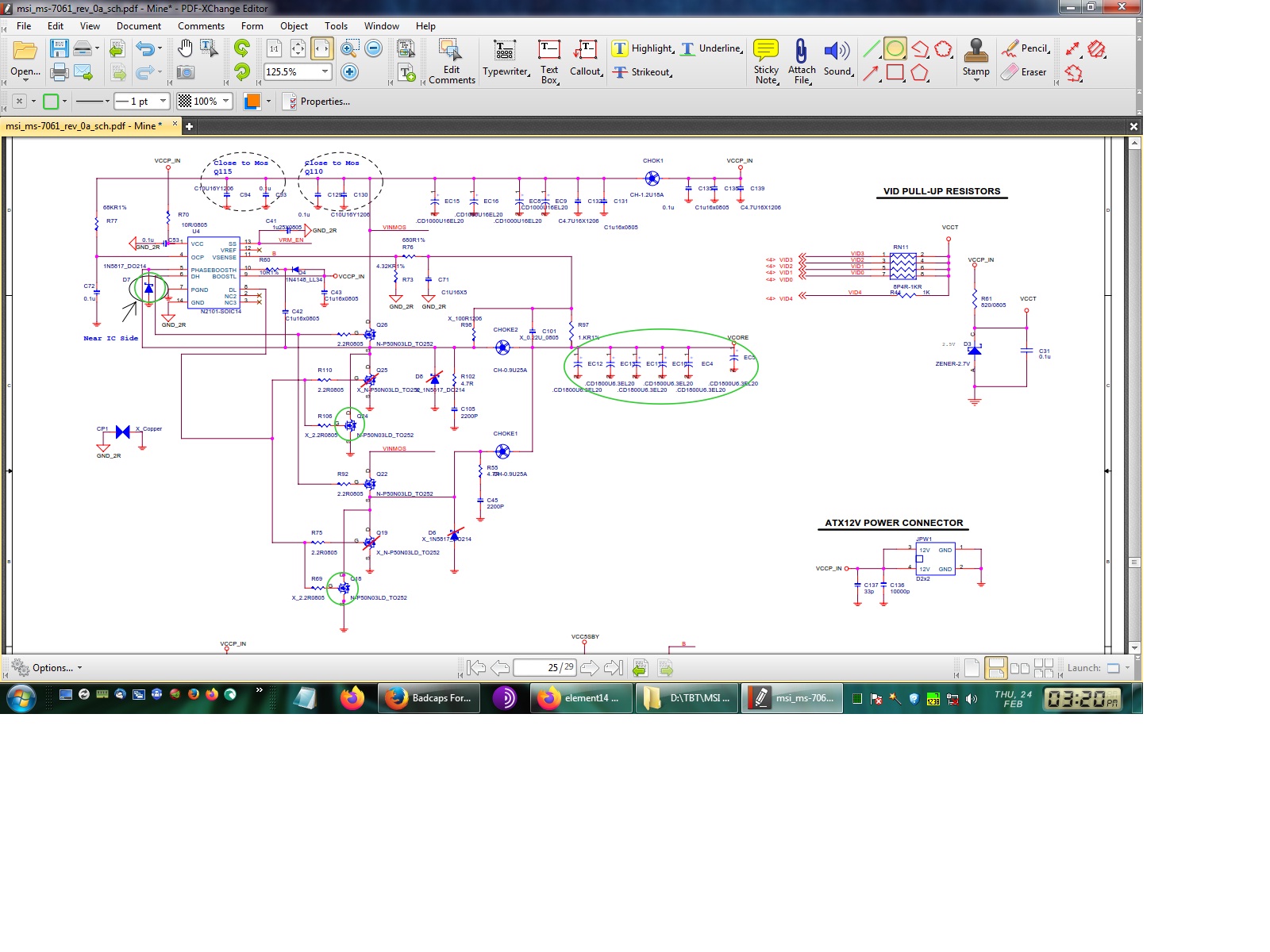

    Looking at the schematic (attached)...
    i removed the 6 VCORE, OST RLX caps, and they all tested within spec and had good ESR.
    Removed (and destroyed, when trying to desolder and lift the legs) the low side MOSFETs.
    Removed the diode that is in parallel with that rail;
    But there is still 30 ohms to ground
    From what i can see, the only reasonable path to ground, that is left, is via the driver chip.
    Or is it OK for there to be 30 ohms to ground on VCORE rail?
    The two MOSFETS and the two diodes, that i striked out in the schematic are not installed on this particular board, so they are irrelevant.
    The components that are circled in green are the ones that i removed
    Any suggestions or tips on what to do next?

    VCORE also powers northbridge VTT. Low resistance to ground is normal.

        Here's the schematic:

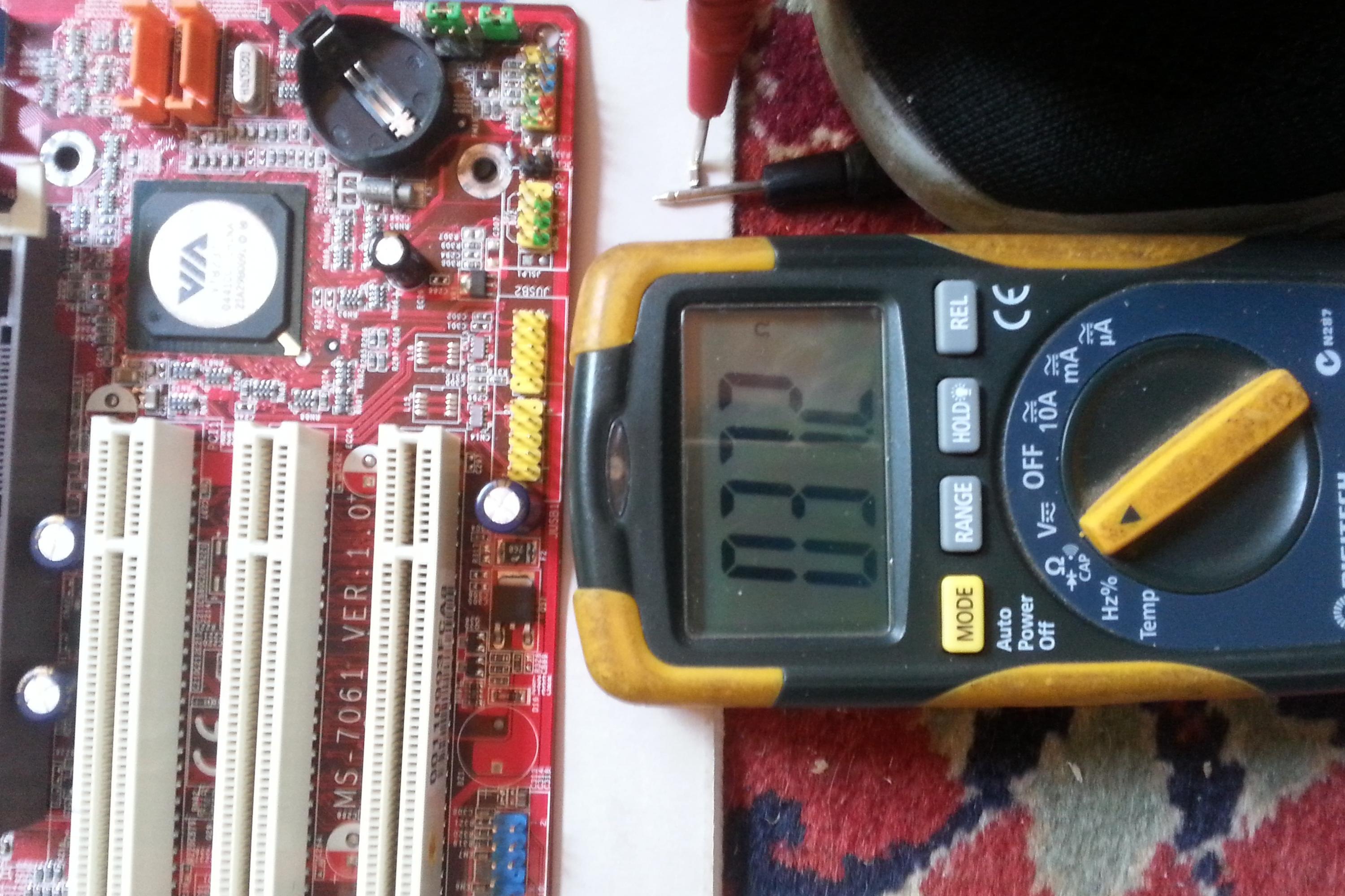

                The current draw with mains power turned off (voltage is supplied by the battery) is 2.47mA, which seems way too high when i compare it with what's happening on the other board, which only draws 2.3uA
                The current draw, with mains power turned on, is 6.5mA
                VBAT only goes to the southbridge and the I/O chip
                0.008W of power is being dissipated out of the CMOS battery by some component or fault.
                0.02W, is being dissipated, if the standby power is turned on
                there is 6K ohms from the positive CMOS battery terminal to ground

                  Indeed the current draw from the coin cell battery should not exceed 10-15µA.
                  Make sure jumper is only connected pins 1/2 and not 3 of JBAT1, and measure resistance to ground on pin 2 of JBAT1. Resistance to ground on RTC power rail should be at least a few hundred kiloohms.
                  If it's low, either C316, U8, or SB1B is shorting it to ground.

                    Resistance to ground of JBAT1, pin 2, is 38ohms
                    I left the meter in position, and then shorted all of the pins (except VBAT) of the I/O chip (U8) to ground, and the resistance didn't change,
                    which means that if the fault is in the I/O chip then there must be 38 ohms to a ground pin that's within it.
                    I tried the same method with the components that are surrounding the southbridge, but no change in the meter reading.
                    VBAT is also connected to the southbridge via a 1Mohm resistor, but that tests OK
                    Also searched for "39R" (and standard resistance values either side of that) on the schematic, to no avail.
                    I'll remove C316, but might experiment, with hot air, on another board first, since it's sandwiched between a tiny SMD resistor and JFP1, which has plastic that could melt,
                    or else i will use two soldering irons and someone else with tweezers can remove it.
                    Will update when done

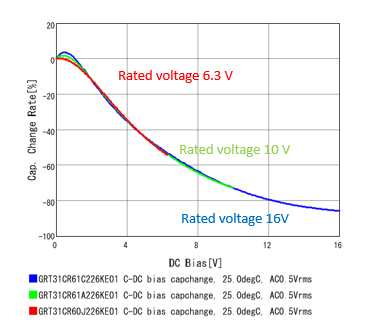

                          i was going to use a 50V cap because of what someone posed in this forum:
                          "Generally, with ceramic capacitors, you use capacitors rated for at least 5-10 times the voltage you're gonna work with (100v rated for 12v, 50v rated for 3.3v-5v etc)"
                          But i came across this, and it seems that voltage rating doesn't have any significant effect on loss of capacitance.
                          So i guess that it's not for that reason
                          What am i missing?
                            Re: MS-7061 KM4M - Not powering up.
                            No, using a 6.3V MLCC on a 3.3V rail is perfectly fine. I may use a 10V MLCC instead, but any higher than this is unnecessary. MLCCs should already be tested at twice their voltage rating in the factory.
                            Higher voltage rating won't make the MLCC last longer if it never sees voltage spikes near or above its rating.
                            On the contrary, higher voltage rating means the cap will be physically longer, which may not be practical in a densely populated board, and it also makes it more likely to be damaged by the board flexing.
                            Also, an MLCC can start losing a bit of capacitance after many years, but the fact that it is partially shorted is not due to normal aging, it just has failed internally.
