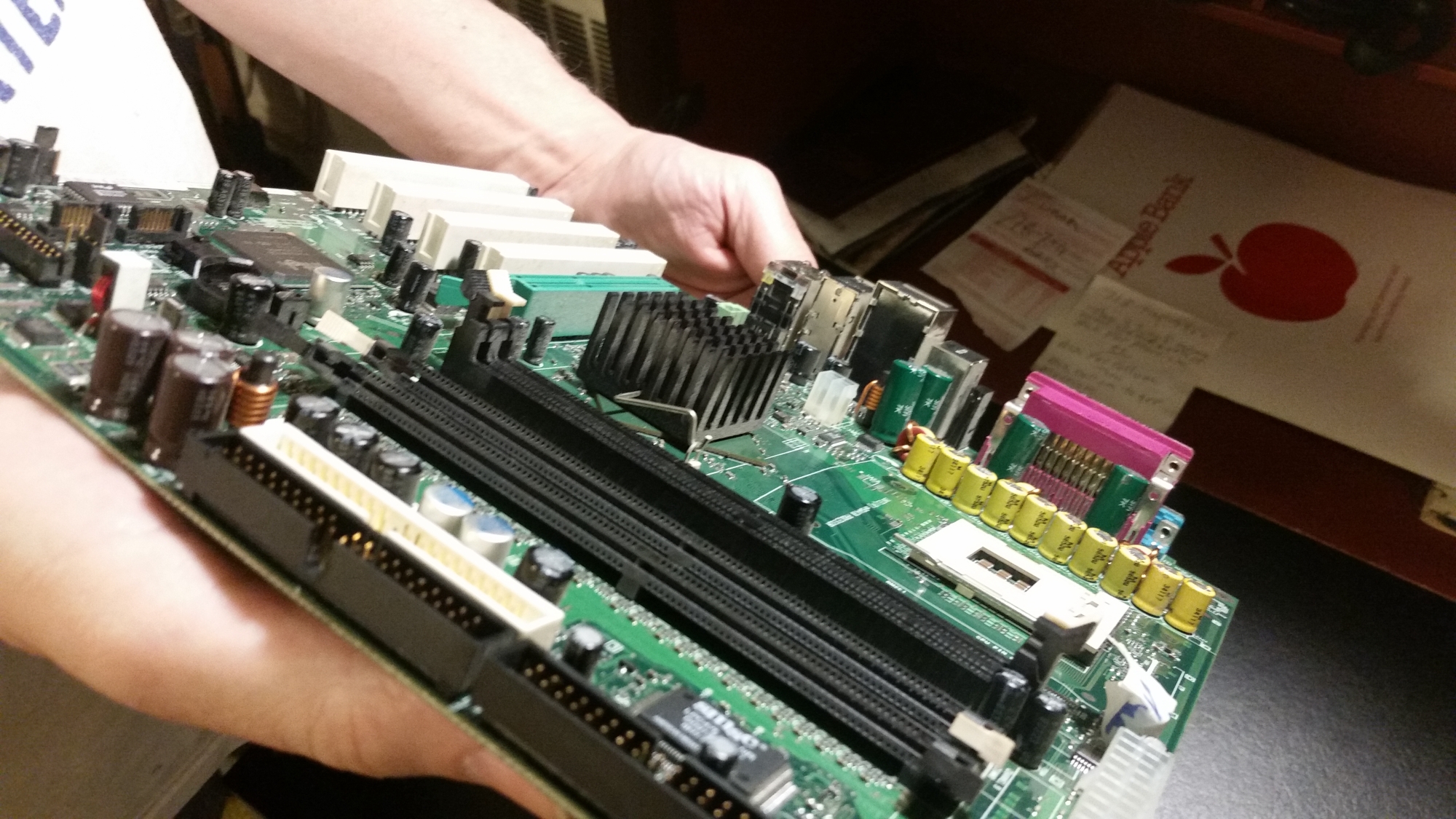

I own a Dell Dimension 8300 motherboard that will post and get to the black (XP pro 32bit) “We're Sorry Windows did not load” Screen.
When restarting any option i.e. “Normal” “Safe Mode” etc. Computer re-boots to same screen. I checked RAM with memtest –OK Checked O/S Drive with Victoria -OK
Upon Inspection:

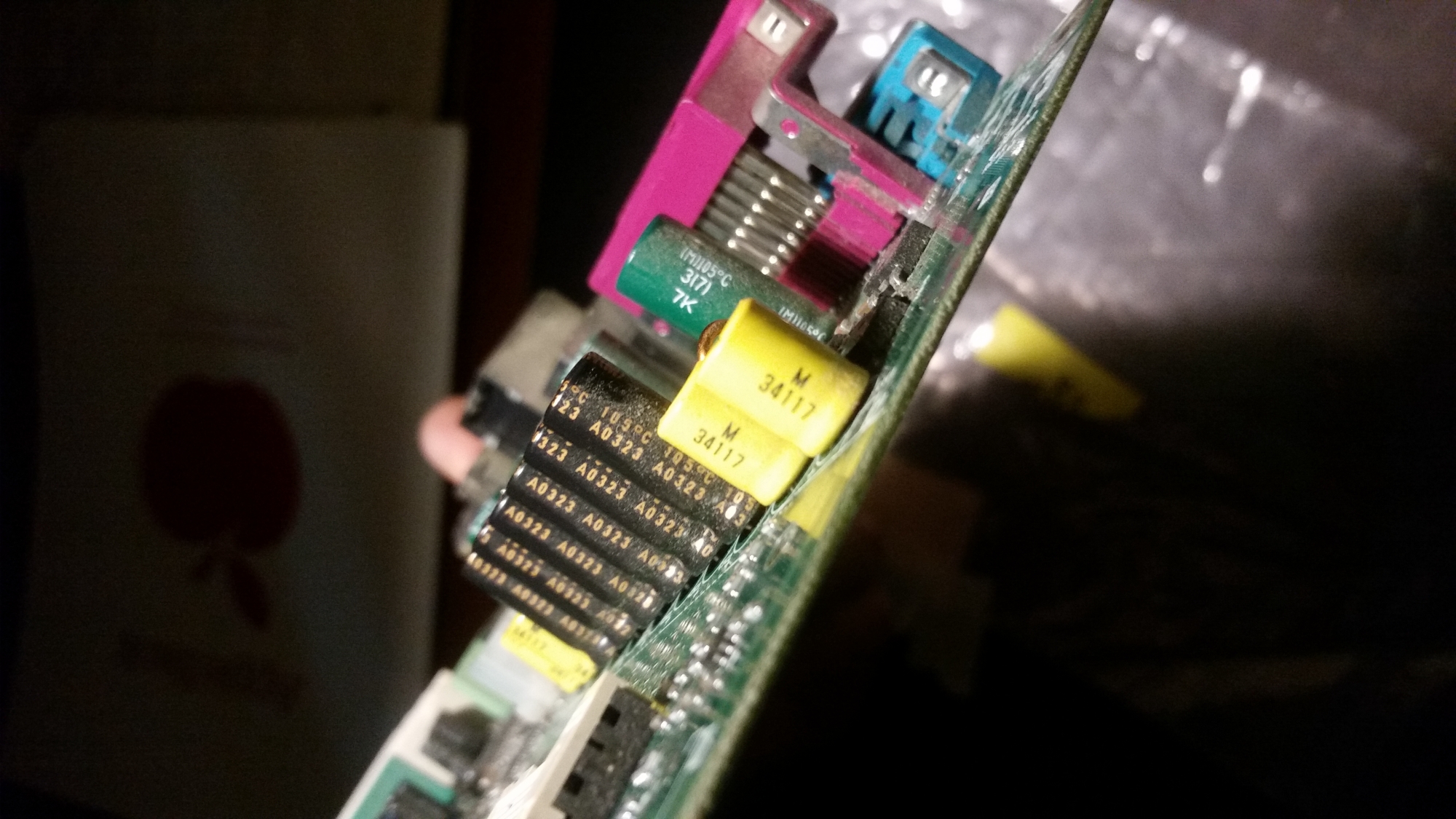

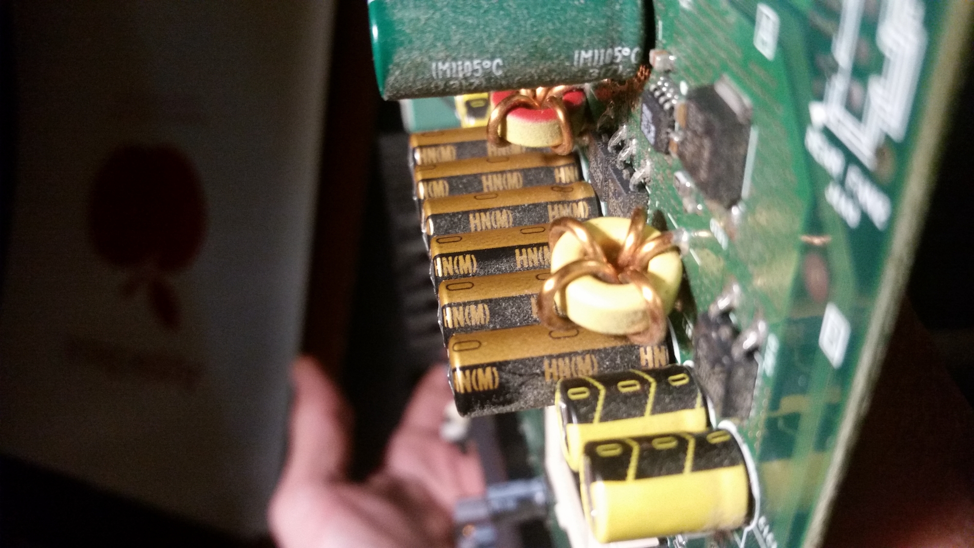

I did a physical examination and see that the 6 caps by the CPU are all bulging in various degrees. (See Pics Below).
I found a YouTube vid with a guy who replaced these 6 caps and the computer works fine. https://youtu.be/U7OGuznpCaA but video it is short on some details.
So from there I scoured the articles/forums on https://www.badcaps.net/forum/ (What a forum!)
The Capacitor Question:
I am of the impression the brand/type caps is imperative. I am of the belief that I need:
Rubycon
6.3v 820uf 8mm x22-25mm
Low ESR for VRM
I think I'm looking for MCZ (?)
So based on this info, and my pics, can anyone illuminate me on my path?
Are there other brand/type options?
Are there more hardware specs I should include?
