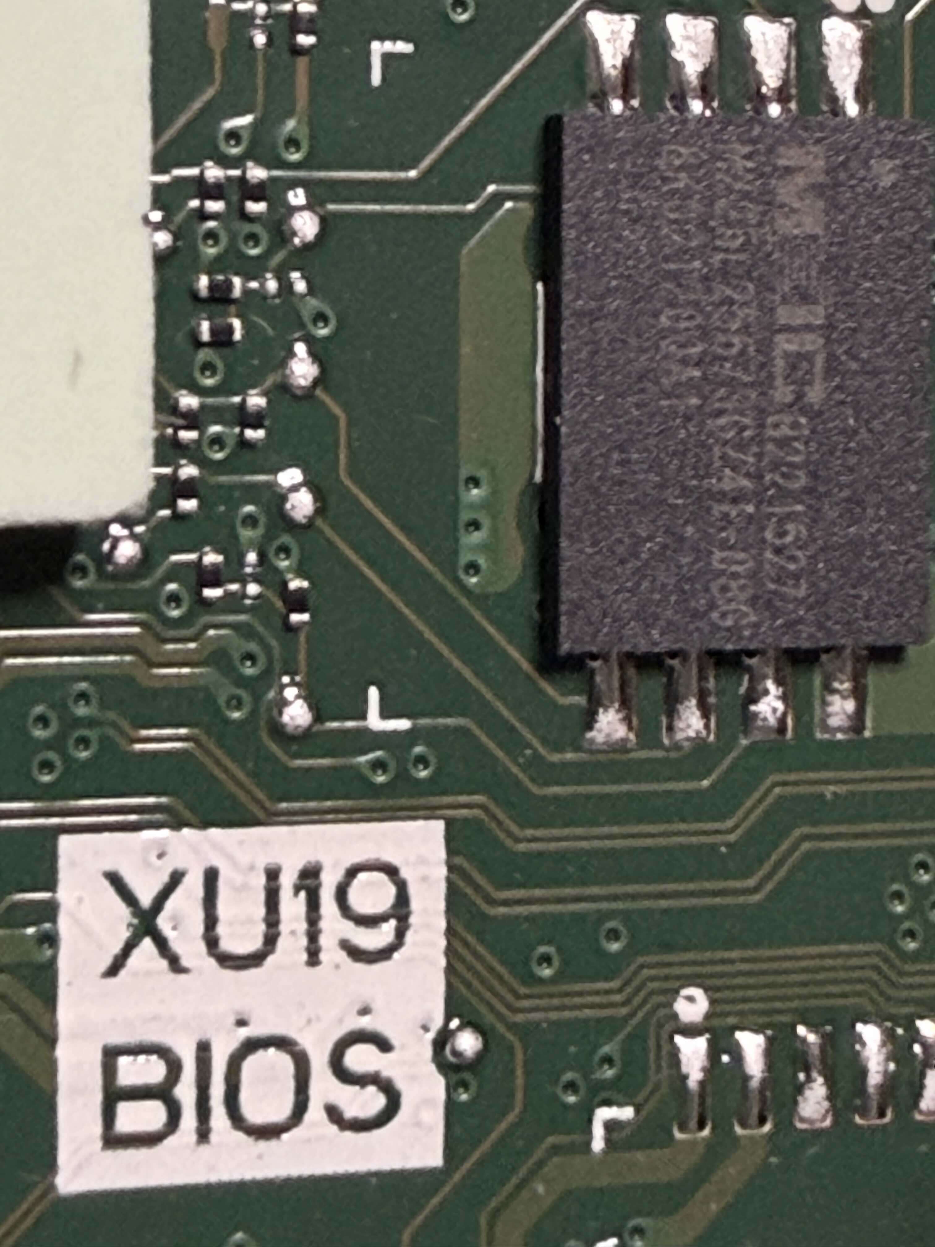

        Hello everyone.
        I have a problem with Hp Elite 600 mini g9. I had a password in the bios and I wanted to remove it, I connected ch341 black and without desoldering the memory chip I read the bios. But I noticed that the connection with the memory via the programmer is not stable because it did not always detect the memory and its id was always different. Something must have happened during this connection because the hp stopped working. I desoldered the memory because I thought it was damaged but it only worked that it was empty... I downloaded a few bios here on the forum and installed them for testing but the hp has no reaction. It does not work at all. Is there any possibility to repair it? I do not have the correct bios version. I have its data such as BID SKU SERIAL etc.
        Best Regards

        Originally posted by PiterQ View Post
        Hello everyone.
        Best Regards
        Post a picture of the chip and the surrounding area, you might have dislodged a resistor or something.
