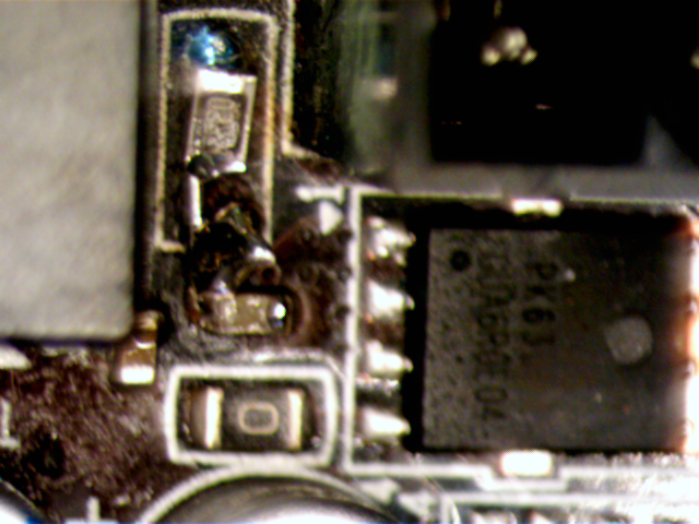

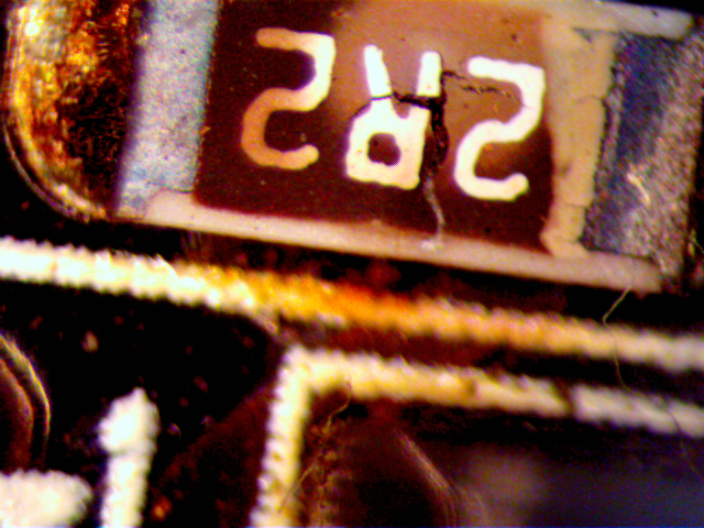

          I found a shorted 2R2 resistor near the atx connector, but the one I replaced it with was smaller and it smoked straight away.
          I have tested with two axial resistors which gives 2.2ohm and it along with a short on the drain+source of the P06P03A allows start up with the power button everytime...but the resistors are scalding to the touch.
          I think I got a reading between 0.1A and 0.4A on the 1.5v input to that resistor and someone advises me the resistor is likely only for current sensing so shouldn't have a reading that high. I'm going to check that again tomorrow.
          The gate of the P06P03A is the same voltage that is seen down near the BIOS battery so I think that area was a receiver of bad power so not the right area to focus.

              2.2ohm resistor is probably not for current *sensing* but rather for current *limiting* (or protection). Can be put before the VCC pin of an IC for example. Also it wasn't shorted but open.

                Thanks for the guidance piernov, I just bridged pins of the mosfet at the bottom right in the attached picture and I replaced the failed 2.2ohm resistor with 2x1.x ohm 1/2 watt resistors in series. The resistors get scalding hot but haven't burned after a few hours of being powered on with the machine doing some youtube and some windows updates.
                The resistor was for the 1.5v section for the RAM by the sounds of it. I'm wondering if it is provided as a part of a protection/limiting circuit for overclocking purposes?

                        I fixed the 2.2ohm resistor with two film resistors in parallel.
