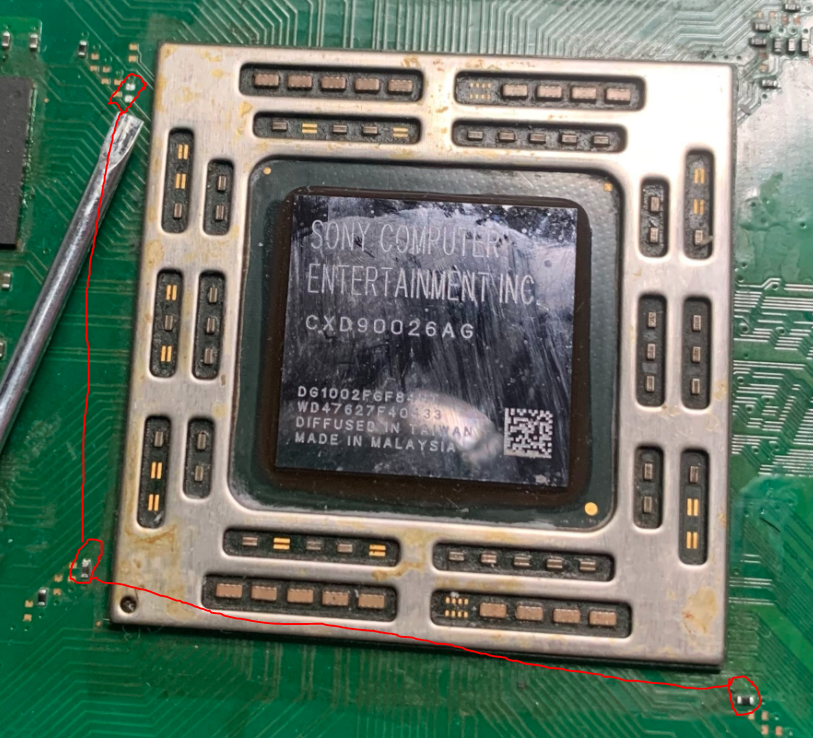

    Hello Ive just reballed a PS4 that had the BLOD but it still has the same symptoms.
    I noticed a component missing from the board, not sure how that happened, it there on all the pictures I look at of the motherboard,
    can anyone advise me what the value of the missing SMD is please?
    Click image for larger version  Name:	image0 (2).jpg Views:	0 Size:	2.10 MB ID:	3243061

    This is a 120 Ohm resistor, the same ones are nearby.
