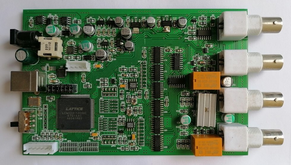

    Was working fine, but now dead, tried different power supply and still the same.
    No noticeable marks on the circuit board.
    The only possible issue I can think of, was that I wasn't using the switch on the unit to turn it on/off, I was using the wall socket (For a few months), because I thought the switch was getting a bit loose.
    What info do you need to try and troubleshoot?

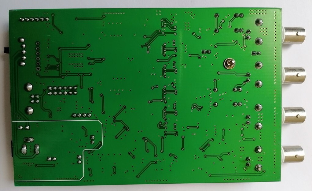

        if it is, shoe a picture of the bottom of the board so i can see the tracks from the power inlet

              thats very clear tracks
              so plug your psu in and meter the voltage at the switch pins to see if it switches properly.
              you can get ground from the bnc sockets

                  so we need a higher resolution pic of the topside so i can read chip numbers

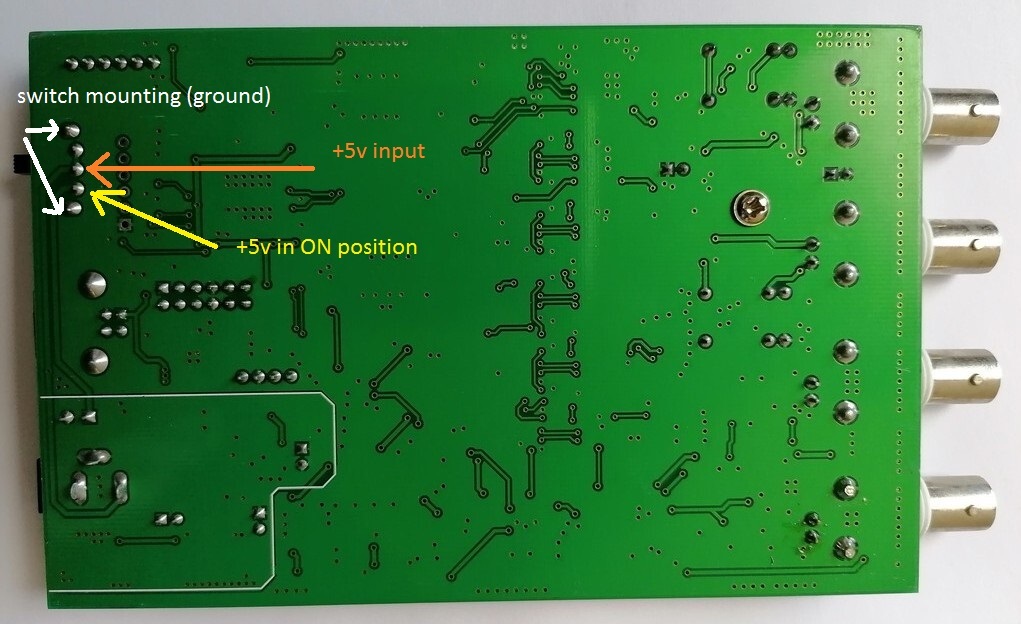

                    That voltage would be correct with the switch in the OFF position, Change the switch to the ON position and you should have +5v on your so called 3 &4 pins
                    The pins 1 and 4 are just the switch mounting and are not part of the spdt switch contacts

                      Ok, changed switch to ON and I'm getting a fluctuating reading on pin 3. (Yellow arrow)
                        • 31259
                        put some solder across the switch contacts to force it on.
                        if that works we just need to find a switch with the same pin spacing

                          "put some solder across the switch contacts", can you explain please?
                            • 31259
                            join the yellow and orange arrows in RJ's picture
                            • fuzzy4
                              • Jul 2024
                              • 18
                              • uk
                              Yes that worked, it powers up.
