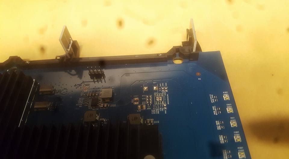

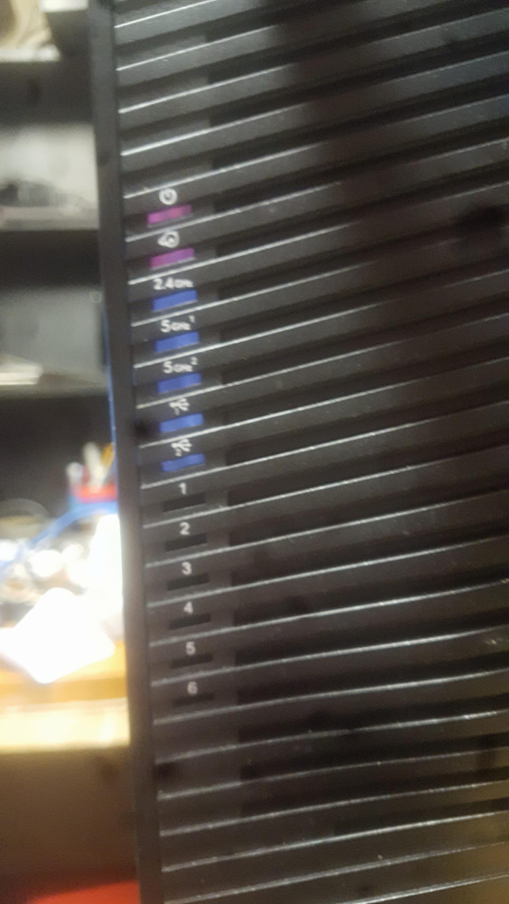

    Hello everyone, I have the forementioned router that I happened to stumble across at my local goodwill. It seems to at least partially turn on but I can't seem to connect to it to do any kind of resetting. I looked in the back and found the actual reset button but it's been broken out. I could probably rip the router apart to jump the joints where the button would be but I'm not sure if the router is even working properly to begin with.
    You can see below the power and internet lights are a amberish color. The internet will blink occasionally and will fully go out if i unplug the cable. The usb and 2.4 and 5ghz lights are a dim white. If i plug anything into the rear ethernet ports the light will glow brightly. I also am not able to see any broadcasted wifi network. I'm not sure if there's something wrong with the router or if it could be set to a different mode like a bridge mode or if the DHCP server is completely disabled. Either way I'm unable to get a gateway hooking up a computer to it.

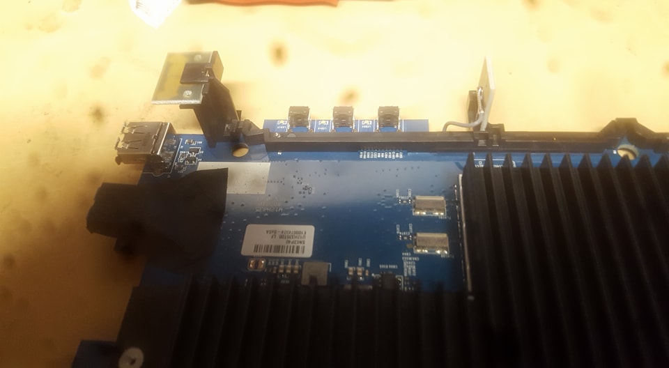

    I'd replace that reset button first with something simple like 2 wires or solder in some switch from the junk bin. Then try to reset the router and see what happens next.

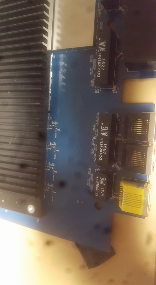

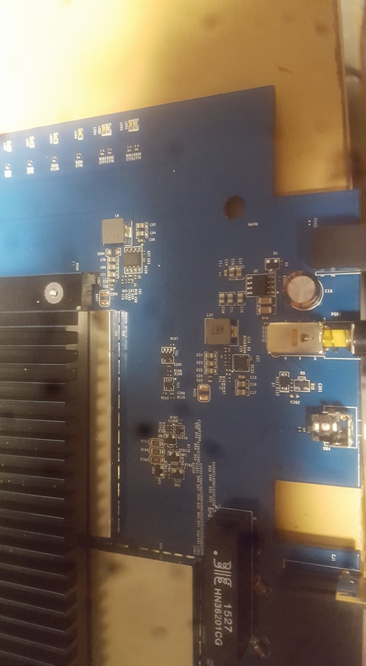

      Dim lights sounds to me like low power, which could very well be caused by bad capacitors. Pull it apart and show us some guts.

        Definitely try to add a reset button. It could have been set as an access point and you want it to reset back to defaults to mess with it. Also like previously mentioned open it up let's see the inside. Change the caps to see if that is causing the low power. Also make sure you're using the right power adapter that gives it the right voltage.

          I don't see any obvious burn marks on the board. I got the best pic i could with the cruddy phoen i have. It looks like there are 3 points for the button. I'm not sure what points i would need to gorund. I can probably take a paper clip to at least attempt a factory reset.

            those buttons are east to get, used in loads of junk and probably on ebay at 5 or 10 for a $

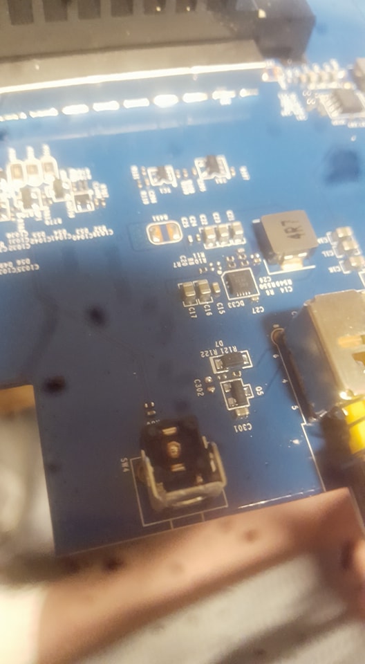

              I'm sure they are, but for the moment I do not believe i have any available...other than ripping one of the other buttons off the same board. That's why for the moment I just want to try shorting out the proper contacts to attempt resetting it.
                Yes! We had a similar problem with a router that was given to us. No wifi. Tore it apart, swollen cap. Replaced that, works fine!

                  Do you have a multimeter? If so, set it to continuity mode and test the other working buttons to figure out what pins are what.
                  The other two look identical, if they are, they should have the same setup. That way, you can see what pins are connected when you push the button, with one of the working ones. I'd do this with the router off, not on.

                    dont remove the bad one, it has 4 pins and may be in series with other parts.

                            Hello everyone. Sorry I did play a bit more with the router. I found the aforementioned buttons have 4 legs. The 2 outer legs are the legs for the button jack and the inner 2 appear to be for the button itself. I was able to get about 2.7 volts measuring the inner legs. I tried shorting those 2 inner legs but didn't seem to make a difference. I even tried making a solder bridge but no apparent effect. I did notice that if I disconnect the router from my adjacent router I do get the Internet light to illuminate. If i hook up a device to one of the output ports from the router to say a laptop. that lights up as well and I seem to get an infinite connecting loop from the device I'm using. Not sure what that leaves me with at this point. For the moment, I am unable to try the suggestion to use a serial connection using the jumpers and a terminal as i do not have the proper cable. I'm not sure how i'd wire something like that anyway unless there's a special cable built for that.

                                    So at this point based on what I know. I ended up just completely removing the reset button and did various combinations of soldering the various 4 legs of the button to force a connection. Nothing seemed to have any effect there. I can get an Ip4 address but that could be my computer caching a previous IP address from a different connection. I did try resetting my ethernet adapter as well as clearing my DNS cache. No effect. I also do not get a default gateway. The only thing I can think of to try would be to get that serial connection working but i'm still not sure how to go about doing that.
