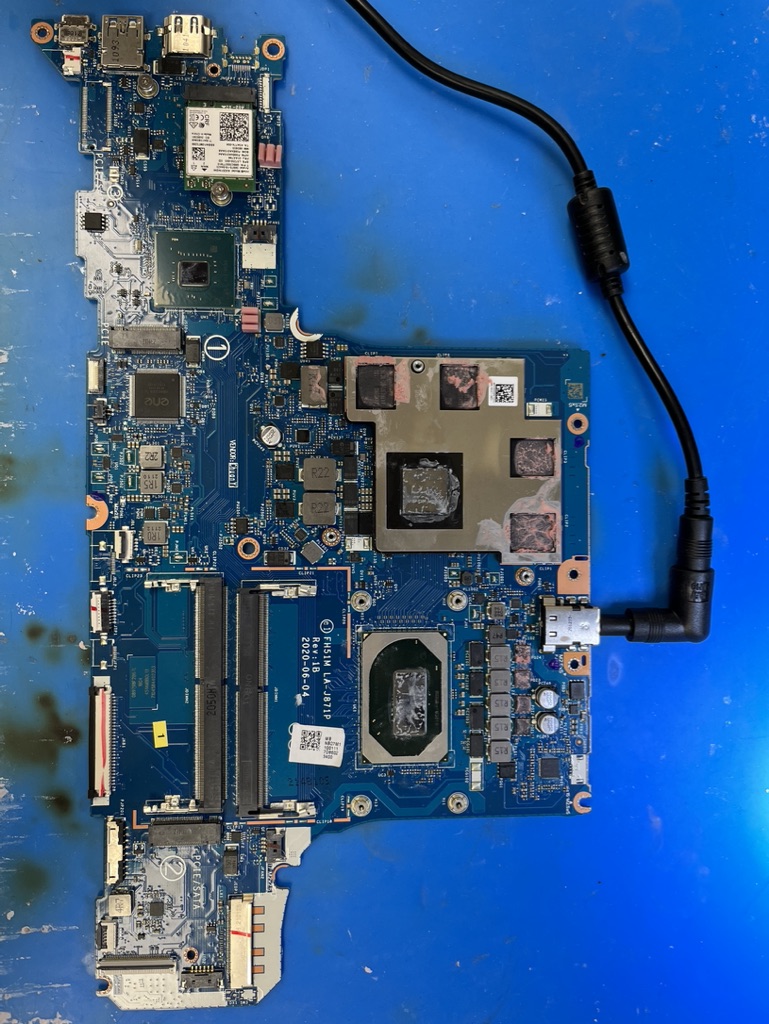

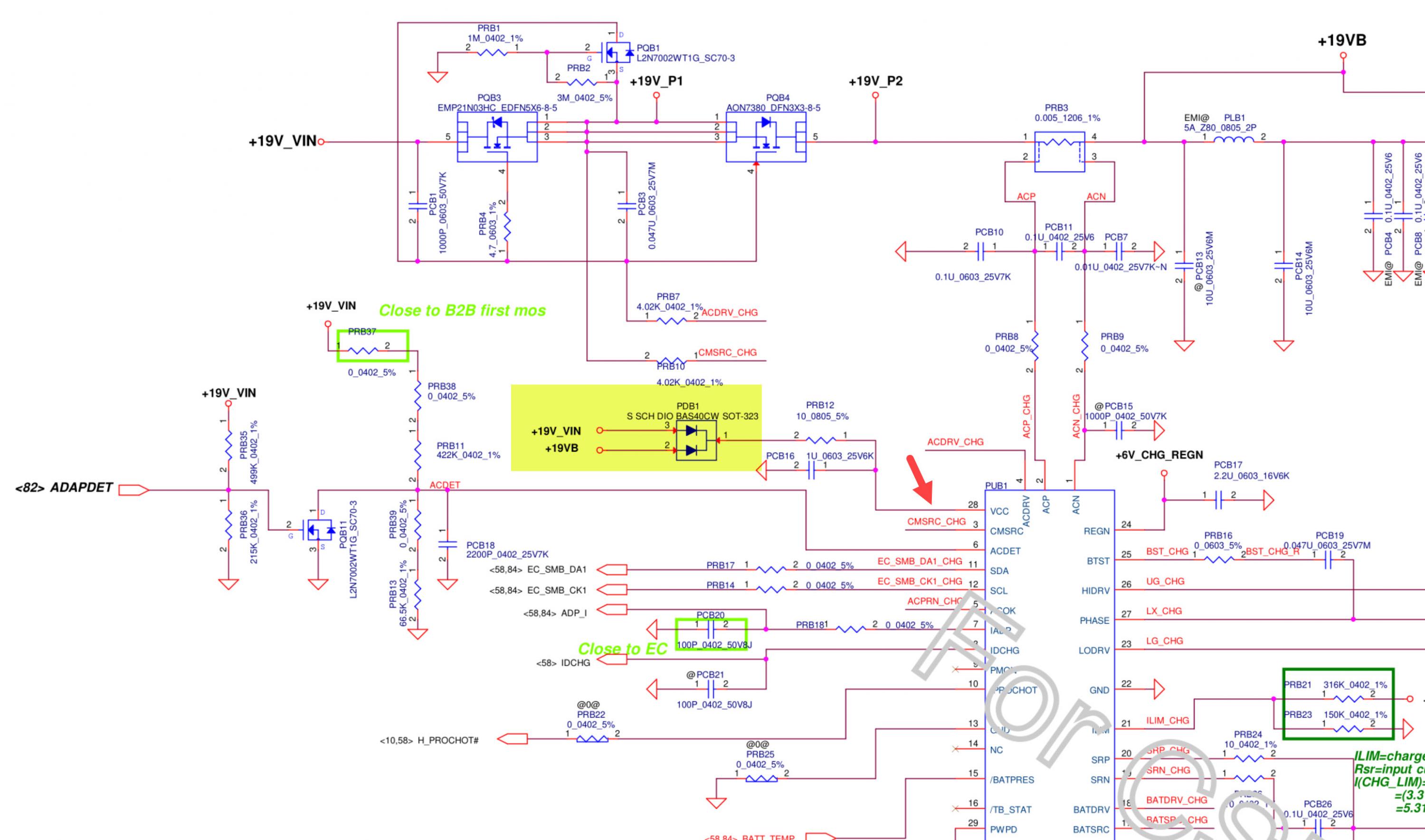

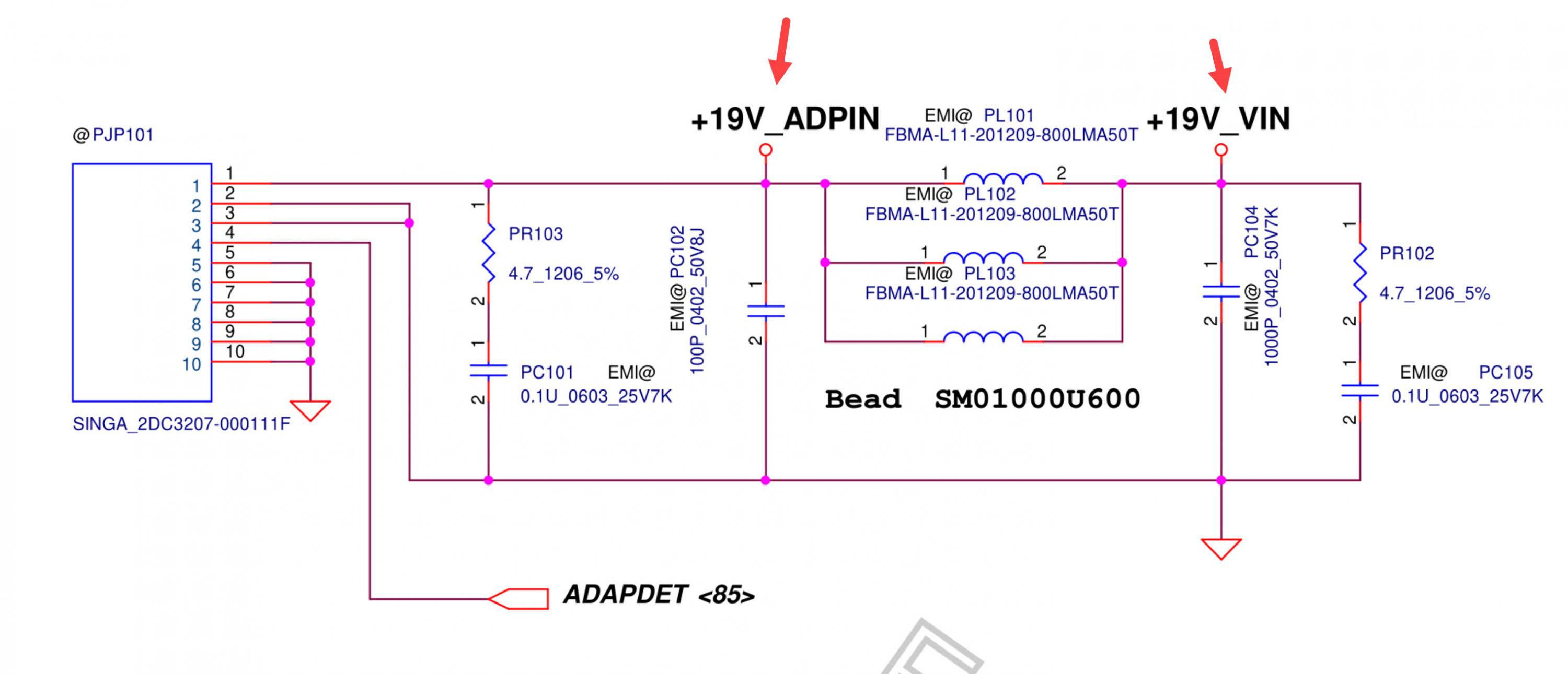

Hello guys,

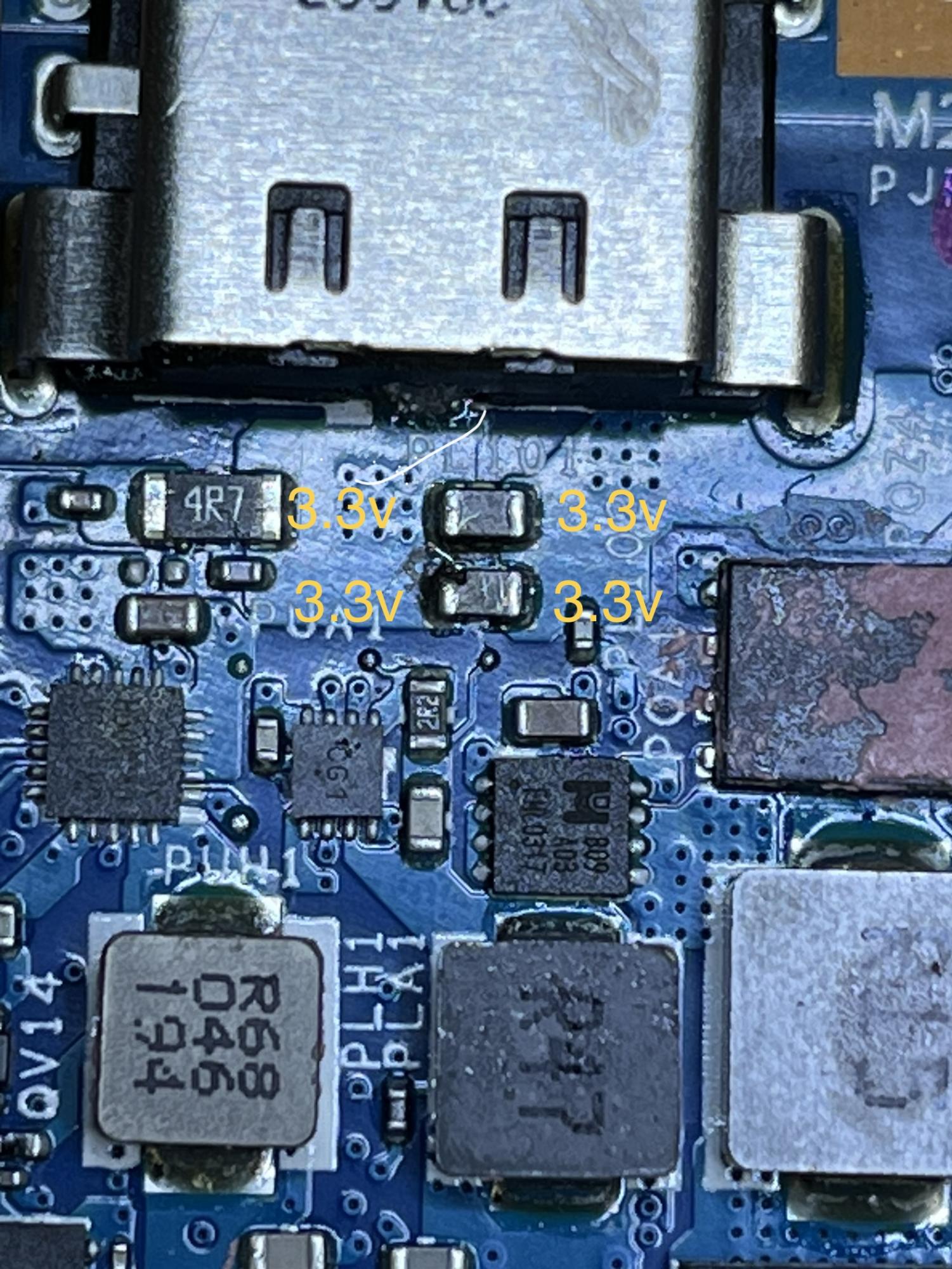

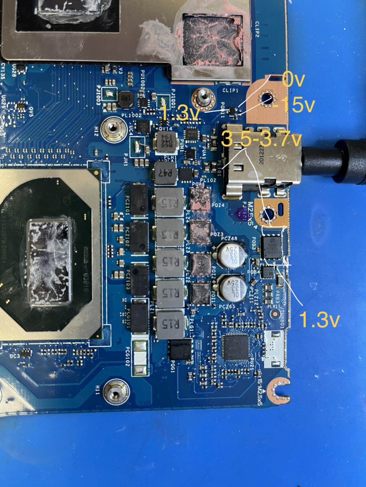

I have a Nitro 5 motherboard that is not powering on. When I connect 19.5v from the power supply, I get 3.3-3.8v where the charging port AC-in is supposed to be. For the supply and gate of the MOSFET I get the same 3.3-3.8v and at the drain 1.3v. The 3.3-3.8v jumps up and down with and without the MOSFET installed.
There is also a PQB11 where I get 1.3v at pin 1 and 0v and -15v for the other pins.
All this with 0 amps being drawn. Any ideas?
Board number: FH51M LA-J871P Rev: 1B 2020-06-04
