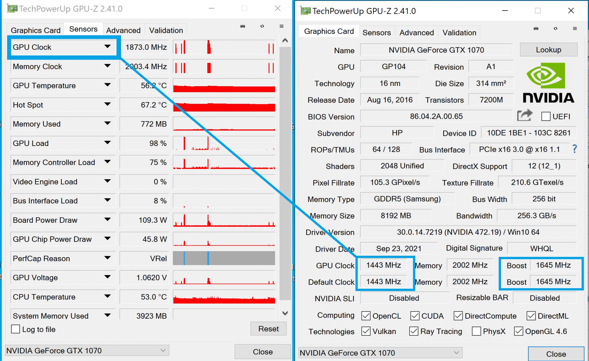

                          I have found a problem on the GPU.
                          When I start to stress test the GPU it runs on 1870Mhz, but this type of GPU maximum Frequency is 1645Mhz even on boost mode.
                          How can i fix this? Is is possible thart someone has overclocked it? Is the GPU bios in another IC then the simple BIOS?
                          Attached a picture of the clocks from GPU-Z.
                          How can i change the clock to default?

                            I think it has seperate bios chip for gpu. Are there shematics for this device?

                                I have read, this behavior of new GPU-s are normal. I have checked and my laptop T1200 also doing the same in GPU-z. But I wanted to reflash GPU just to be sure, but https://www.techpowerup.com/vgabios does not have the same GPU bios for this subsystem device id: 103C-8261 only "10DE 0000" and i dont know if it is safe to flash it by force.
                                So maybe back to square 1.
