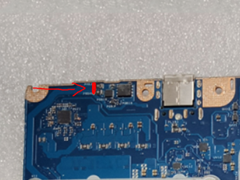

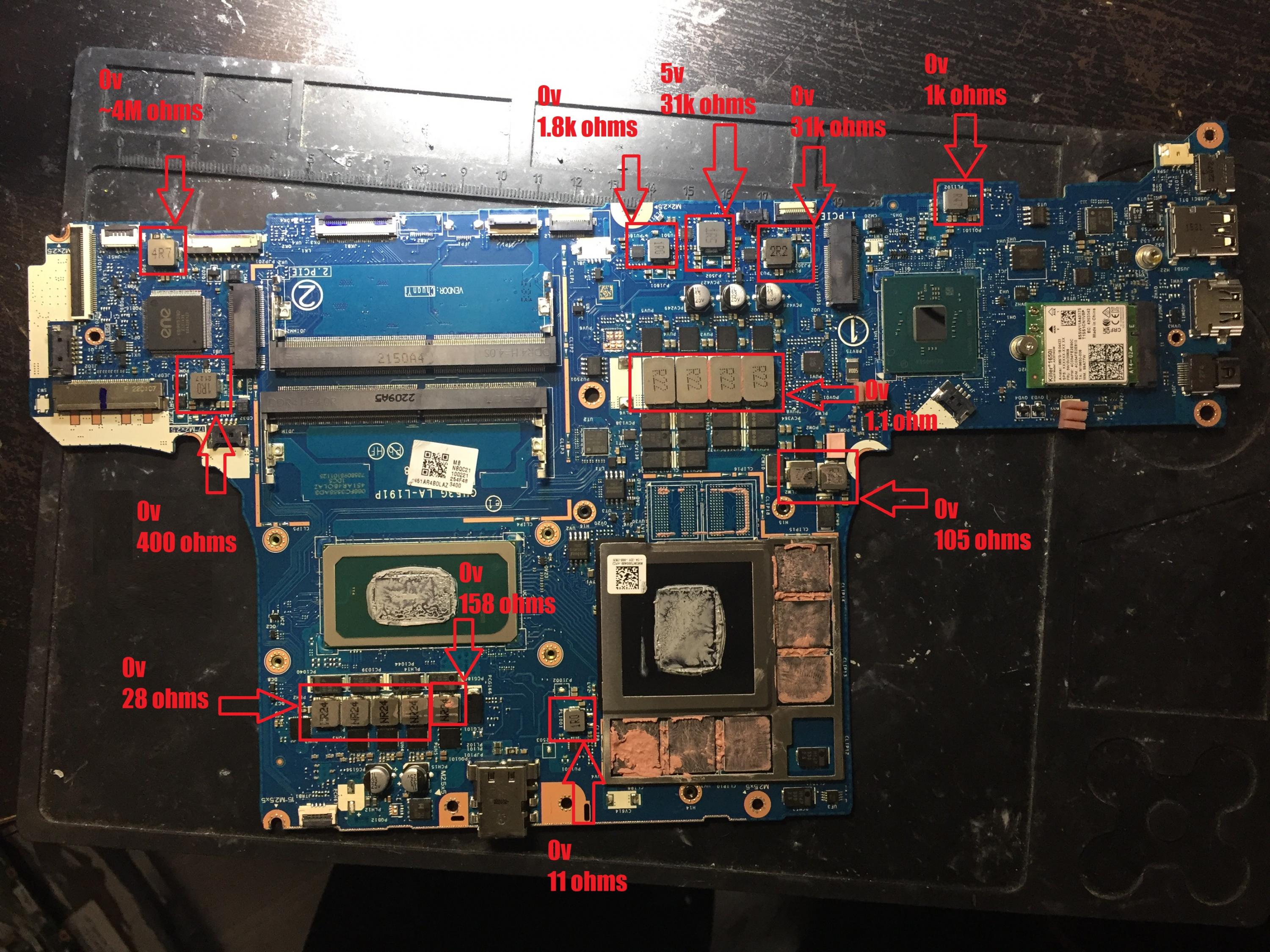

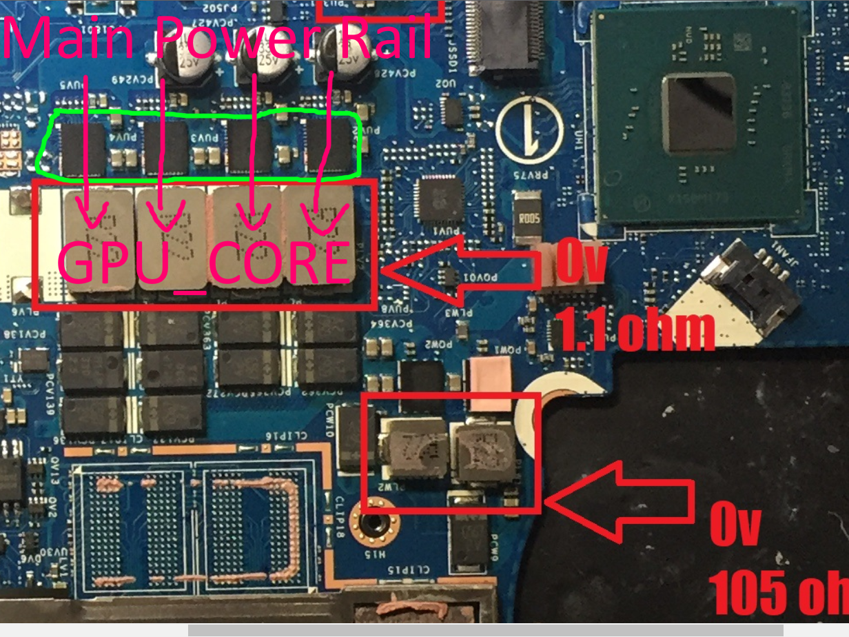

            But no, the Inductors/Chokes are almost never a issue in these circuits. lemme explain a bit more so we don't have a misunderstanding in the end. Look at the attached pictures.
            In Picture 1) i have marked in red what i assume is the Main Power Rail after the DC-IN Fets. Share the reading please.
            In Picture 2) you'll see a likely known-good overview about the Resistances to GND of the various Power Rails present on your board. I've reviewed the readings and they make sense to me. Compare please.
            In Picture 3) i try to describe what might went wrong with the GPU. But still, it's just a guess. You'll notice the Inductors/Chokes circled in RED, and the DrMOS circled in Green. if one of these DrMOS got internal shourted between High-Side Drain (Main Power-Rail) and High-Side Source (GPU_CORE), the Main power rail will will be in fact shorted to GPU_CORE (Purple Arrows) and causes a awful low reading at the Current Sense resistor (Picture 1) as the logical result.
            Some GPUs does not survive 19V coming in and some do...
            This is just a example of a so called-High-Side short. It can happen with the VMEM supply at the bottom-right too, and also with the supplies related to the CPU. The exact measurement at the Current Sense resistor gives the clue.
            But first things first. Meaure resistance of one of These Current sense resistors (Picture 1) to GND and share the result please.

                So.. On that side of PBR46 and PBR3 to ground, PBR46 measures like...38Kohms then slowly rises, the other side when i get a good connection suddenly goes to 247K then slowly drops..that's rather puzzling! A little resistor there measures correctly, but the super small ones nearby close together measure around 800K and 1.7M! I hope my meter isn't on the way out but I've also cleaned the probes.. Don't know if that will help you or not!
                I'll now go and measure the rest and report back. Sometimes when i reconnect to those points (PRB46 or 3) it goes into the millions of ohms.. Confused! And to think i'm supposed to be an electronics engineer but this thing is so proprietary and...its dead so i can't even use my Oscilloscope for anything!
                Kind regards,
                Lea
                  Re: Ongoing Acer Predator Triton 300 G53G LA-L191P woes
                  Well...this isn't looking good! I assumed 0v means a probe on ground, i tested each side of the inductors and here are the disturbing results..
                  Okay, from left to right, doing the 'top row' first along the board's longest edge we have 6.67M not 4M, 0.07ohm not 1.8k, 3.4k not 31k, 0.5ohm not 31k and 0.06 not 1k!
                  Next row is:
                  567ohm instead of 400, 0.4ohm on the GPU inductors not 1.1 (it used to read that across the inductors and across the GPU rail reads 0.6 now, i have installed the new FETs but can always remove them) and 28 instead of 105, which is a RAM rail and probably fine?
                  Final 'row' at the smaller edge of the board:
                  The first 4 inductors measure 50ohm not 28, the 5th measures 246 not 158 abd the last one near the DC-IN socket measures 18 instead of 11!
                  Obviously, a few of these are fine but..what the hell happened to my board?! I just wanted to play some games, had to sell my good PC to cover some bills so now I'm left with a machine that has a 6th Gen CPU and a GTX 1650.. Argh!
                  Any ideas? This is...strange...

                    I would put all the information on hd picture so we can see which coil resistance belongs with which power supply on the board. And use best 200 ohms range on your multimeter and give also the resistance from your probes.
                      Argh! I hope Seph can understand what i wrote, i tried my best! My phone camera tends to produce massive jpeg files lol that's why after each measurement i said "not xx" as on the pictures.. I'll do it later when i'm back from the doctors, i hope he hasn't disappeared..
                      Regards,
                      Lea
                        I did not disappear, but i am always very busy...
                        So the good news the measurements are actually very helpful and the GPU doesn't seem to be the issue, but the PCH, which brings us to the bad news.
                        It looks like 3.3VALW, 1.05VALW and even 1.8VALW are dead shorted to GND and from my understanding there is no point to continue with the repair attempt from here. The indication for a shorted PCH can't be more clear. Sorry
