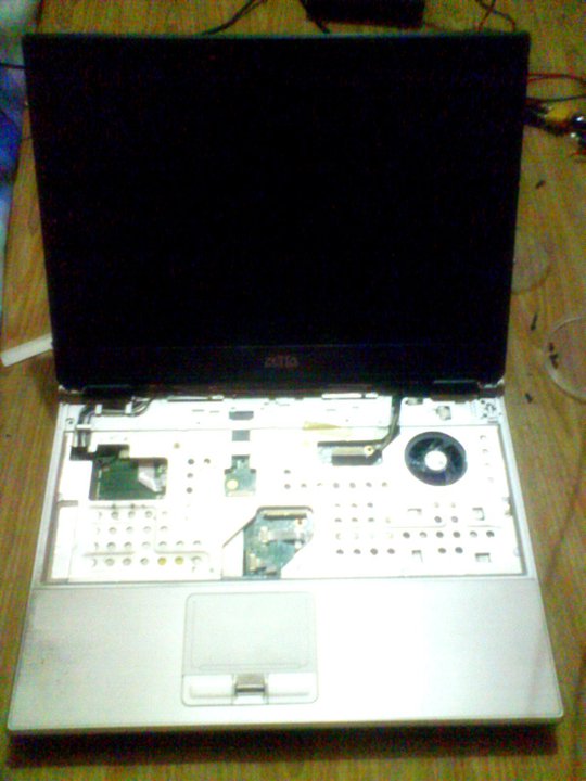

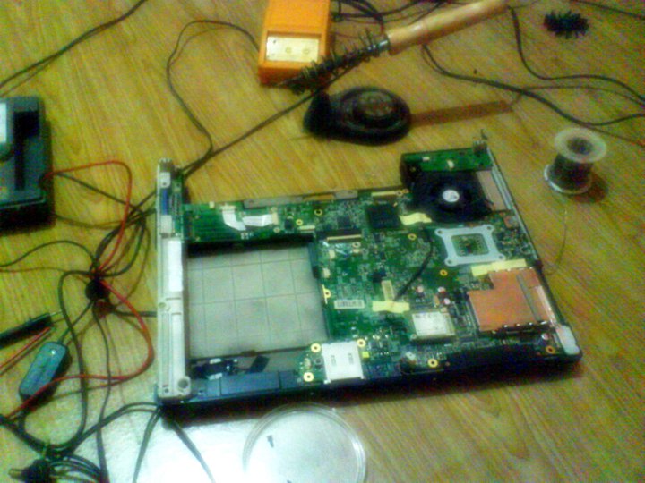

    hey all, i need help.. a friend of mine was trying to fix his dead notebook processor's fan.
    the replacement fan has wires color that didn't match with the original fan.. (the connector is different too). so, the idea is to cut the cables+connector from the old fan and wired it the new one. the problem is, the old cable has three color: red, blue, and orange. so, anyone know what is the color for the (+), (-), and rpm/signal?

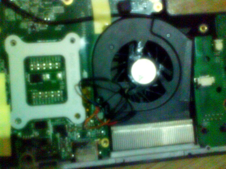

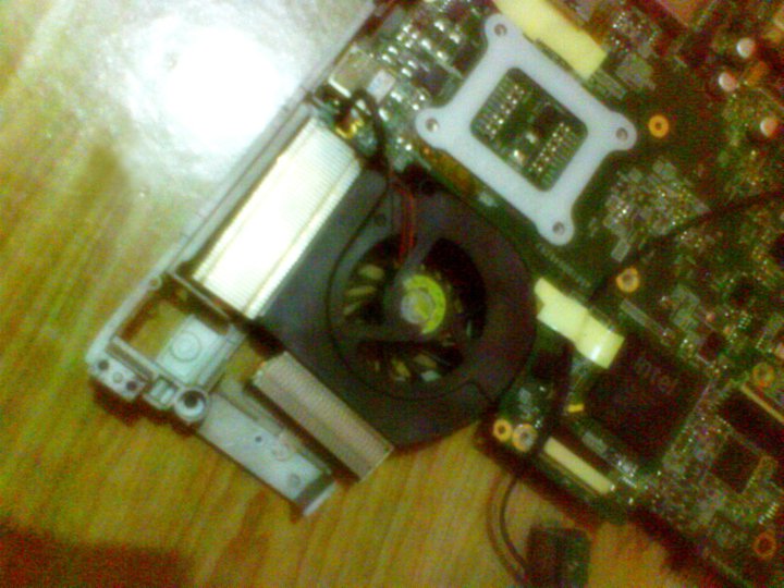

        thanks all, he did it with the..
        red -- +5v
        blue -- ground
        orange -- signal
        the new fan:
        note that he use a superglue to stick the new fan into the old frame.. it works!

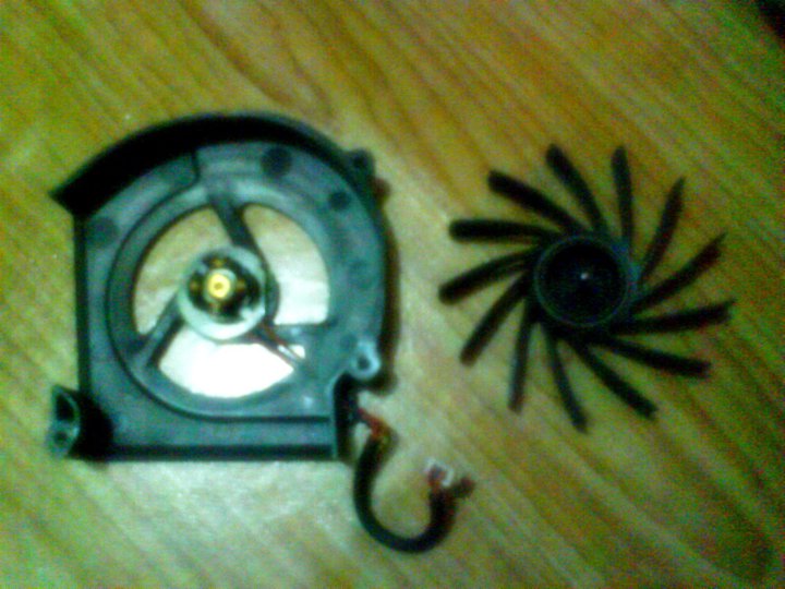

        this is the old dead fan:
        btw, the laptop is Axioo zeta something...
