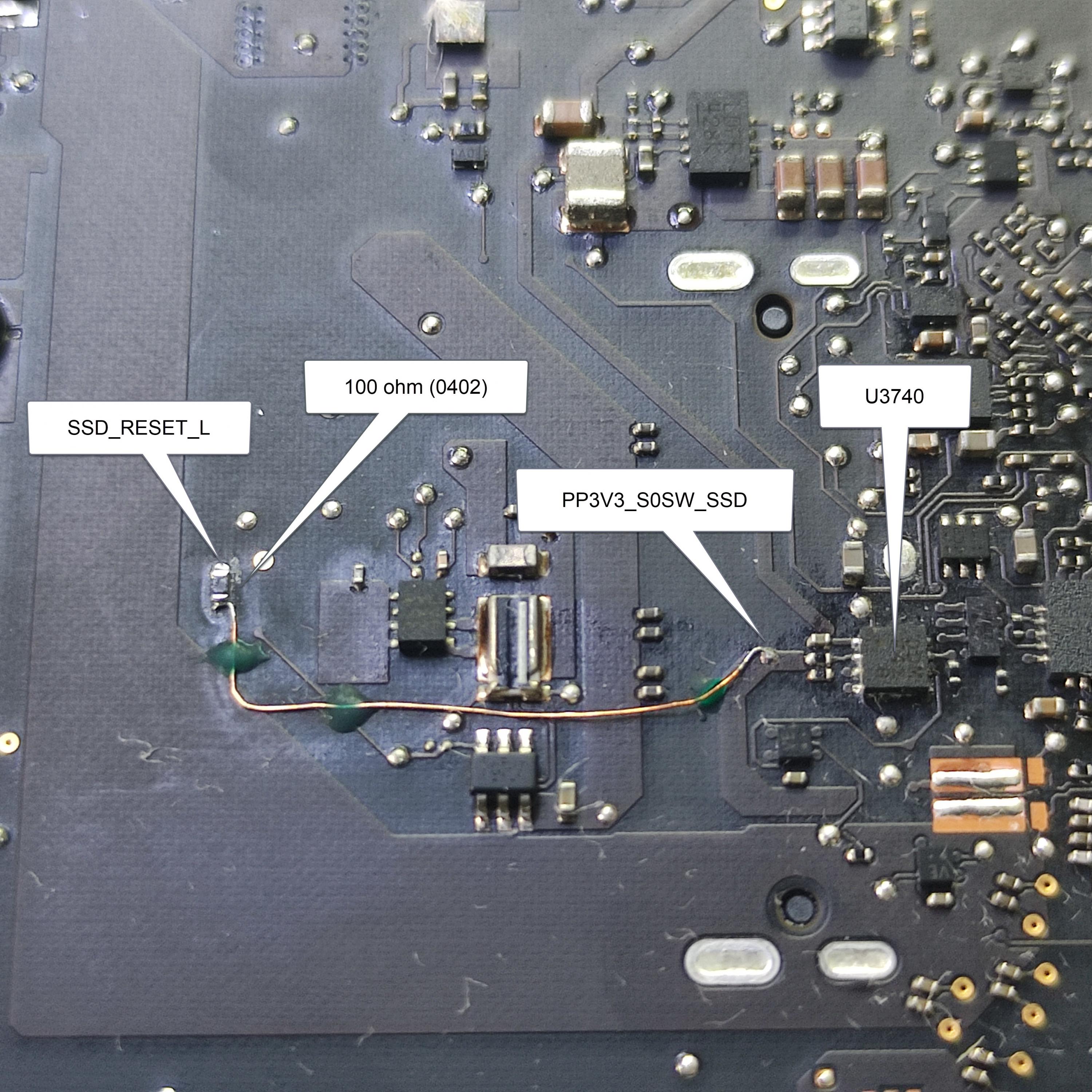

    i have problem with macbook air 820-3437 ex water damage.
    before it was dead but after some touch on IO board flexible and changing shorted caps i can turn it on. the SSD works fine before but after couple days the question mark folder shows up.
    here are some measurements:
    SSD_RESET_L = 0.55V
    SSD_PWR_EN = 3.25V
    P3V3SSD_VMON = 0V
    PP3V3_S0SW_SSD = 0.99V
    SSD_RESET_CONN_L = 0V
    Already changed U3740 but still the same
    R3742 = 97K
    R3741 = 116K
    R3740 = 85K
    can someone give me a hint?

    Should be 3.3V. Review U8070. In the past I've had corrosion under this IC, either at pin1, or at the ground pin itself (pin 8). Corrosion can sometimes be under the mask, look for a bubbling effect around this IC.

        Should be 3.3V. Pulled high when PLT_RESET_L is asserted via R1639, unless pulled low by the PCH. So check these areas.
        I have had this due to a bad output from the PCH on a 820-3437 Macbook Pro board. I circumvented it by pulling SSD_RESET_L high via a 100 ohm pullup from PP3V3_S0SW_SSD. Basically, when PP3V3_S0SW_SSD is enabled, it pulls the reset line high at the same time. Attached image is from that MBP board.

          many thanks @reformatt, i did circumvent like what you did and it works. does it last long?
            Re: 820-3437 ex water damage SSD not detected
            Still working to this day. Easier than changing the CPU.
