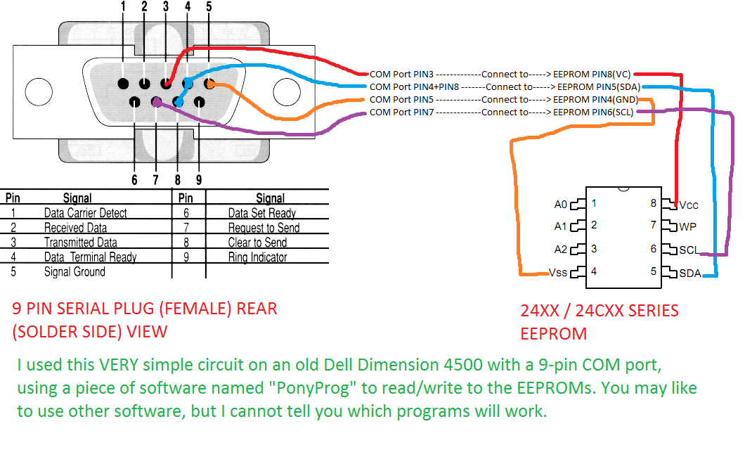

                                  Re: Acer Aspire 5315 - Dead
                                  you can also find really simple circuits like this one to progrmme spi flashs.

                                        For your laptops I think you should actually be able to program them in circuit, of course it requires a proper programmer to do it, and the correct BIOS binary file to program the chip with...
                                        If it does not comply you will need to desloder the BIOS chip and program it that way, might be enough to lift a leg or two aswell if you know what you are doing...
