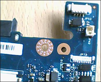

Hi all I am new to this forum and i have searched for a solution endlessly already.I shorted my dell mini 10 by pluging an ac powered usb port into a external dvd drive that was connected to it.anyway it powered off straight away and hasnt come on again .I tried the new lead /no battery /hold power button methods and am getting power on the power lead connector to motherboard but after that i can't see anything blown on the board anywhere.Is ther a way to check the circuits with a multimeter?if anyone has an idea of what to look for on board I would be very grateful,any starting points at all appreciated thanks Mark

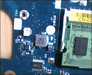

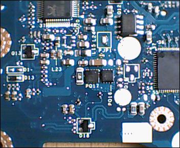

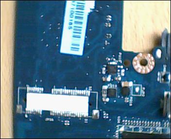

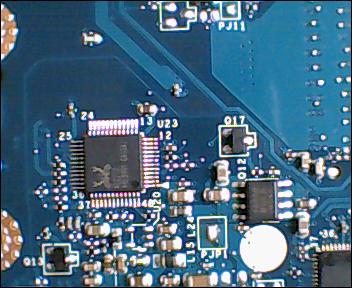

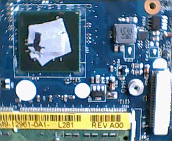

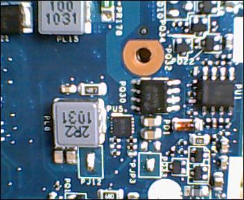

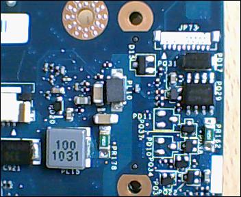

Inorder for badcaps to help you, You need to post clear and focus pictures of the board of both sides and a couple more where the USBs were plugged in.
They have to be focus and clear so we can read the print or traces.
Re: dell mini short-circuited

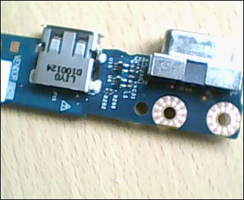

OK I couldn't get clear pictures with phone so i video'd the board on both sides ,I hope these are clear enough,the usb port that shorted the dell is the one on the seperate little board .I really appreciate the help by the way,if the video is not focused enough i can try to borrow a digital camera later.
Look for little green components with an "F" on them. These are resettable fuses, but on a gross overload they can permanently fuse.
However your problem sounds like you have burnt out some component in the power system the best option may unfortunately be a new motherboard, contacting Dell for out-of-warranty parts sourcing may be helpful or you may just want to sell it as is.Please do not PM me with questions! Questions via PM will not be answered. Post on the forums instead!
