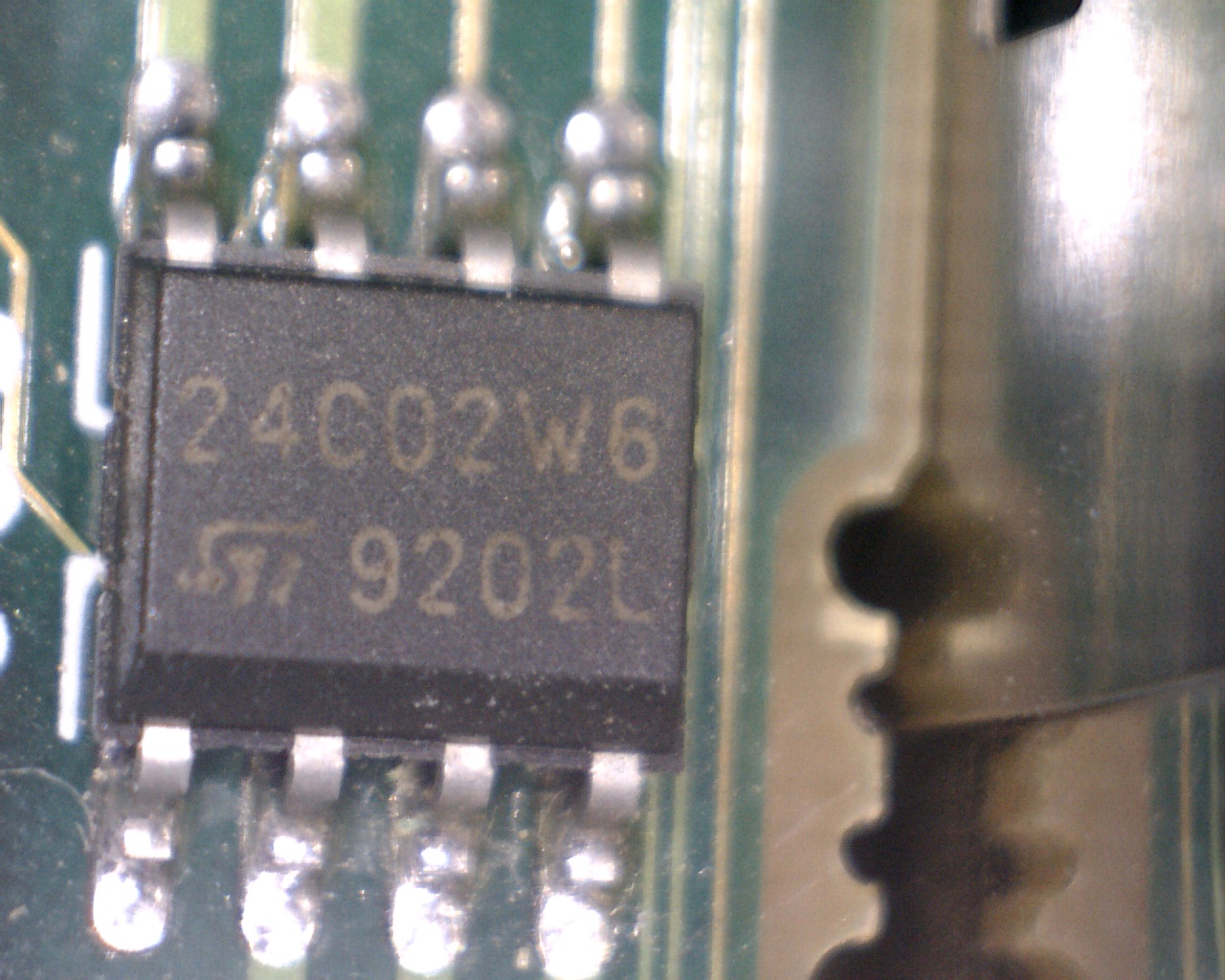

    So, I bought a computer off of Craigslist and the Admin Password is locked in BIOS. I took the time to disconnect the BIOS battery and when that failed I even jumped the BIOS chip to come up with yet another failure. Now, this computer is so old, I don't even know why I'm wasting my time with it but does anyone have an unlock code for a Dell Latitude C840 (Service Tag# FWTHJ11)? Thank you in advanced for any help you're willing to give!

    What I've found so far:
    Code calculator generating a password out of the laptops serial number
    http://dogber1.blogspot.de/2009/05/t...ered-bios.html
    https://rapidshare.com/#!download|54...ygen.zip|9|0|0
    Paperclip trick (erasing a 24C02 EEPROM which contains the PW)
    http://web.archive.org/web/200311030...ell/dell6.html

                                    Well, I was working on the laptop and retrace my steps, make sure I was doing things right seeing that I have worked on this so long ago I don't remember what I had completed (seeing my notes on this one were not very complete, I'm sure out of pure frustration ). So, I want to make sure I'm shorting this BIOS chip properly, I found a webpage that says you have to short either 2 & 7, 3 & 6 or 4 & 5... I have done all 3 of these combinations with no results! I believe I have found the schematics for this chip, but seeing the actual chip is obsolete I'm going off of an ROHS version that I think is the same. Also, I took a picture of the chip itself.
                                    If someone could please help me and just run through the process of shorting the chip to verify that I'm doing this all properly and to make sure I have done the right pin combination, I would be in debt to you! lol! Thank you for all the help that everyone has provided thus far!
                                    Thank you in advanced,
                                    Peter
                                    Attached is an image of the chip and a data sheet for 24c02-x

                                      I'd like to mention my own input on here, as not one person (after looking through at least 40 forums and tech website searching for the right jumper location on one of them) I almost bricked one myself before it hit me. If you are going to do the jumper cmos to ground for 30 seconds to attempt to erase it then PLEASE USE A 100 OHM THROUGH HOLE RESISTOR - NOT A PAPERCLIP. Why you ask yourself? this is why, with a paperclip on the wrong jumpers you just destroyed your motherboard. A 100 OHM resistor will still drain the circuit completely may hold it 45 seconds instead of 30. But the resistance will stop complete destruction if it slips or you get bad advice on which spots to connect. Because you did not want to destroy the CPU with 19V input.
