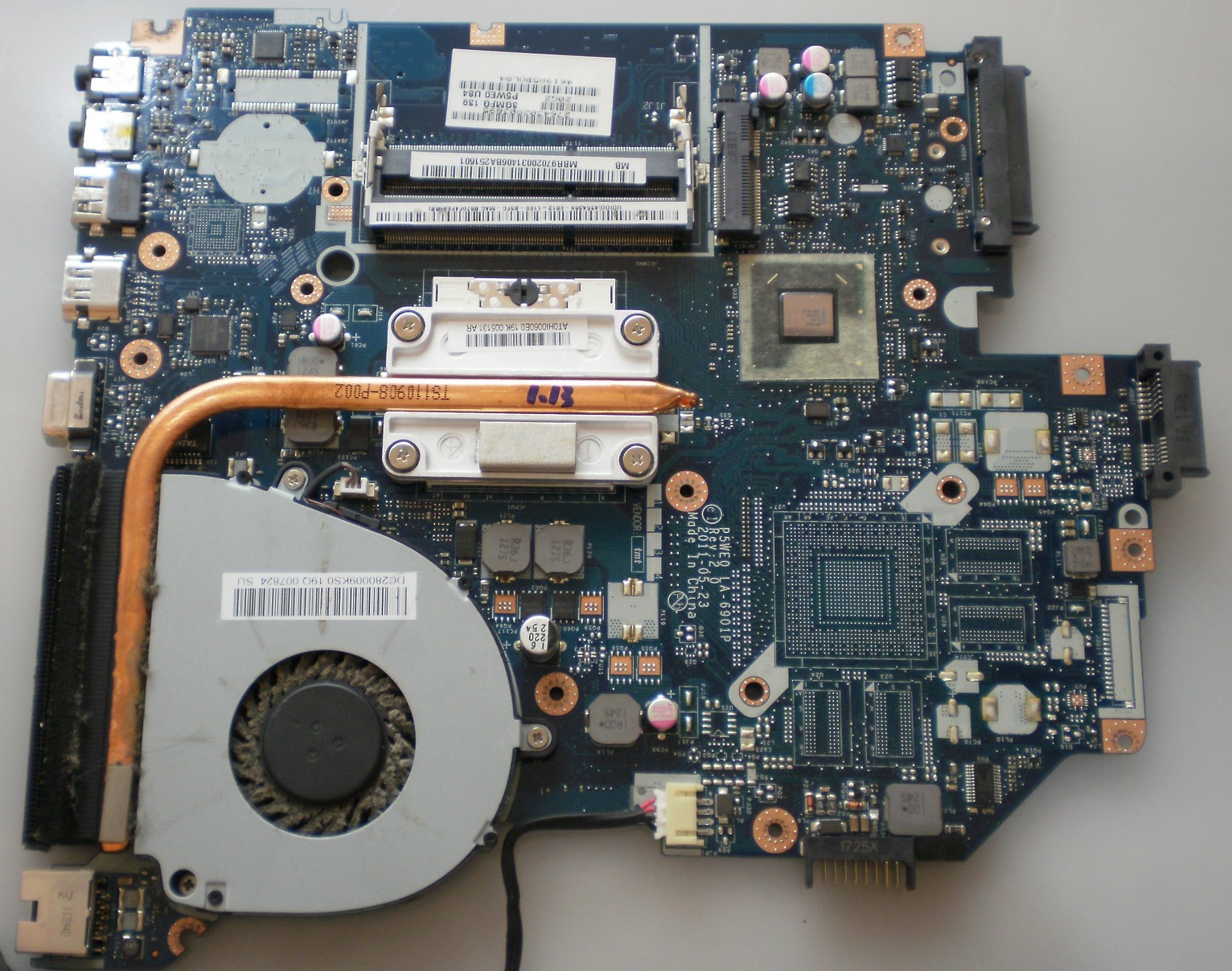

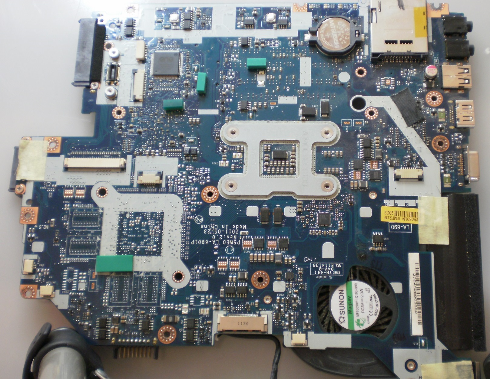

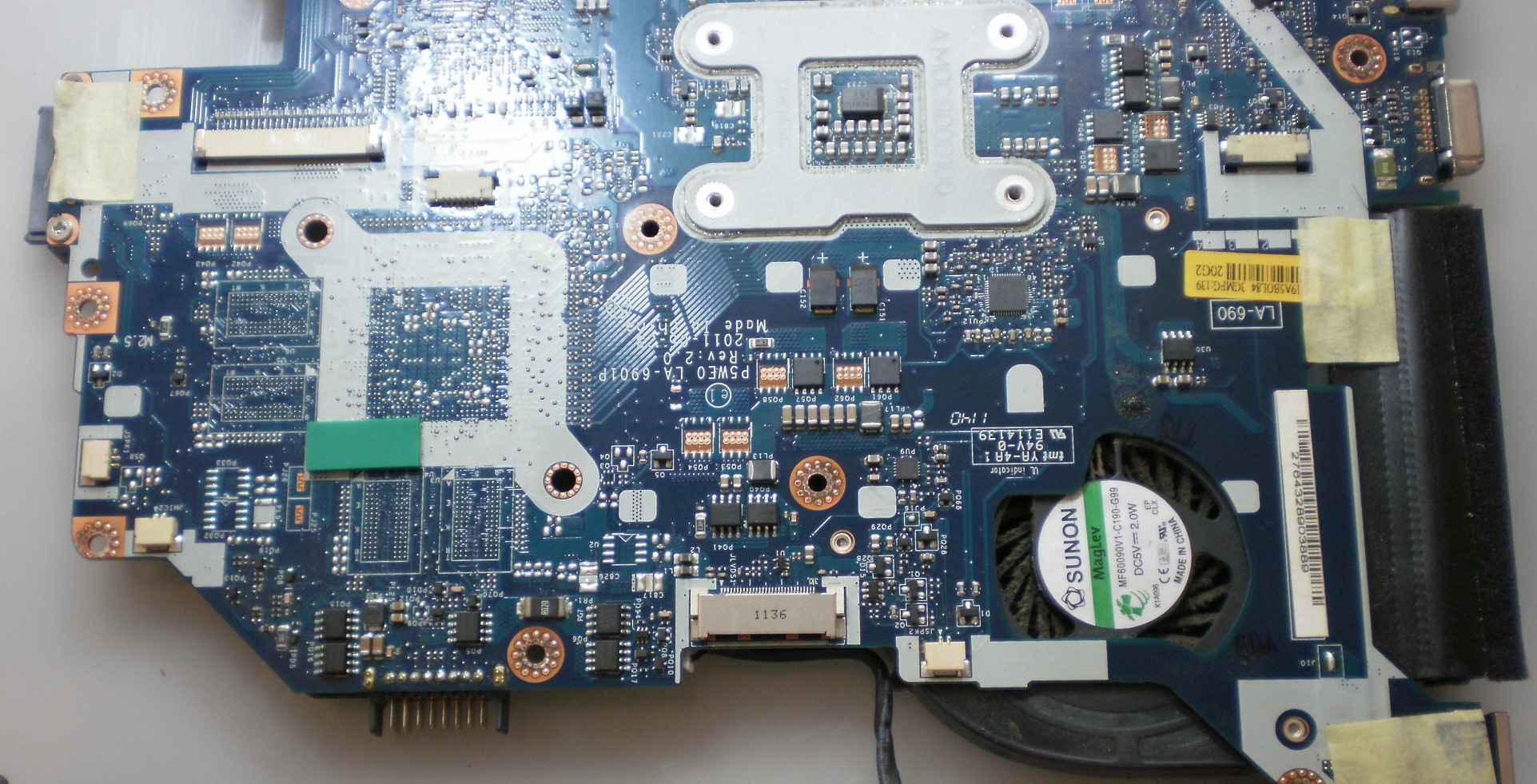

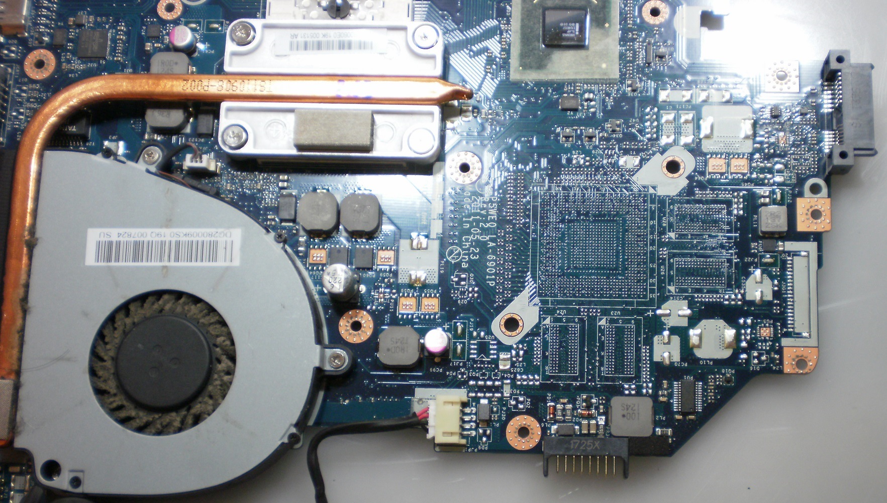

          I have took some pictures:

                    I have done some measurements at the charging IC and there are two FET transitors PQ15 and PG16 and at the PQ 15 I have 19V, but at the output toward the PQ16 I have only 0.7V.

                      First you are looking for VIN (adapter power) past PL1 (page46), then you should check and make sure you have B+ (main power) (PL22 page 47) if any is not present check for shorted or damaged components. start with PQ6, PQ7 then move on to PU1.

                        that means you have main power B+, batt+ will have power when battery is connected. if you connect the battery, do you see a charging light? test PQ16 pins 123 with battery in.

                                With the battery installed, at pins 1,2,3,4 I have 0V. At pins 5,6,7,8, I have 11.11V.

                                  At PU2, I'm measuring the inductor PL5(output from the IC) and there is 0V, so it looks like, I don't have +5V there.
                                  The IC is bad and needs replacing?
                                    Re: Acer Aspire 5750-6845 dead
                                    I don't have 3V at pin #11 and the same thing goes for 5V at pin #20.
                                    I can measure other voltages at the chip. 2V reference voltage is there, there are other voltages there, like 4.5V, 3.1V.
                                    This means that PU2 has to be replaced?
                                      Anybody? I could use some help here.
                                        What do you get at EN pin13? VREG3, VREG 5 should be 3.3V, 5V when pin13 is high.
