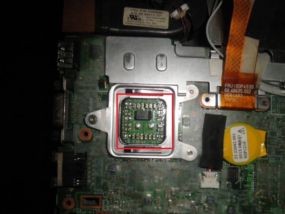

    Hi Guys,
    I have an IBM Lenovo Thinkpad X61, no display, not booting, Power indicator LED only. Its motherboard has a KSNOTE3 MB tag, could you share me the schematic of this MoBo? I've successfully fixed a Toshiba L300 by replacing its OE907 capacitor with 4 330uf 2.5v smd tantalum caps. My X61 MoBo has a tag of 470 84 ph d on it, can you guys tell me this caps specs? is it replaceable also with other types of caps?
    Thanks Guys! More Power!

              thanks! do you know what component is this, 470 84 ph d, that is its top marking. is suspect its a capacitor (smd). i could be wrong.

                      by the way, the attachment above is the capacitor i was asking about. the big black one in the middle.
