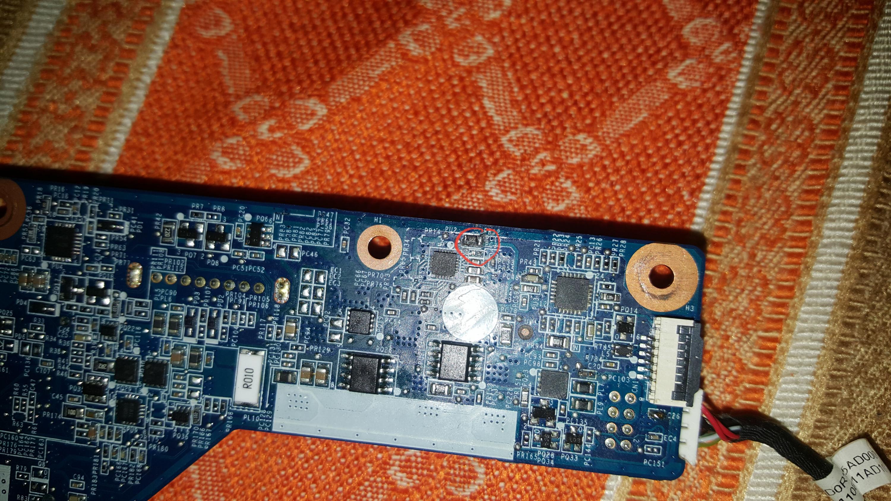

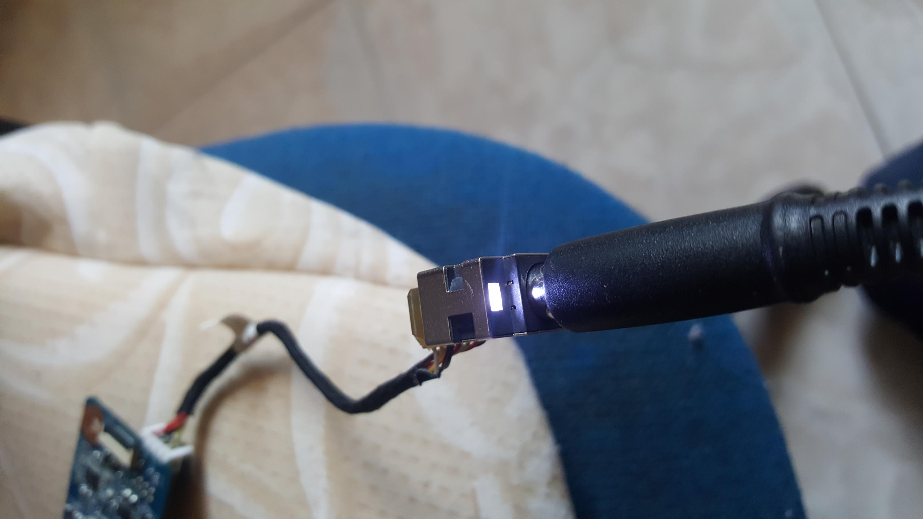

    I changed the resistance and put on a new one ... now it brings me 22.6 ohms the first one I don't know why but it had risen to 23.8 ohms ... but the problem remains the same ... the connector led turns on but the pc no ... I measured the inductors with the tester but no one gives me value ... isn't that the cap that I removed pc16 serves?

      Just a stupid question.. Did you press the power button?
      I assume that the led comes on as soon as you plug in AC?
      What happens when you press the power button?
      There have to be at least 3.3v and 5v on two coils. Or else nothing would work. Also no led's would light up.

        hehehe ... of course I pressed the power button ... but the only LED that lights up is the one on the connector

          Does anything happen when you press the power button?

            nothing happens no other led access the processor fan doesn't even turn ...

              how is it possible that these inductors do not arrive current ??? what could i verify?

                KvnTM if I try to measure that mosfet pq52 that indicated in the post 1 loser18? given that he also gave him no value

                  I tried to test the mosfet pq52 pin 1 and pin 3 brings me 19 volts I can not understand why the inductors do not bring me value ... what could I measure and control please :-(

                    pc59 at the touch with the finger turns off the connector led
