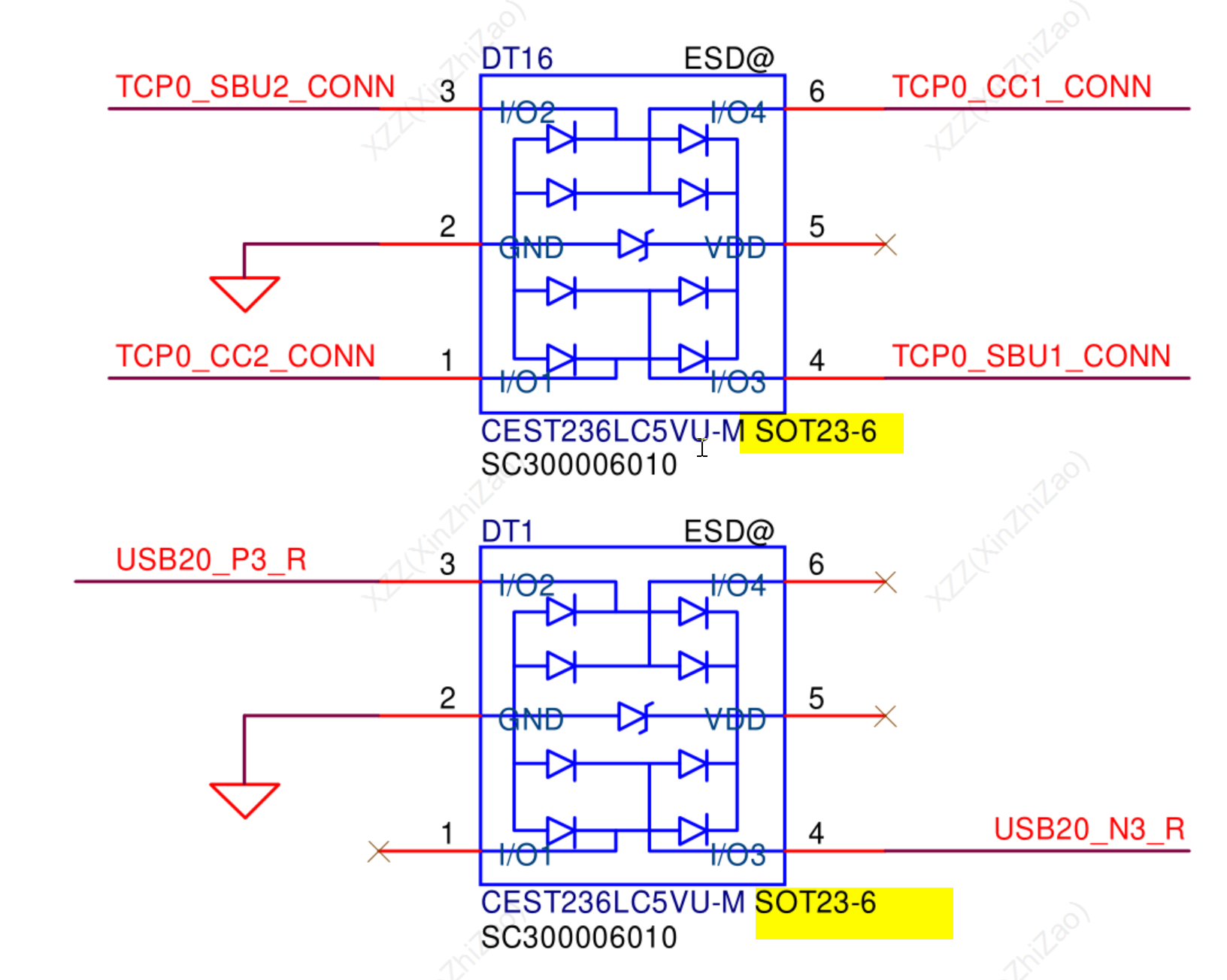

    Thanks for all the great information mon2! The board has been out for all my testing. I just plugged it in and tested....it now powers up on both sides of the usb c! I'm not sure yet if the other problem may be fixed as well. That being it operating and charging with both the battery connected and usb power adapter at the same time. I probably need to reassemble and test for that to see if its fixed too. But, its great to see this working now. So, what do you think I should do going forward? You think to risky to leave off and reassemble and send back to the customer. Or should I try and locate the replacement part? Maybe it's not even available. I haven't checked ebay or Digikey yet.
      Good job! See attached. This ESD device is a SOT23-6 package.
      Here is a part that is suitable and will be a drop-in replacement for the above defective ESD suppressor:
      TPD4E001DBVR Texas Instruments | Circuit Protection | DigiKey
      While the board does not require the use of these parts, they are recommended. Transients from the 'outside world' of the logic board, are very common and can nuke this board again. Without such a component, the logic IC(s) will receive the spikes. Becomes much more expensive to repair if that should happen.
        Thanks so much mon2 ! You've been a Godsend, thanks for all the help. I'll let you know any updates and how it goes from here.
          Hello mon2....Hey, I just want to let you know that I did order the part from the link you sent me. Thank you! I got it in and installed it, Re assembled the laptop and tested it. Everything works now! Evidently that part was also causing issues with the battery and adapter. That being the adapter wasn't charging the battery either. Thanks again!!

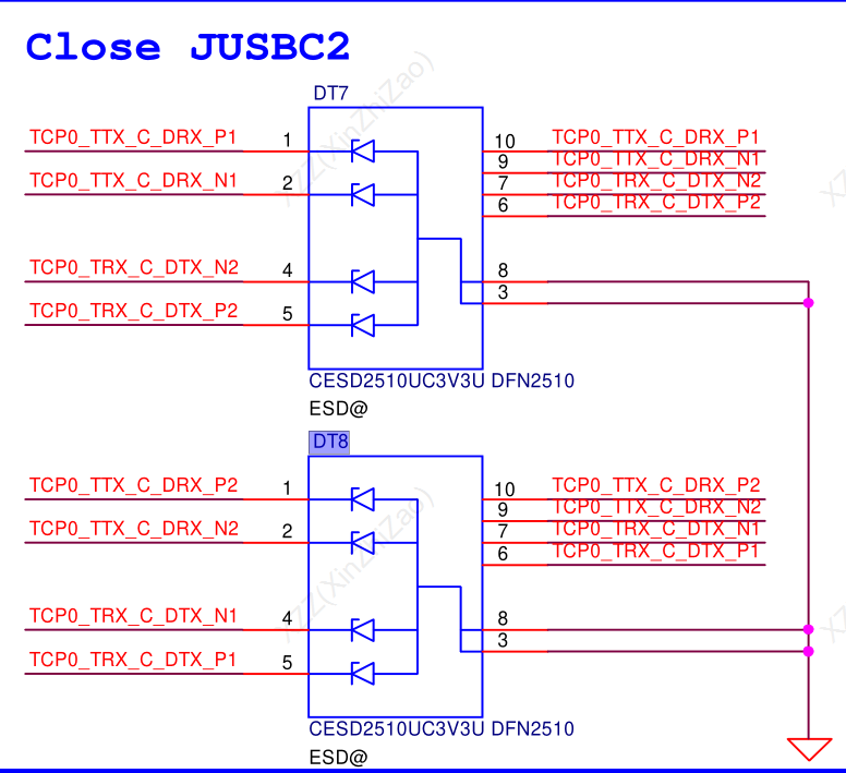

                    See attached for the ESD array @ DT8
                    DT8 = CESD2510UC3V3U
                    Datasheet:
                    2009171509_CREATEK-CESD2510UC3V3U_C575940.pdf (lcsc.com)
                    This is a very common footprint ESD protection device available from assorted vendors including Texas Instruments / SOCAY, etc.

                    * see my post # 10 for details on other parts that can replace this one

                      just chiming in to say I had a similar fault, no power at all from the charger. DT16 was shorted gnd to vdd , DT1 had no apparent issues but removing both was needed. ill order some new ones but in the mean time its back to life.
                      this was caused by a dead DELL charger. one "flash" on the charging led as soon as i plugged in and no more charging since.
                      somehow using a powerbank which only gave 20W at 12V allowed it to charge slowly? althought only when laptopt was OFF.
                      Its like it didnt need to communicate , really confusing stuff.
                        #31
                        Thanks for your feedback. It is nasty how a simple low cost device can cause the logic board to fail. As noted, there are assorted crosses for this part from various manufacturers. You can probably source through Digikey / Mouser / Arrow, etc. in addition to Aliexpress.
