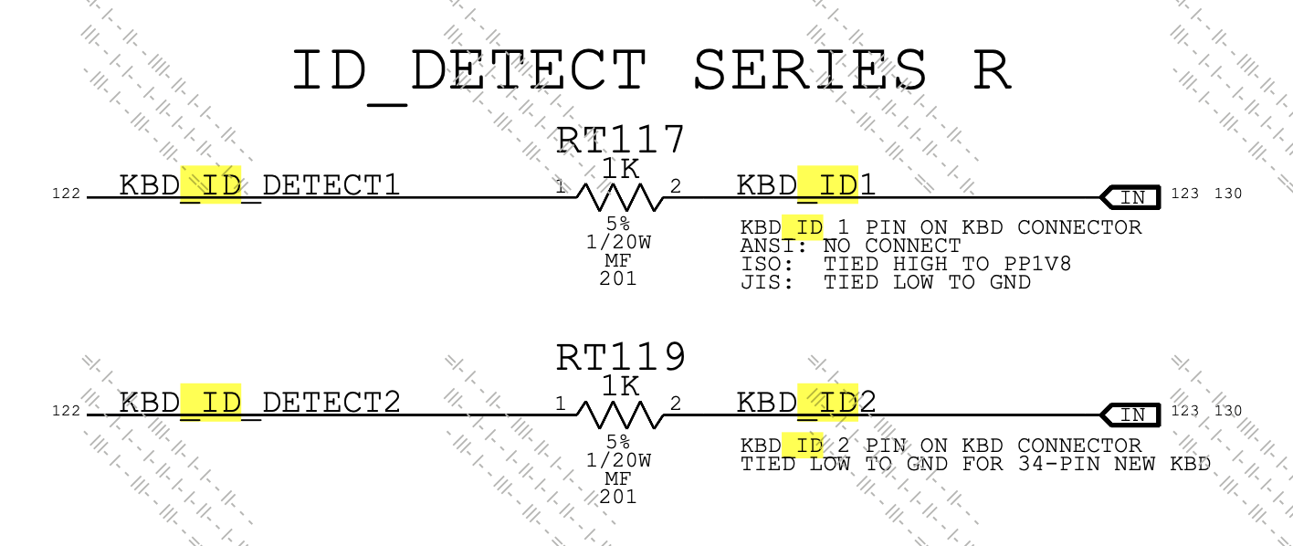

    I encountered a similar issue on A2442.
    I have an A2442 that originally came with a JIS keyboard and intended to swap it with an ANSI US keyboard. After the switch, I discovered that the identified keyboard layout remained JIS. After reviewing the schematics, I found there seems a mechanism to automatically identify the keyboard layout (KBD_ID1, see attached screenshot). However, for some reason, this mechanism didn’t work even after a full DFU restore.
    I have another A2442 that shipped with a US ANSI keyboard. I compared some other ID bits, including BOARD_ID[5:0] and BOARD_REV[3:0], and both of them are identical...
    Have you resolved the issue? I believe the only way I can try is to flash the SoC ROM with the dump from the A2442 with the US keyboard.
