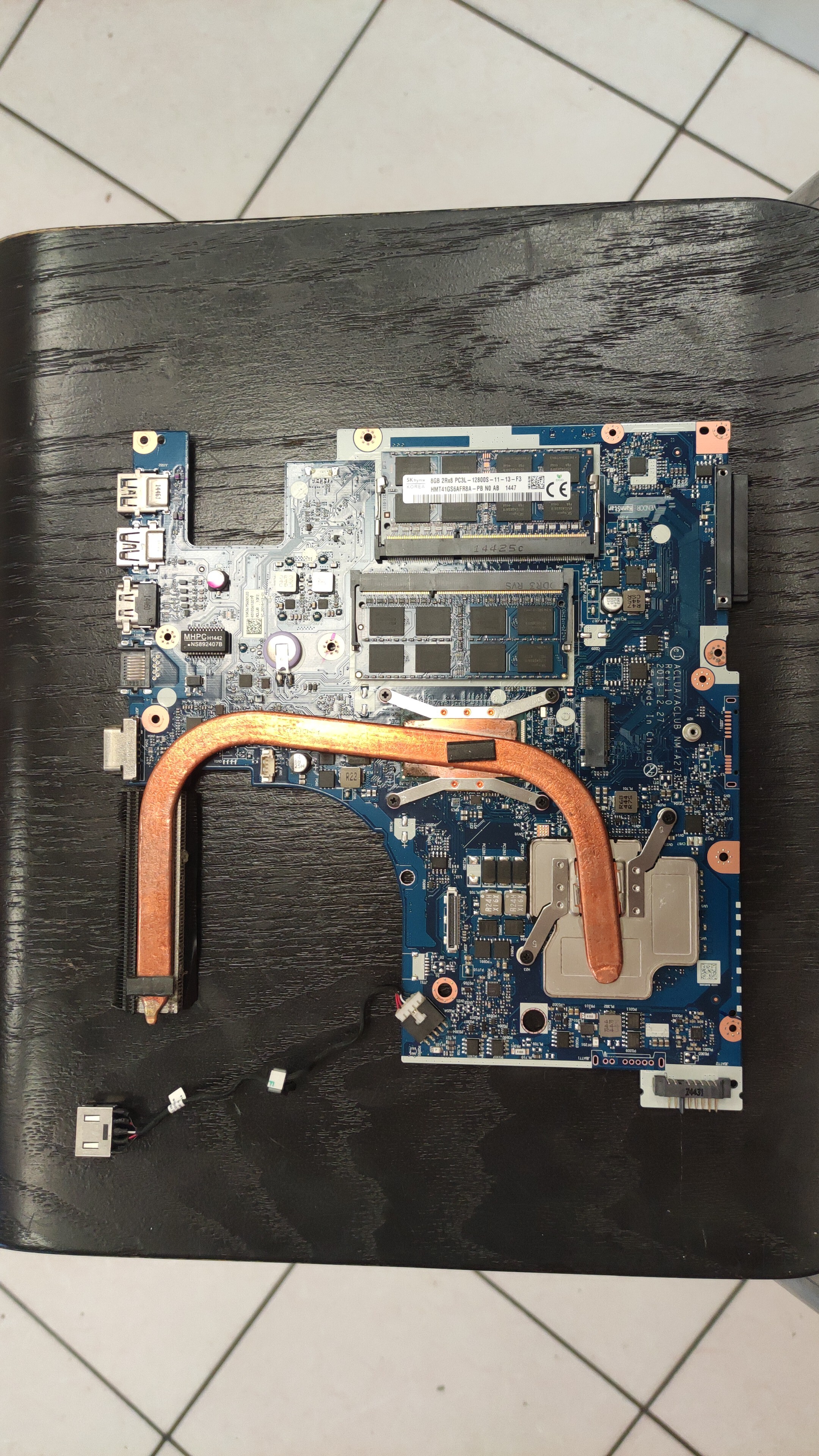

    Hi, I have this laptop, it is completely dead, no charging light when connected to a working charger.
    Can anyone help me with some hints for troubleshooting this laptop?
    Thanks in advance

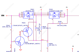

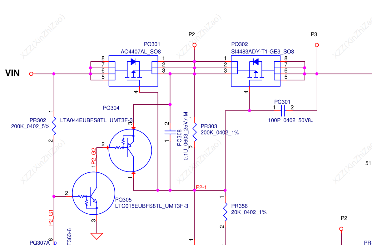

    See attached. Measure and post the voltage to ground of the DCin mosfets @ PQ301 / PQ302. Source / gate / drain pins.

      PQ301
      pin 5-6-7-8=19v
      pin 1-2-3=19v
      pin4=19v
      PQ302
      pin 1-2-3=19v
      pin4=19v
      pin5-6-7-8=PR301=voltage is fluctuating fron 2v to 19v, the board makes a clicking sound each time the voltage value changes
        Replace PQ301 and test again.
          PQ301? isn't PQ302 failing with voltage?
          ok I'll replace PQ301 and report
            hi, PQ301 replaced, still not working, same values and still same clicking sound (unable to understand which component is making that sound)
              Remove all power. Meter in resistance mode. Measure the resistance to ground of PQ302 (drain pins 5-6-7-8). This is the main power rail. What is the resistance measurement?
              The clicking sound will be from a local switching power supply that is pulsing on / off and the switching frequency is being heard by yourself. The power supply is pulsing because the mosfet driver (charger IC) is sensing a higher than normal current draw so powering down this main voltage rail. The cycle repeats once it is OFF - aka chirp mode of power supplies.

                  What is the voltage to ground of the gate pin # 4 of PQ302? Is this a stable 19v to ground?
                  Remove all power -> meter in resistance mode. Measure the resistance across this mosfet's pins:
                  source (1-2-3) & drain (5-6-7-8)
                  source (1-2-3) & gate (4)
                  gate (4) & drain (5-6-7-8)
                  With the gate pin @ 19v on this N-channel mosfet, this mosfet should be OFF. N-channel requires a boosted voltage and it should be higher than the voltage being passed between source / drain pins.
                  Checking to see if this mosfet is shorted or not through the resistance checks. A good mosfet should have high resistance readings for each of the above permutation checks.

                    gate pin #4 of PQ302 is 19v but not stable. sometimes goes down to 16v
                    source (1-2-3) & drain (5-6-7-8) open circuit
                    source (1-2-3) & gate (4) open circuit
                    gate (4) & drain (5-6-7-8) open circuit
