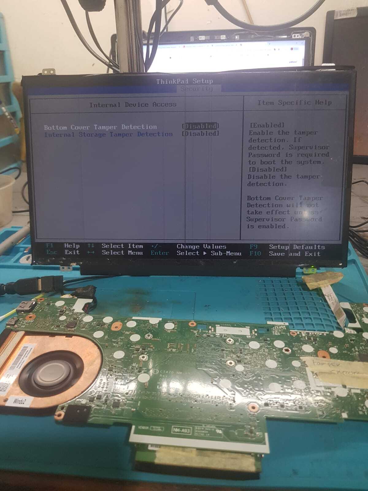

          thank you sir for your help, yes this case is very strange sir still the tamper error, I have checked the bios security position is disabled, thank you Click image for larger version
