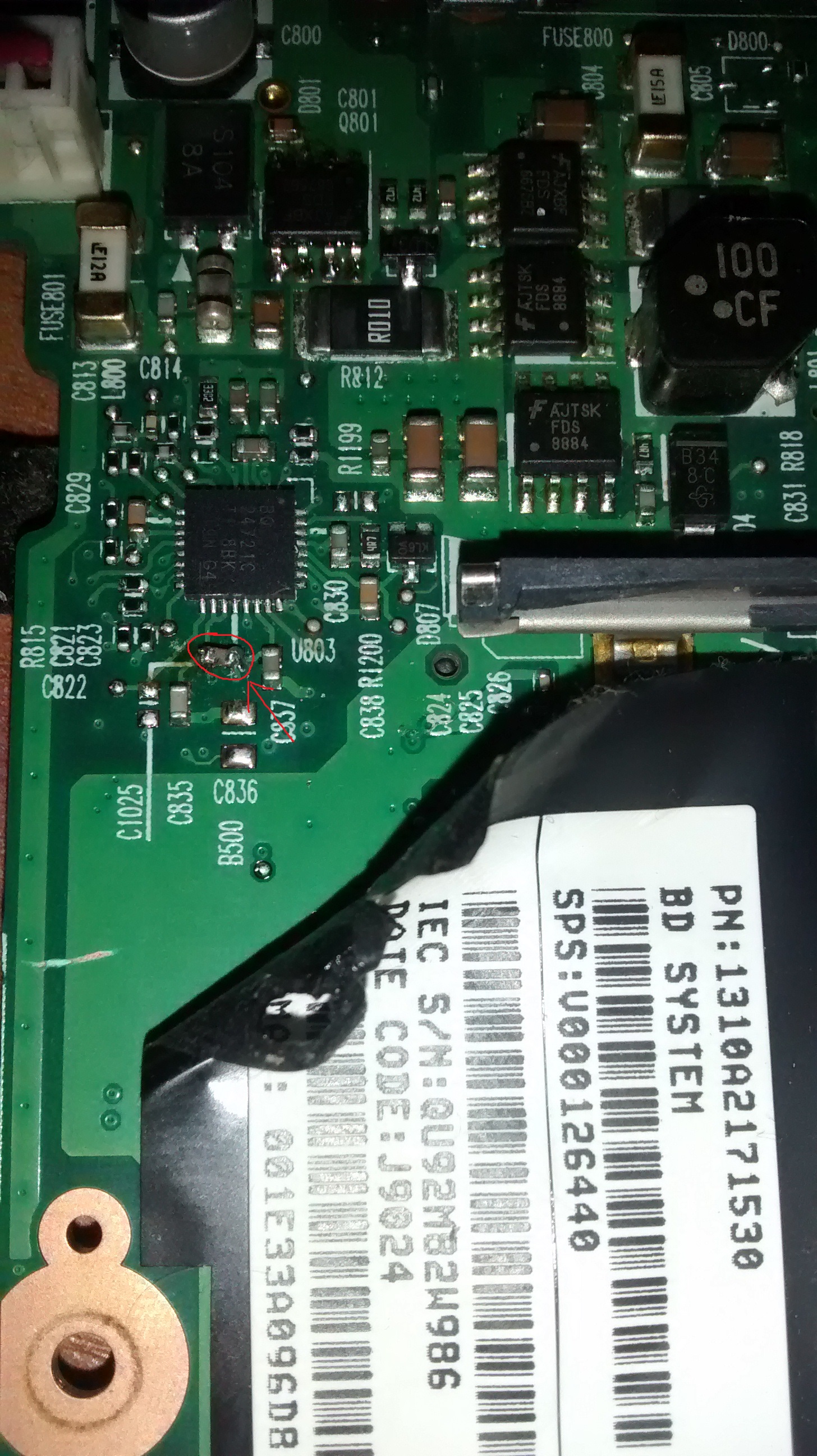

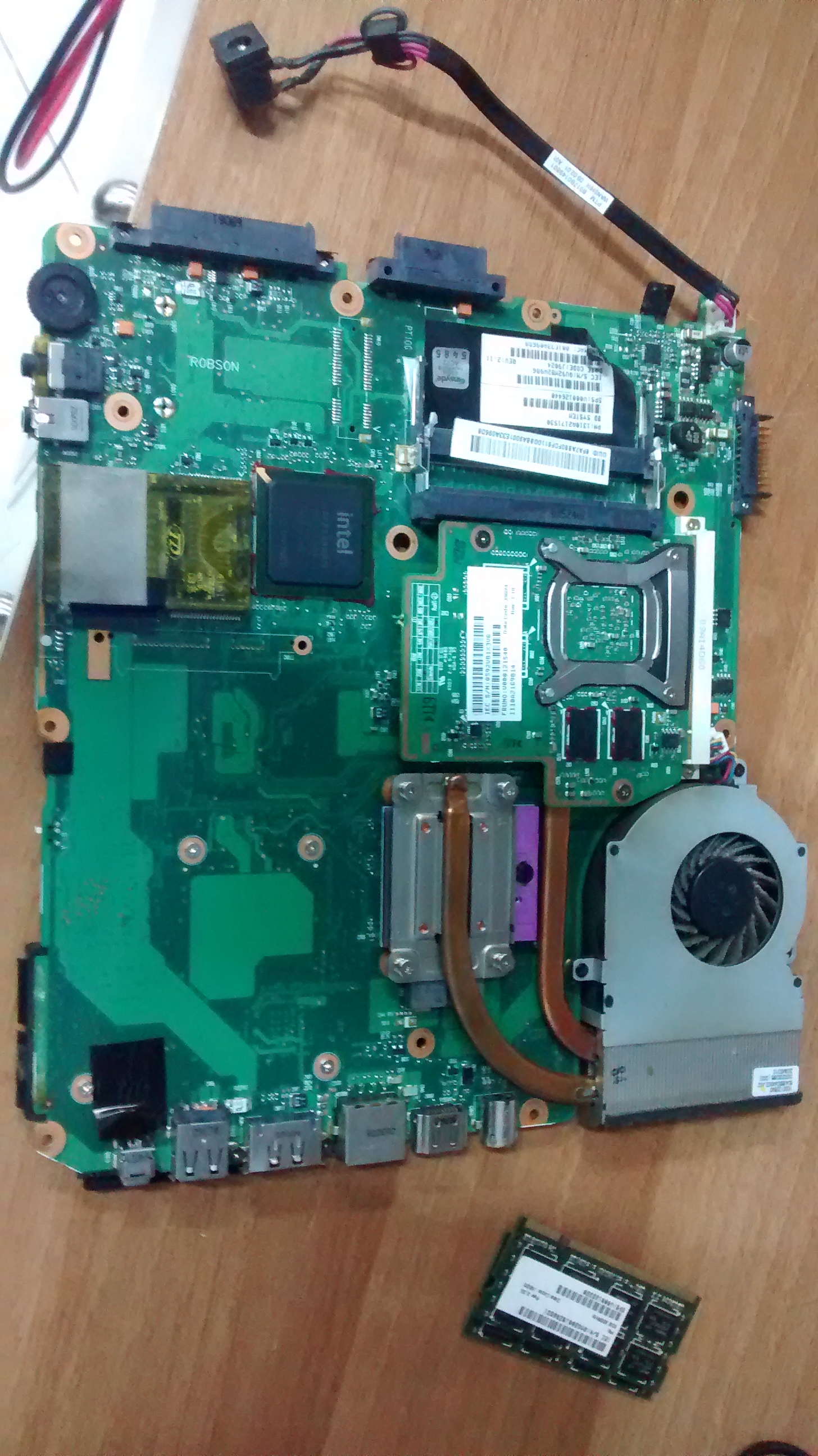

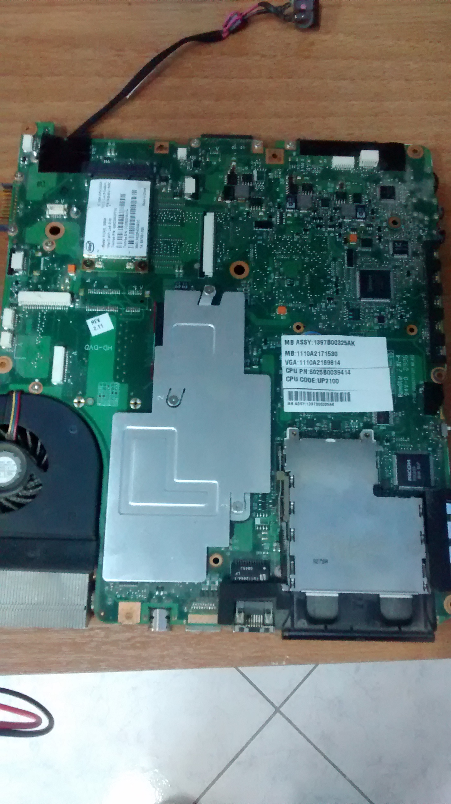

I have a strange problem with a toshiba a300-20w. When I check voltage in dc jack the reading is 2.5V
I changed the dc adaptor and still the same reading. If I remove the jack from the motherboard and check the reading in the dc jack pins the voltage is 19,5V.
I suppose I have short circuit in acomponent but I can't find it.
I found a short capacitor(picture 1) but when I remove it and measure the to ends where the capacitor was on board it still shows short.
I cant find a decent schematics.
If someone can help me.
