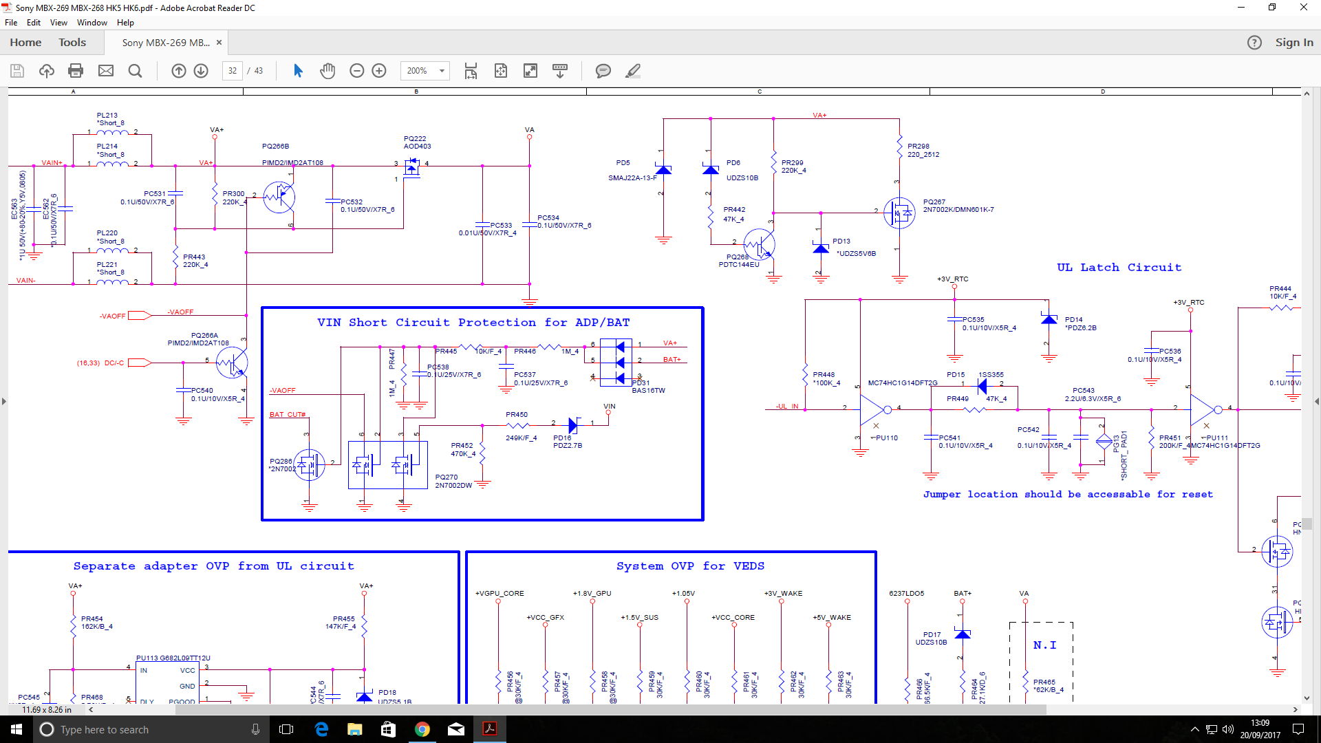

    As per topic I have sony laptop having mobo mbx-268. It works on battery only , when adapter is plugged it shutsdown down instantly. No Charging, no power.
    No shorting found.
    Changed charger IC.
    Can anybody help me to short out.

    Hi
    How is the voltage on PR265 when plugged in the Charger without Battery
      Re: sony vaio works only on battery
      Have a look at this
        get a multitester, try to test the output voltage of your power adapter if it has enough power , like, 19vdc or 20vdc..
