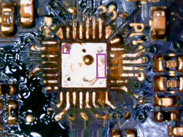

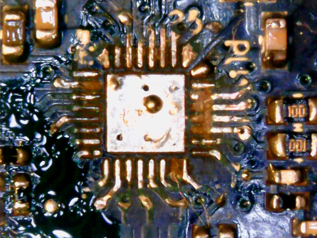

Screwed up big. Missing Pads on 4x4mm Chip
  • Pferd5
    • Mar 2018
    • 68
    Screwed up big. Missing Pads on 4x4mm Chip
    Damn. I thought I could do it but I was wrong.
    I try to repair a Board und while all the take off put on precedure some Pads got lose and came off.
    Pin 2 and (18) 19,20,21,22
    Pin 15 is not connected.
    Can someone give me some kind of recommendations what to do / I can do?
    (And why is this message und reply box so damn weird? It highlights and flickers while typing)
  • MJ-meo-dmt
    • May 2016
    • 186
    • South Africa
    Re: Screwed up big. Missing Pads on 4x4mm Chip
    Patience.Patience.Patience.Patience.Patience.Patience.Patience.Patience.Patience.
    Its not that bad, it could have been much worse. Anyways do you have a thin tip soldering iron if yes great. Do you have Patience? Yes?
    Seat the "NEW" IC onto the pads that are still okay. Without making it worse. (Using hot air I hope) and some liquid flux. (plenty of flux)
    Get some thin copper wire like the ones you get on some transformers, coat 2-4mm with solder, grab a magnifying glass and then sit and attach them. one at a time trying to not touch two pins because you will probably have trouble cleaning that.
    The way I do it is to line the copper up with the pin *straight* then attach the copper to the pin first and then quickly to the trace. This way will require you to keep the copper straight and still because heating one end will heat the other end at the same time...
    Another way would be todo everything with the iron. First lay down the missing traces extending them from the bits that are left(from the broken ones) and then attaching the IC back on doing pin by pin. But I found this way to only work on ICs where the pins are exposed on the side like a EC.
    Either way you will have to make new "traces" how you do that is up to you really. Use thin copper wire, also keep in mind that you can't go too thin, some traces require a a certain thickness.(High current ones for example)
    Good luck.
    Last edited by MJ-meo-dmt; 11-07-2018, 08:57 AM.
    while alive { live(toFullest=true) }
    • Pferd5
      • Mar 2018
      • 68
      Re: Screwed up big. Missing Pads on 4x4mm Chip
      there a several problems.
      I have the new TS80 and only the one big tip (like 4 Pins width).
      Hotair is available.
      some chinese 0.1mm wire is also available. (isolated)
      The Chip is a BQ25700 which has no pins coming out, they are just on the side. like this:
      Thin wire stuff is not recommended I guess, as its the chargeing controller. I thought to repair it with some copper sheet, kapton tape and epoxy. - But I've never done this before, so I think it will not be an easy job or won't work at all (lack of experience).
      I thought about creating new pads (attached to kapton tape, solder with lead free solder, place with epoxyand solder the chip with leaded solder.) - in think it will work in theorie but this is all so damn small. like 2pins on 1mm.
        • 21444
        Re: Screwed up big. Missing Pads on 4x4mm Chip
        The 0.1mm wire is ok for that size qfn and pads. You can use thicker wire,as suggested already from a transformer, or a coil. You can flatten the end of thicker wire down with a vise or pliers to make a pad .Get the smallest tip you can get for that iron .
          • 31144
          Re: Screwed up big. Missing Pads on 4x4mm Chip
          dead-bug method IMO.
          • tibd
            • Oct 2014
            • 189
            • Sweden
            Re: Screwed up big. Missing Pads on 4x4mm Chip
            if u r ready to send it to Sweden with prepaid return postage I'd gladly fix it for you free of charge. Otherwise dead bug method as suggested above.
            • ktmmotocross
              Boardkiller
              • Feb 2014
              • 3616
              • slovakia
              Re: Screwed up big. Missing Pads on 4x4mm Chip
              not so hard.
              try to wire missing paths under gpu
              use that thin wire, the big pad is for cooling so with thick wire it be bad for connecting to cooling pad
              Last edited by ktmmotocross; 11-07-2018, 12:05 PM.
              • Pferd5
                • Mar 2018
                • 68
                Re: Screwed up big. Missing Pads on 4x4mm Chip
                currently I may would go with the option to ship it to sweden.
                I just don't want to make it worse and with no smaller tip I just can't do it.
                Thanks for the help so far. I will reply when I finaly decide what to do.
                • Troystain
                  Help EZP2023+ updated chip database for w25q256jveq?
                  by Troystain
                  Hello, anyone here have updated ezp2023+ chip database in .dat file format.
                  I need to add w25q256jveq chip but I do not know what data should I type.
                  I'm using the ezp chip dabase editor posted from here https://www.badcaps.net/forum/troubl...ro-programmers
                  The currenty unit model that I am trying to detect is HP elitebook 640 g9 which is currently locked on admin bios....
                  11-25-2024, 12:53 AM
                • mikay786
                  820-00138-A - Advice on how to fix corroded missing / pads
                  by mikay786
                  Working on this a MacBook i purchased, has some corrosion around what according to the schematic is SSD CURRENT SENSE circuit. I've got 3 missing pads
                  The pad left side of R3742, where would be best to run a jumper wire too?
                  I assume the other 2 missing pads should be simple enough with top C3701 pad which appears to be connected to the other components on the same plane. Pad on right side of R3742 just need to make sure is connected to trace.
                  Mainly struggling with left pad of R3742 and where to run a jumper, maybe a via as appears to go to multiple...
                  12-20-2023, 07:14 PM
                • acedogblast
                  by acedogblast
                  11-02-2024, 05:13 PM
                • DynaxSC
                  ASRock B650M PRO RS - BIOS CHIP 25Q256JW BLOCKED BY STATUS REGISTERS
                  by DynaxSC
                  Hi
                  I have a very strange issue with the BIOS SPI chip of an ASRock B650M PRO RS motherboard.
                  The SPI chip is an Winbond 25Q256JWEQ model (1V8).
                  The motherbaord doas not POST - it lits only CPU and DRAM EZ Debug Leds, and stays that way forever.
                  The Flashback function of the motherbaord is also not working, despite all instructions followed correctly - I'm 100% sure of this.
                  I have then desoldered the chip, backupped the contents, and tried to earease the chip in order to program stock image, but the chip is locked by status registers SREG2 (TB) and SREG6...
                  08-04-2025, 12:20 PM
                • inck243
                  Acer e15-e5-576g-5762 bricked. Bios chip won't interface in AsProgrammer.
                  by inck243
                  Thanks for any help. The board version is DAZAARMB6E0 REV: E. The bios chip is winbond 25Q64JVSIQ1736. W25Q64JV is not available in AsProgrammer -- only BV CV FV or FW_1.8c. The chip won't interface with asProgrammer and a CH341A. When I have this chip on the board, the laptop will not post but when I plug it in to power, the blue LED lights up, also the orange when the battery is connected. When I push the power on button, keyboard backlight turns on and the fan starts briefely then turns off. But I can't do anything to program this bios chip so I bought another one.
                  The BIOS...
                  07-25-2024, 09:17 AM
