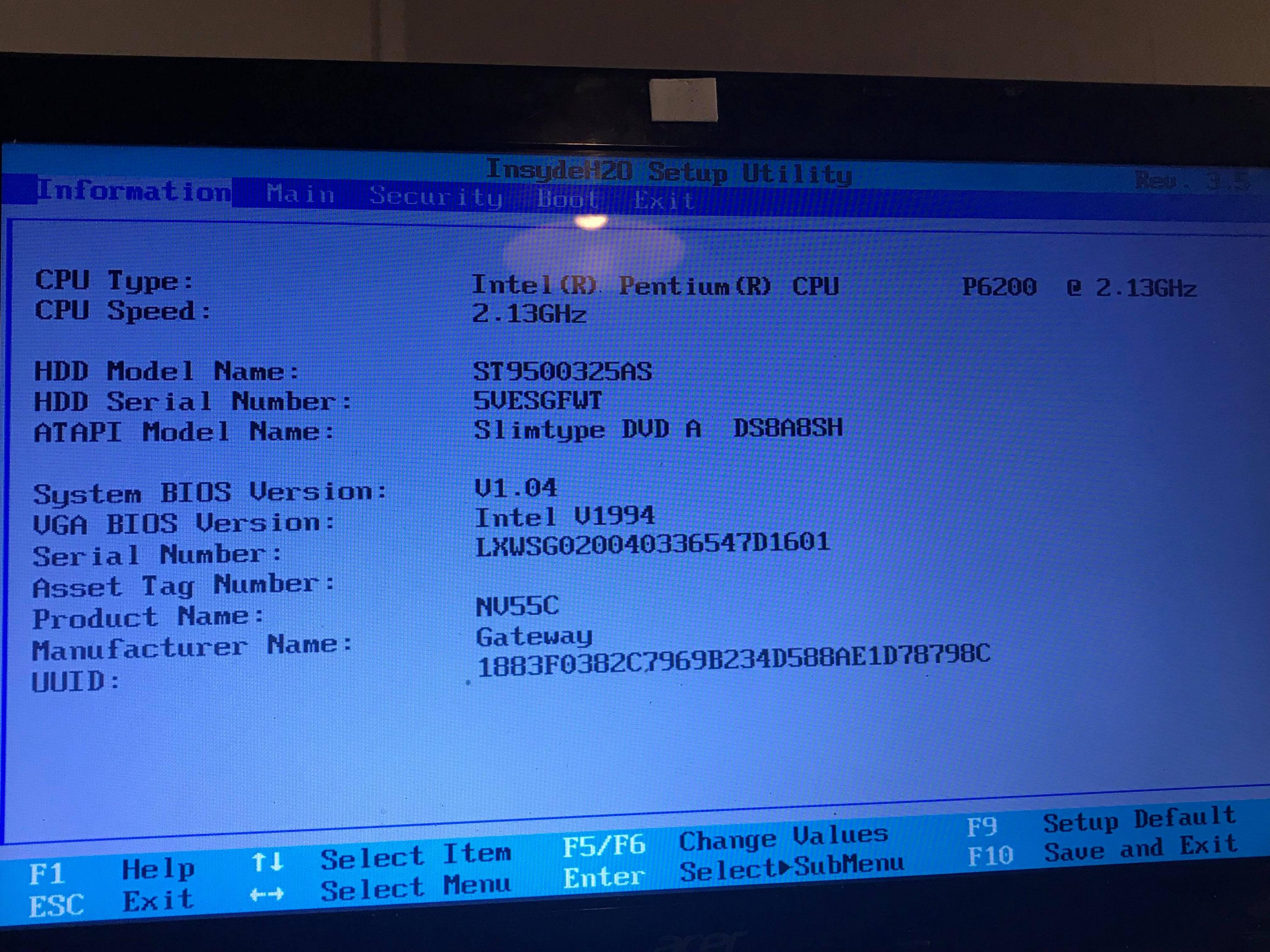

    Hello I have the computer of a client I can not determine the problem!
    I tried to flash the bios no results
    they boot and we go directly to Linux boot then this cut after 2 min :-(
    I placed a video

    could be faulty RAM.

        thank you for your quick answer, I already try with another ram, it will not work

          you have a .bin file for the model I placed

              I flash u18 and u31 it still does not work
              (U18) MX25L1005A.bin
              (u31) W25Q32BV.bin

                Can you try with a different Bios in the forum
                Did you try with a different processor & RAM ?

                  I already tried
                    Re: Acer 5733 (pew71 LA-6582P) more bios at startup
                    may be ME Regina cause to shut down? Some one else can help?

                        I dont think so-me region issue. Should,nt cut off after 2mins. Though possible but very unlikely. Some thermal trigger may be

                          I buy a motherboard on aliexpresse
                          mes I really like that we repair all the motherboard together can help people

                            Hello here I have installed the new motherboard
                            * the bios nikel :Roche:
                            Now there is more sound!

                              That looked and sounded like a CPU thermal cutoff. (the YT video)
