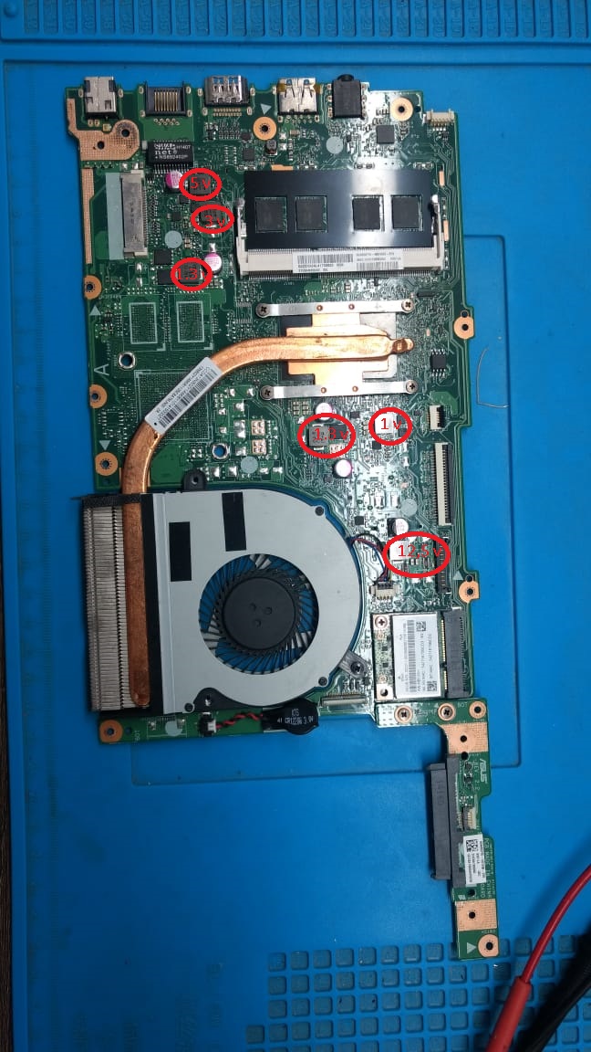

    Hi Guys, now my asus s301l is turning on by it self and no video, can any help me, RAM is integrated and i think that´s is the problem plisss helppp.
    I already have voltage measurements, I have the 3 and 5 I need, I do not have schematic or dump of the bios, without external video output, I am antentosi I need to make some other measurement, or if there is a way to disable the internal memory.

    voltage on all big gray coils CPU CORE , GFX ,RAM take a pic of the Mob both side and make the voltage uplode make a request on Schematic for the boardview

          what is voltage of bios battery without power? its more than 2.5V ?

            Bios baterry whitout external power 3v, whit power 3.2, fan is working, bios voltage 3.2, add picture from board and values, going to reprogram bios andd help me please

              now, i did reprogramed bios and now is working thx for everything
