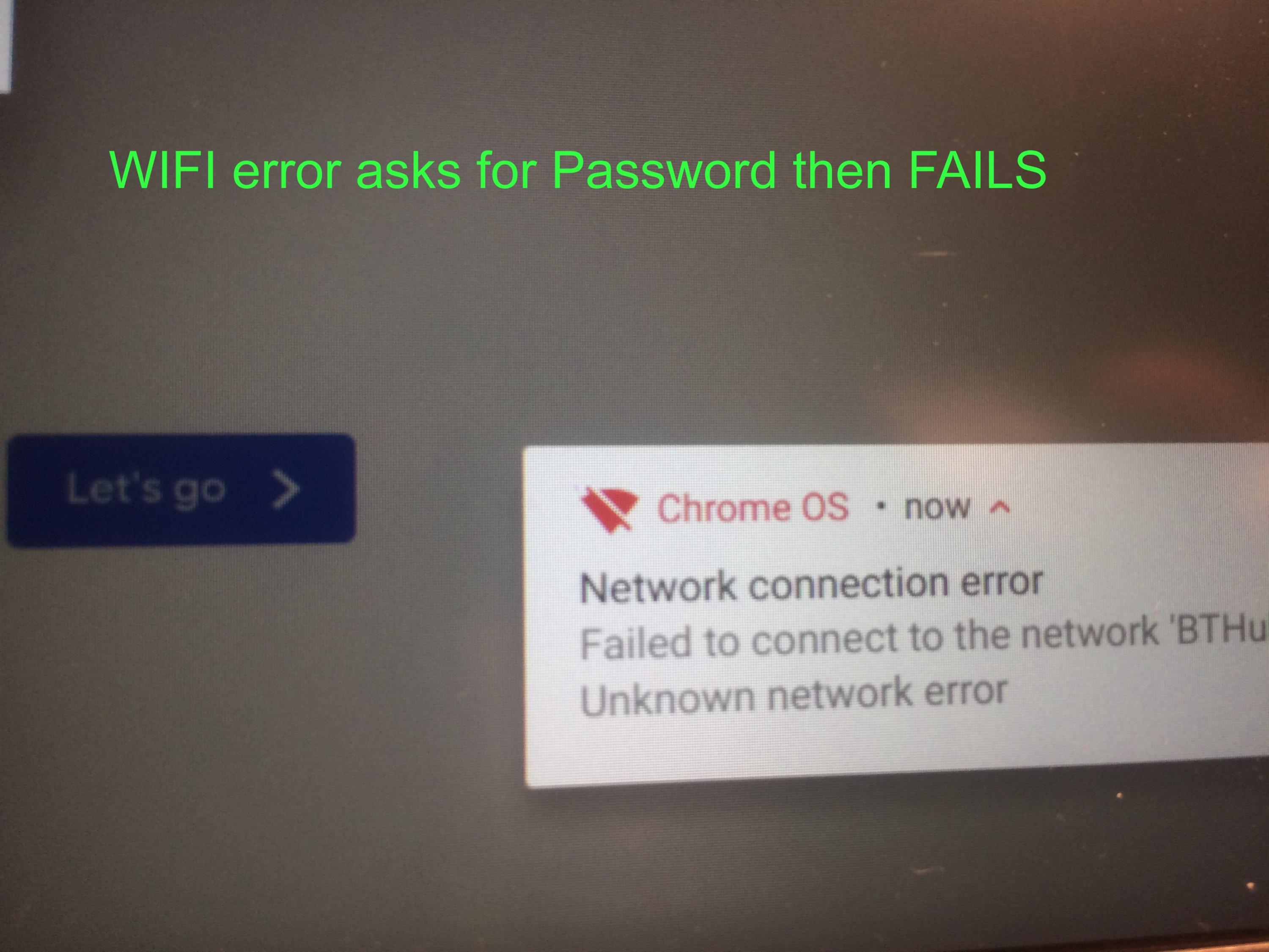

    I replaced MEC1322 and now 3.3v line measures high like 900 ohms. But still no touchpad and now wifi sees networks but will not connect, says 'Unknown network error' after requesting password, tested on multiple networks.
    I cannot find any other faults, 3.3v is going to the touchpad, I tried a touchpad from another Acer CLoudbook, that didn't work but had same ribbon cable, I do not know if it is compatible. Maybe I need to buy the same touchpad off ebay.
    Any suggestions as to why the wifi no longer works or what else I can test for, for the touchpad. I cannot see anything in the MEC1322 datasheet about wifi so I find it strange that now it does not work after changing this, even though it requests password and then fails!!

    I also factory reset it, made no difference to wifi.

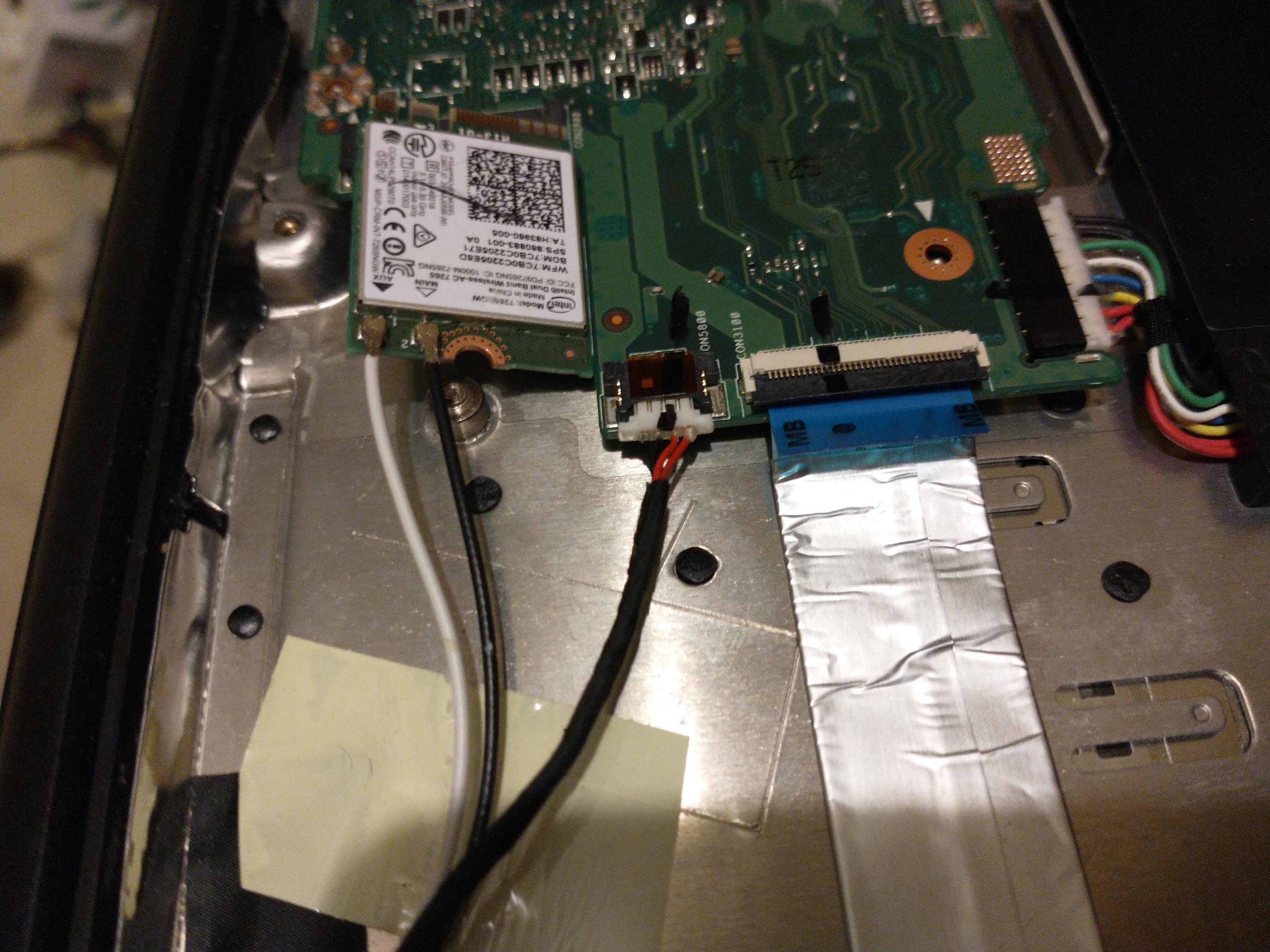

        Got a similar issue on the voltage frying things I believe. Cb3-431-c0ak
        Afraid I can't help too much on touchpad, but I registered to reply on the wifi one that I'm pretty sure my black and white cables are reversed....of course this happened and then I reread and saw you are somehow detecting networks, so
        Appreciate your photos, gives me some stuff to test and ... possibly find on ebay!
        *And zooming in, a different wifi chip!

          Hi there, so indeed the problem was that I did not replace with the same wifi card that shipped with the laptop. The one you see in the photo was from another Acer. I was confused since it could see networks. I presumed it was an all or nothing affair with wrong drivers. As it is a Chromebook you cannot change drivers. So Wifi is working now I bought an identical one off ebay. I have never seen a laptop where swapping the antenna made a difference since they are the same when you look at them in the screen assemblies.
