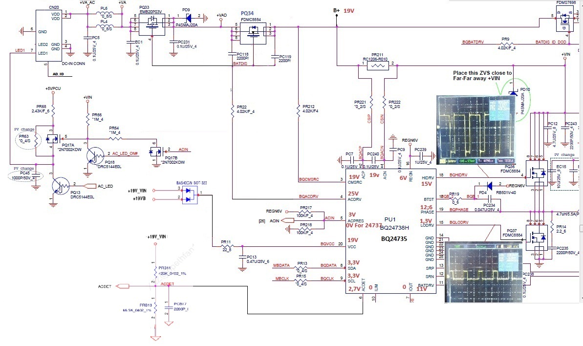

    Pls the charging IC bq736 hidrv and lowdrv give 1.3v
    I don't understand is it correct or it suppose to be 3v... The system am working on is hp 640

              What is the solution if the voltage on the + battery pin is 19volts, but the battery is not installed?
                #67
                This will probably be that the high side battery charge MOSFET is defective. The high side and low side mosfets switch on/off to lower the main power rail voltage to charge the battery. Remove all power. Meter in resistance mode. Test the resistance across the MOSFET pins:
                Source / drain
                Source / gate
                Gate / drain
                Each resistance must be hundreds of k ohms or higher else the mosfet is defective.
