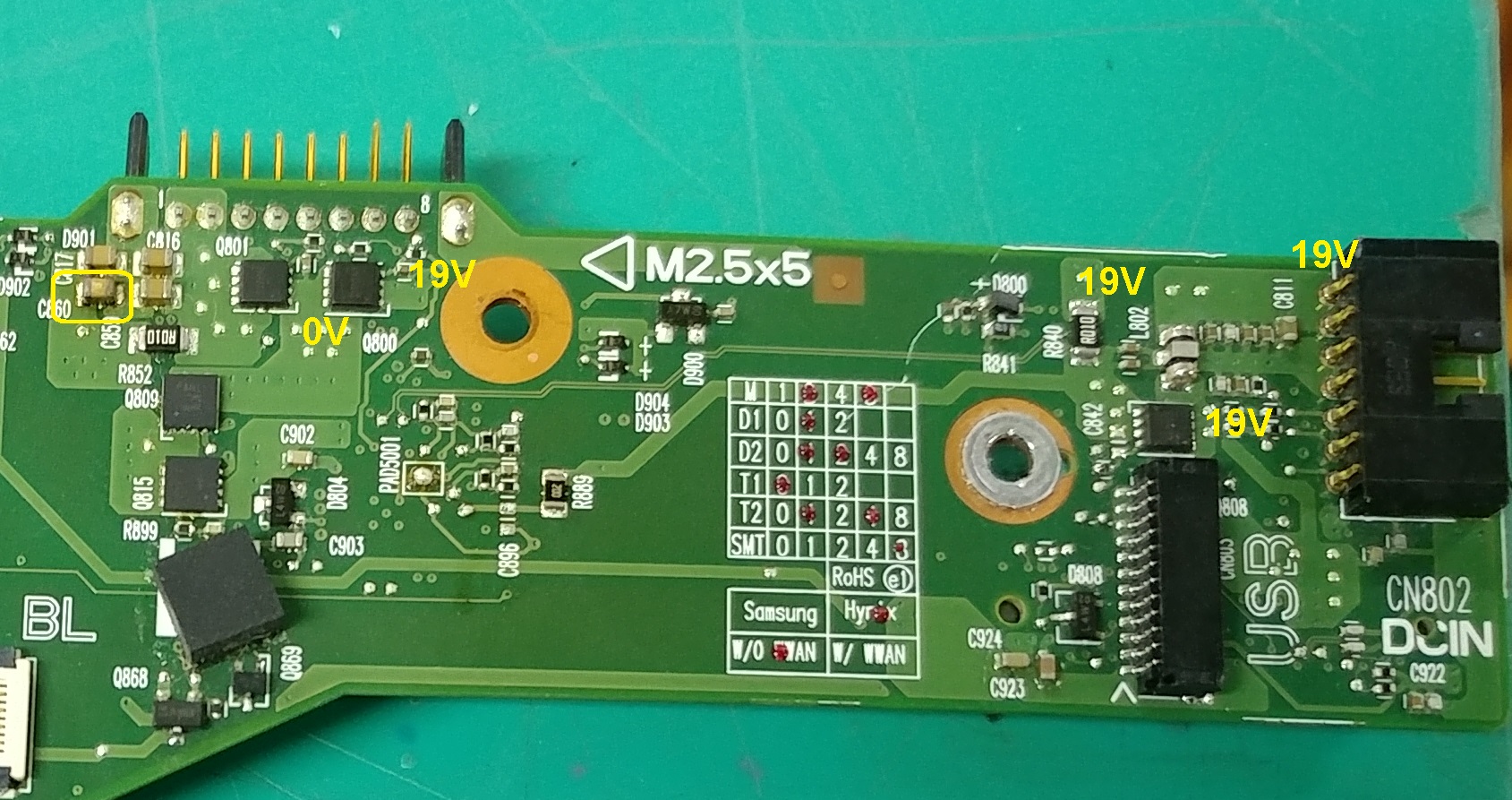

            Hello stingerchamp, even after reading the beginner guidelines again, I'm not sure what CSP and CSN are since these abbreviations are not mentioned in the text.
            However I hope you'll be able to show me on the real world example. Recently, I have successfully repaired motherboard by sheer luck because faulty (shorted) cap had black marks and was short to ground. When I removed this cap everything worked OK.
            Here on the attached picture one can see charging port connector and battery connector.
            Can you please tell me what is the CRL in this picture?
            I know that CSP and CSN are probably outputs from IC battery charger chip.
            I assume that this IC is on the other side of the board and that CLR is actually R889.
              Re: Short on motherboard power rail - general question
              It is in every motherboard
              It is just a name of pads of a current limiting resistor or power resistor
              Current sense positive csip
              Current sense negative csin
              These are pins 1,2 of a charging ic through which
              Charging ic check correct current sensed or not
                Ok thank you. so these two pins are labeled ACP and ACN on the schematics you attached. I understand now.
