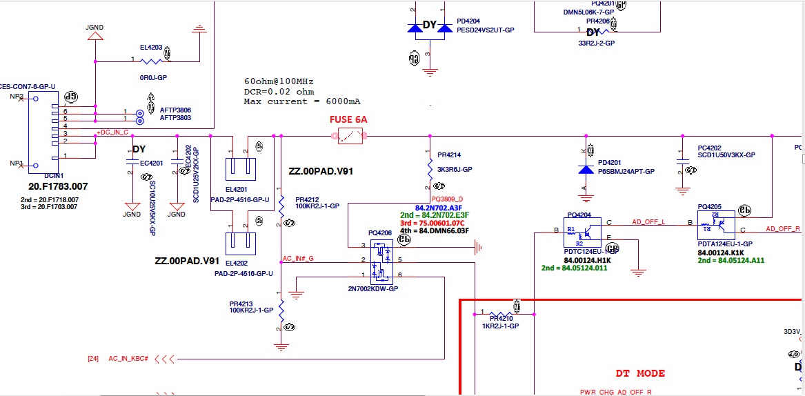

    What will happen when charger is reversed polarity?
    Hi all, I've got a laptop coming in soon and apparently they used an external power bank to deliver 19v to DC Jack so they can charge out and about. Which is fine, but they've accidentally got the polarity wrong and injected 19v through DC Jack. And it doesn't charge anymore or work of DC Jack, but works of remaining battery. My assumption is it'll be a simple case of replacing a diode which I believe it's job to prevent this happening and it may have burnt. Would I be right on this? Thanks

    Re: What will happen when charger is reversed polarity?
    Repair doesnt works on assumptions alone. You need to verify that on MB. That's a probability.
      As in the figure, there is a Fuse and a diode at the DC_IN input. You have to check it with the mutimeter.
