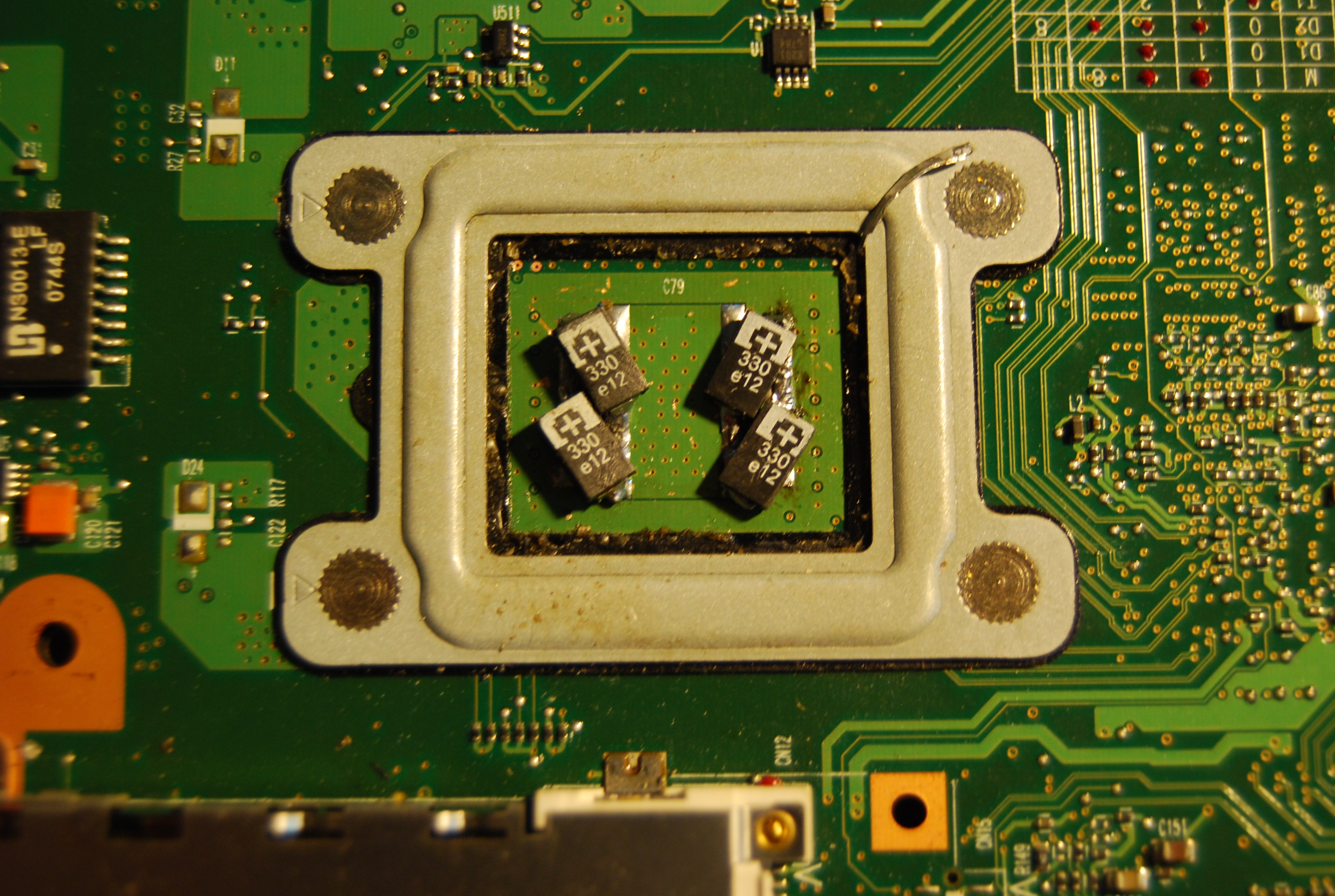

                      Hello! Re soldered them and turned out to be a remaining silver row plate from the old NEC/TOKIN still left below the solder so was not clearly visible. Should have cleaned it better...
                      Anyway after the resolder at the caps everything went along perfect powering the laptop with the adapter plugged in properly. I was very happy and begun to assemble the laptop. When I finished it started well but as soon as it got after the Windows (Vista) logo it restarted by itself... I tried again the same result.
                      I tried with battery only and loaded the Windows perfectly. Afterwards I plugged it in again while on and it worked for 10 minutes before it restarted itself again...
                      Any other suggestion cause it supposed to be fixed with the new Tantalum caps...
                      Here are some pics (notice the silver plate that was interrupting proper contact of caps)

                        I can't see all of the joints. Your iron isn't melting the solder properly. You need to look closely at where each capacitor tab is soldered to the PCB.
                        The capacitors should be ok judging by the seller's feedback.
                        Maybe someone who has used the same capacitors will comment now.

                          I too believe that the caps are not making full contact. Maybe not soldered good enough.

                              I have seen the caps and are making proper contact as far as I can see with my eyes.
                              Is there a proper way to test with multimeter??

                                Yes, use a multimeter. The computer still seems to have the symptoms of poor Vcore filtering. If you had spares, I would have suggested adding more capacitors.
                                Judging by the experiences of others, these capacitors don't seem to mind a lot of heating.
