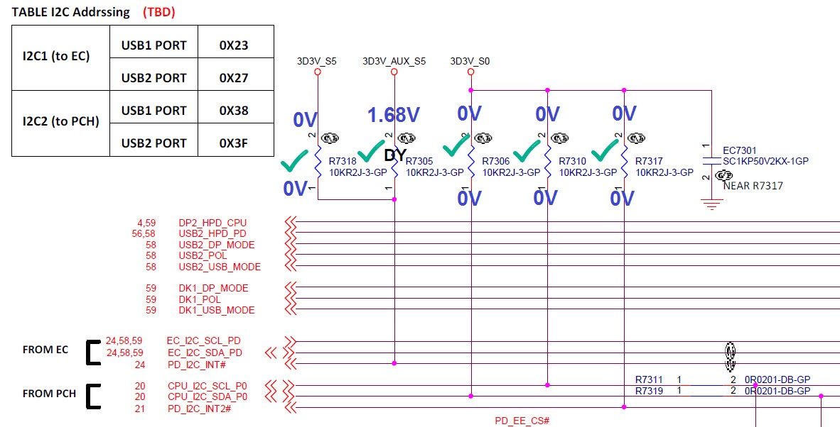

            Post the voltage for each of the pull-up resistors in the attachment.
            Interested in the voltage on each of the '_I2C_' lines.
            Update:
            Also confirm the voltages on the Power Delivery Flash device. See attachment.

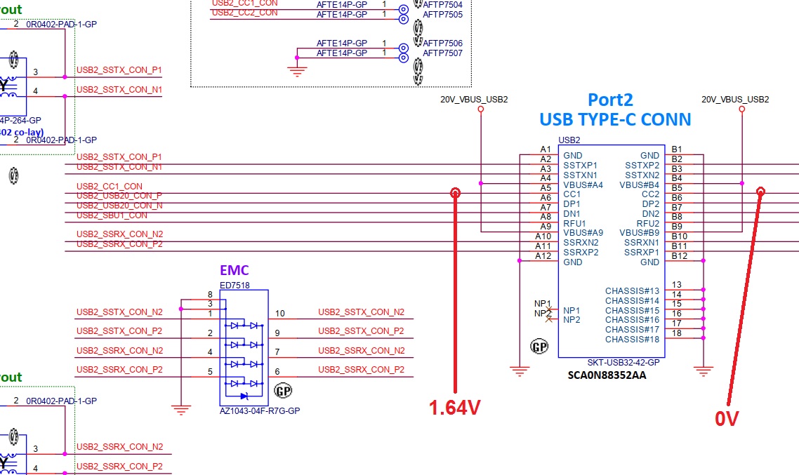

              Re: Lenovo L13 (USB-C VIN ONLY 5V NOT 20V)
              Can you also confirm if the CC1 & CC2 measurements were taken at the USB connector ?
              That is:
              USB2_CC1_CON
              USB2_CC2_CON
                sorry for the late reply and thank you for the interest in my problem.
                this is the all mesurements .

                    For this design, U7301 is the decision maker for the power delivery contracts. This is an intelligent controller that communicates with the outside power adapter (type C) to request a catalog of power delivery contracts (voltage & current pairs). Then this component @ U7301 selects the best choice for the logic board (20v) to move forward.
                    Respectively, the communication is over the CC1 and CC2 lines.
                    You can try to flip the type C connector upside down and test again. Suggest to always, remove power on the type C adapter, seat the connector and then plug into the wall. This way, there is no 'hot' circuit on the adapters. Safer this way.
                    Do confirm that the type C contacts are CLEAN with alcohol & Q-tips. Have seen many burnt or liquid damaged contacts in our shop.
                    Next, between U7301 & the physical connector on the laptop is an ESD protection device @ U7503. It is very possible that this device is damaged and blocking the communication between the Type C controller (U7301) & the outside world (type C power adapter).
                    Check in diode mode, with all power removed, the readings of pins 11 & 12 on U7503.
                    Also, pins 4, 5, 6 and 7.
                    Check for any physical damage - clean up the solder contacts of any debris.

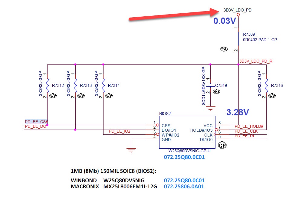

                      I just got this same notebook with the same problem on my workbench.
                      Only got 5V on the USB-C Connector.
                      there is no activity on the CC1 and CC2 pins.
                      replaced U7503 (CC Protection IC) -> no change
                      3D3V_LDO_PD is present.
                      3D3V_S5 is at 0V, which is guess could be normal in this state.
                      i see some periodic activity on the CS# bin of BIOS2 (EC7301) which i guess is the Firmware for the TPS65988DH (U7301).
                      I would like to reflash its rom, but could not find a dump anywhere, tried to find it inside the official bios update file from lenovo and inside the dump offered here.
                      Could somone please make a dump of this chip?
                      i will attach the one i read from my defective board,
                      Best regards.

                        had the same notebook for repair with another issue, dumped the chip. I can't guarantee that this dump is fully functional, because the computer turned always off after few seconds, but voltage was always present.
                        Give it a try and let me know.
                        https://www.badcaps.net/forum/attach...5&d=1648656194
                        BR, Ray
                            REpairAT
                            you save the day your dump worked for me .
