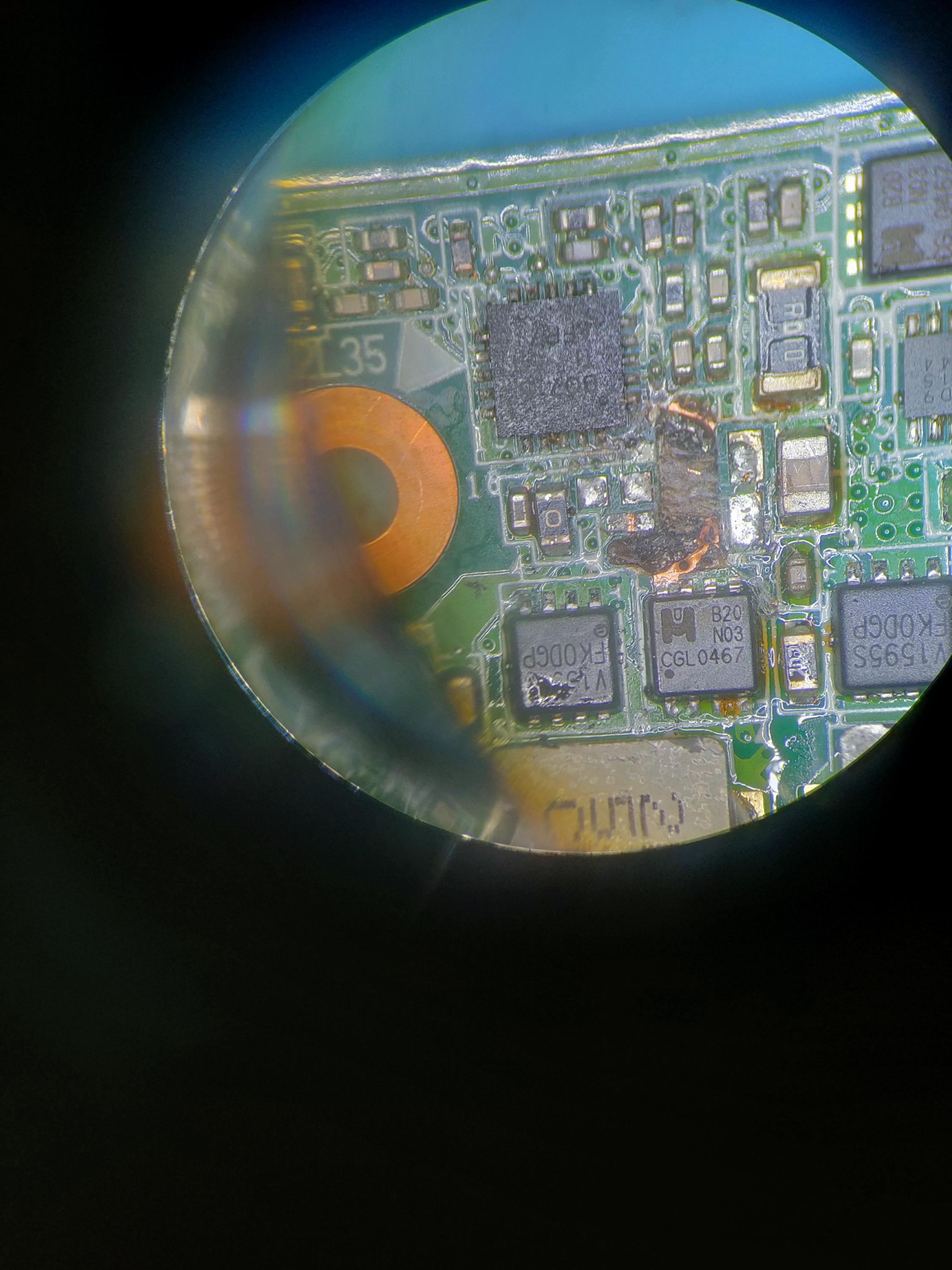

    I've received from a friend this laptop that doesn't turn on or charge, no led indicator or amperage drawn from the external psu.

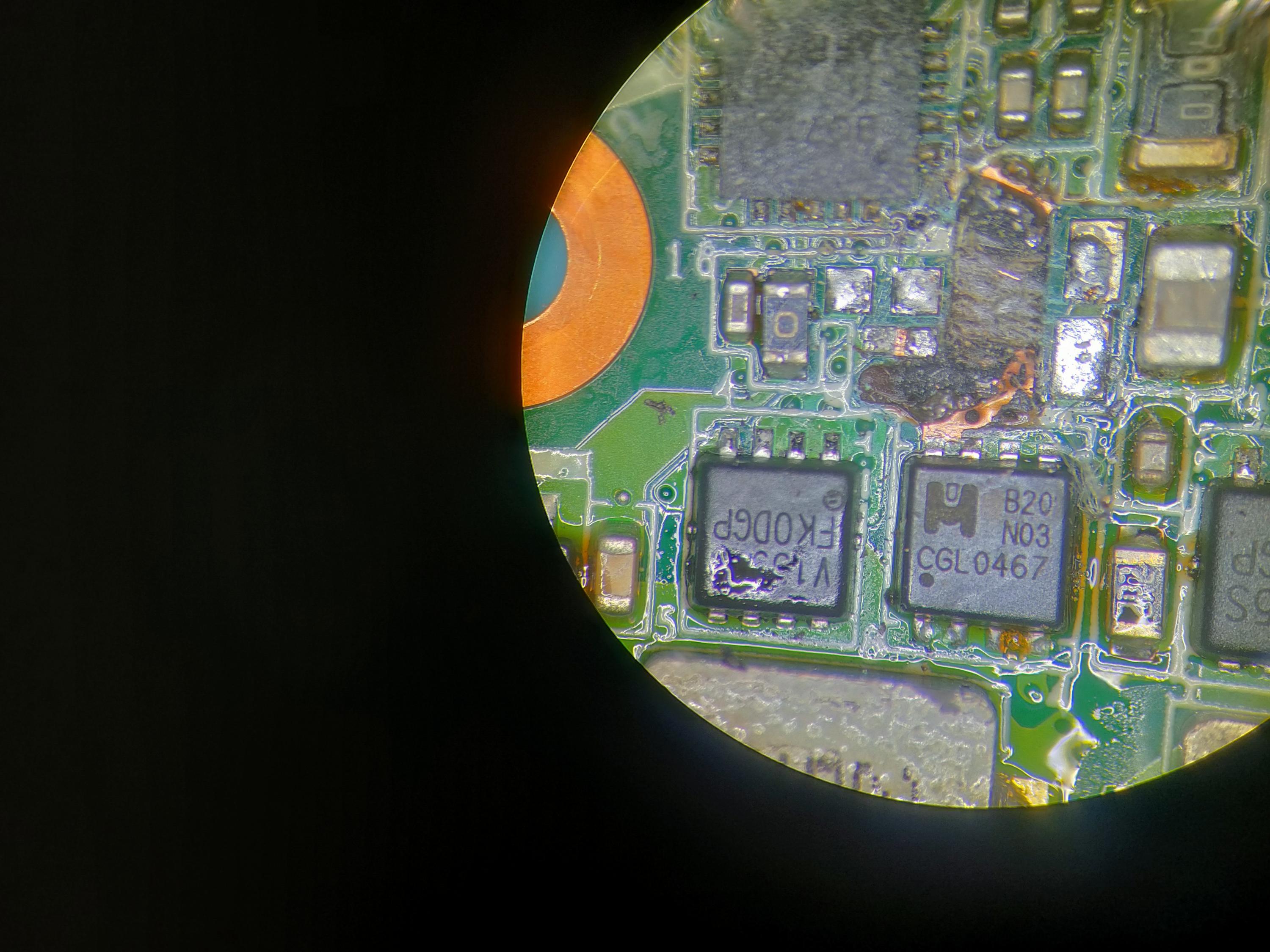

    After visually inspecting the main board, i've found some burnt capacitors and resistors. After removing them I end up with this aftermath (see the attached photo).
    In your honest opinion, is it worth trying to fix it? I've downloaded the schematics but I don't know if they are made for that exact pcb, from what i've seen on this forum, this issue is pretty common for this hp board, exept that in my case it went horribly wrong.
    Do you have any suggestions to help me starting troubleshooting?
    So far, i''ve measured the voltages of some mosfet pins nearby the messy area.
    The pin #8 of PQ6 measure 19V, so there's no apparent short to main.
    PU1 seem to be healthy too but I will need to check it better.
    If anyone has any hints on where to focus the troubleshooting I'd be very glad to check the board.
    I've attached also the boardview i've found online and the software to read it.

    Hello again, just a quick update on the measure I did:
    PQ8:
    -measuring in resistance mode and in diode mode show a 1ohm short between drain and source
    -no short to ground in any pin
    -drain to gate and source to gate resistance is always 625 and 600 ohm
    -when connected a dc power supply, all G,D,S measure 19V
    The burnt pcb layer that hosted the components PC29, PC20, PC30,PC31, is now a ground plane that didn't merge with the 19v upper layer line +AC_CHG_IN. I did isolate the layer with UV mask.
    I tried to put 11V on the pins 4-5-6 on CN19 to see if there are any sign of life, after pressing the power button the DC jack led blink 3 times with no other sign and no amps are being drawned.
    Do you think that PQ8 need to be replaced?
