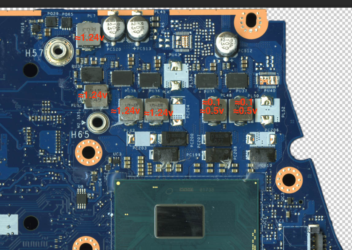

    CPU Driver/Mosfet is ncp81382 https://cdn.badcaps-static.com/pdfs/...8509f4fedb.pdf
    Cpu power cntrol by Onsemi NCP81205

    Okay. I missed that these rails are for GT internal graphics

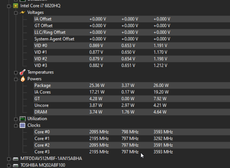

    After downgrade of bios, the cpu got up to 30w of power. Will test cpu voltages under continuous load.

      What is the wattage of your adapter?
