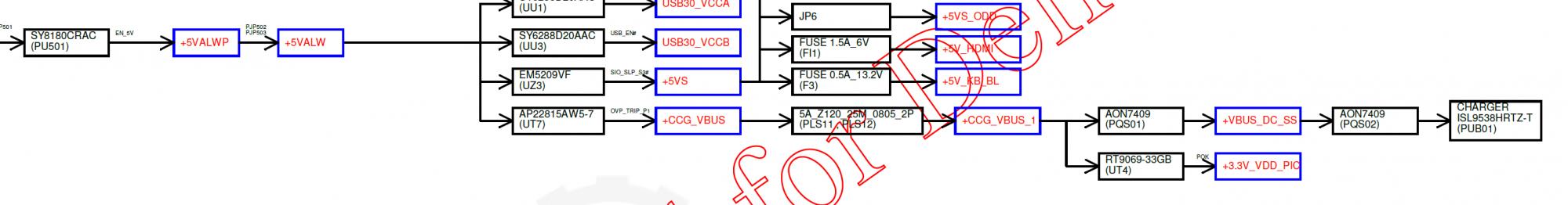

    Laptop had destroyed DC IN jack, most likely shorted the 1Wire bus to +19V since PD1 protection diode was burnt to crisp, nothing else appears damaged. Removed the damaged diode for test and replaced power jack, used known good power supply for testing and the laptop powers up, in BIOS it shows "AC Adapter = Not Installed" so a bit unusual, usually they show up as Unknown power so I assumed it completely doesn't detect AC IN somehow and sure enough the entire +3.3V_VBUS_IN is dead, no short. There is no +CCG_VBUS present either, AC_OK signal is around ~2V. PQS01 MOSFET is good but does not get power to the gate. Traced it to UT7 chip that's supposed to control it, but it doesn't have anything on any of it's pins either.
    According to the power control diagram, it's supposed to get a signal from UT1 with signal OVP_TRIP_P1 and VBUS_P_CTRL_P1
    Now there is 0V on both of those. I lifted the Enable pin leg of UT7 and pulled it to 5V for test, the PQS01 turns on, both +CCG_VBUS and +3.3V_VBUS_IN are present, but laptop won't start, it's unhappy about the little uncommanded power detour. Turns off after few seconds.
    Is UT1 bad? Is something else responsible for this? I feel like I went too far into the rabbit hole and missed something earlier but I can't find anything. Any ideas? Nothing jumping out at me at thermal survey, +19V rail consumption is normal at 0.4A while in BIOS, fan cycles from time to time.

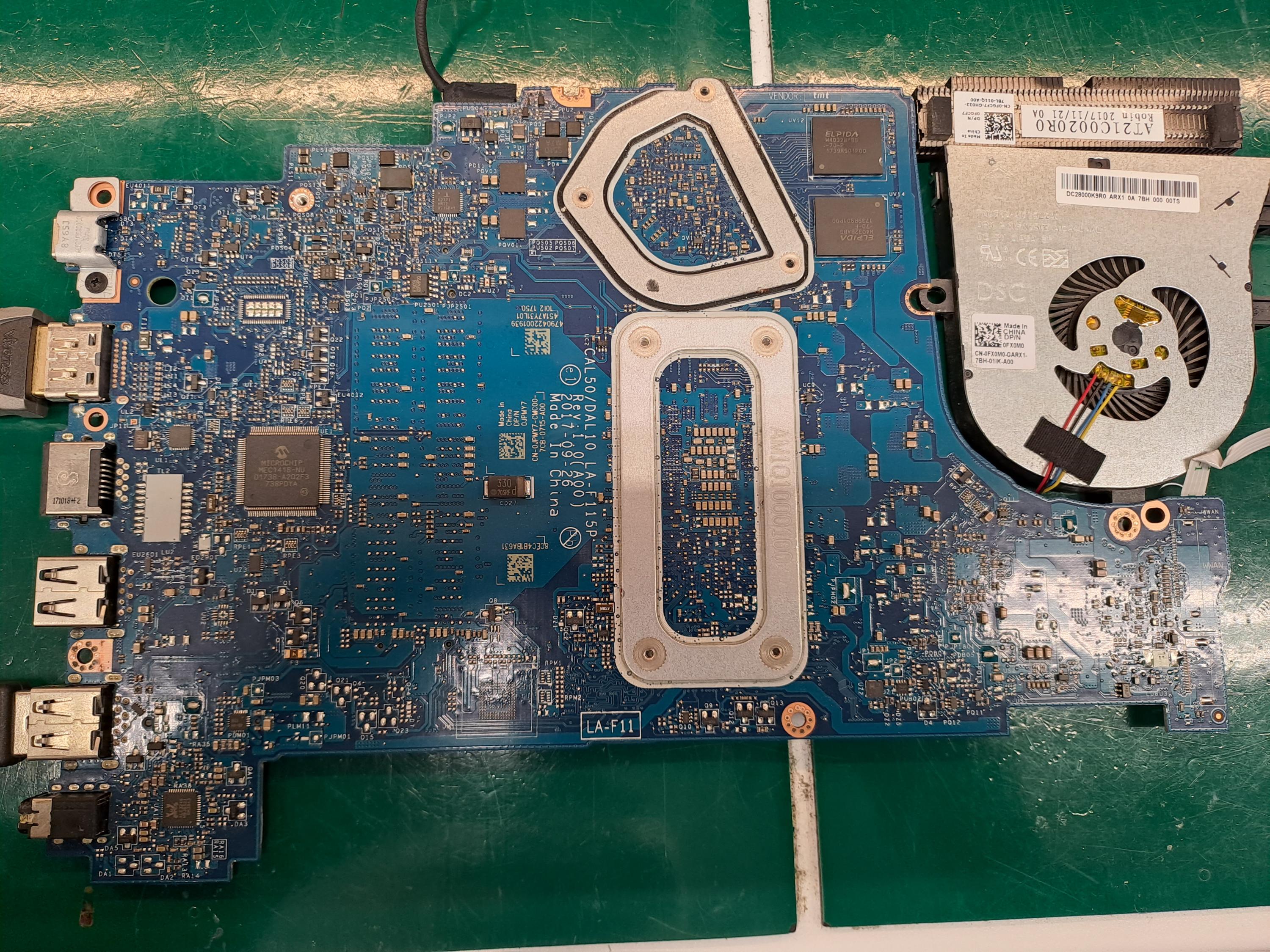

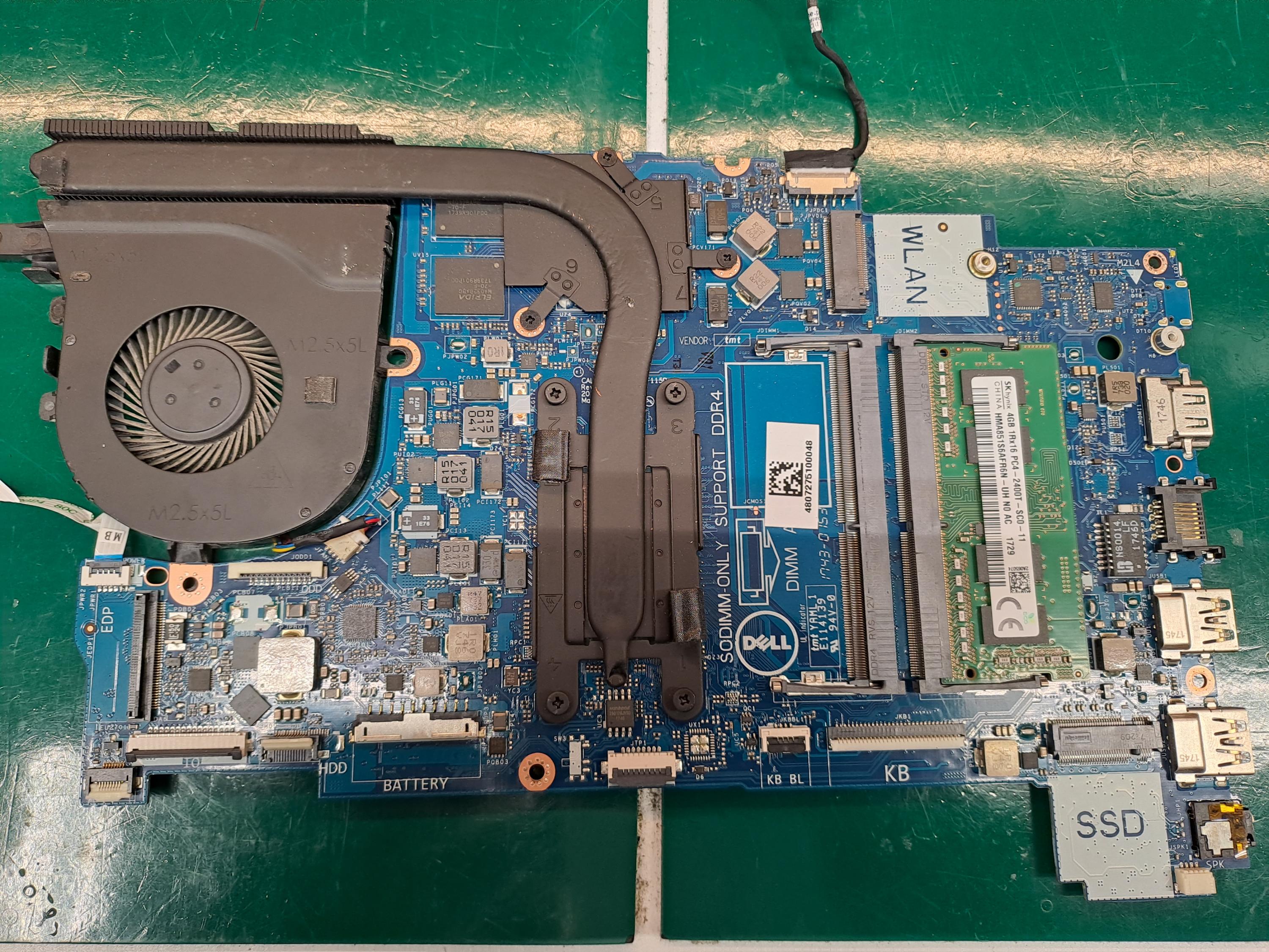

    Board pics:
    Thanks for any suggestions! Schematic and Boardview (works in BoardViewer) attached.

      Hi, With laptop booted up, can you exercise any PD bits to see if UT7 is working ? (like charging the laptop using the USB c cable or charging a device like phone through the USB c port). The OVP_TRIP_P1 is active low so in normal case this should be driven high but I understand you have seen this signal low ?.

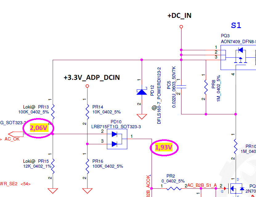

          Have you checked the voltage divider resistors for ACOK?? ACOK must be 3V as you are aware and i think unless acok is fixed,it wont work.

              Sorry I could have made it clearer. I was trying to reply to your question on whether UT1 (CYPD4125) is faulty. You might already know this, but for the sake of clarity - The main function of UT1 is that it does power delivery (PD). The chip itself is an ARM-based microcontroller with flash and ROM. So to check if this chip is working, the best way I think is to exercise PD, like charging through a USB C or charging a fast-charging capable phone, and see if the chip (UT1) can do fast charging.
              As for OVP_TRIP_P1, it is active-low signal and if the chip detects an over voltage then it should drive it low, otherwise for normal operations, it should be high, switching QT5 ON, thereby passing VBUS_P_CTRL_P1 to enable pin of over current protector chip UT7. So there is a kind of logical AND operation happening where VBUS_P_CTRL_P1 AND OVP_TRIP_P1 should be high for OC chip to be enabled.
              Therefore I believe the chip (UT7) will be enabled only if discharge operation is active (as in you have plugged a device into the usb port). Can you measure these signals (OVP_TRIP_P1 and VBUS_P_CTRL_P1) by plugging a USB device?

                ACOK measures around 2V, according to the voltage divider on the schematics that's spot on. Added my measurements to a screenshot of part of schematic.
                ISL9538 pin 24 ACOK "ACOK_CHG" = 3V
                AC_PRESENT signal is 3,3V
                ACAV_IN1 is 3V
