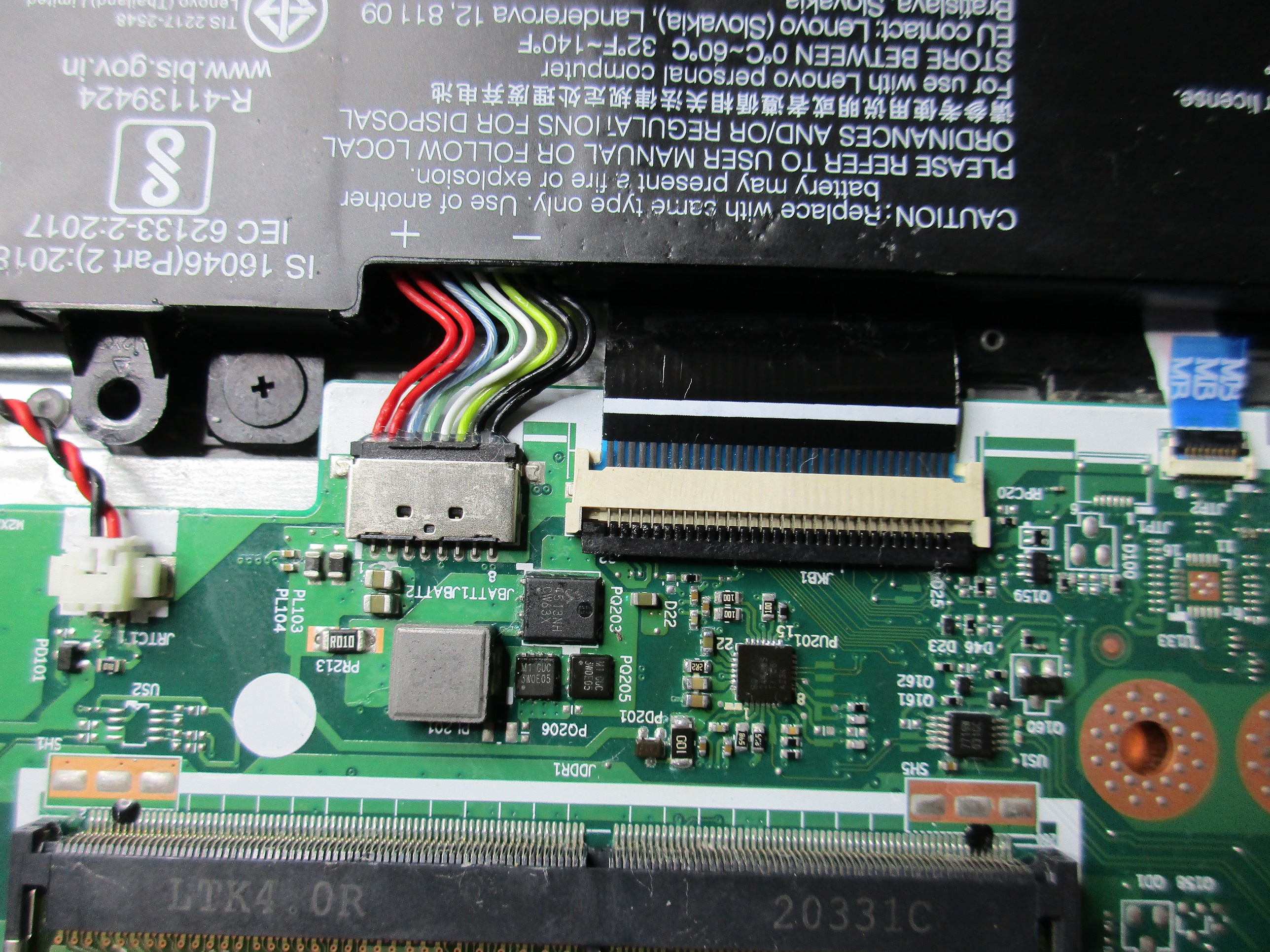

    Hello all, need some help on a Lenovo Ideapad 3 in wich the battery is not charging. Weird thing is the light on the power button flashing.
    At what voltage should the battery charge? I'm measuring 4.1v at the current sense resistor near the battery connector.

          The Mosfets are all n-Channel - 1x4513NH + 2x3W0E05 (according to the schematic it's AON7380 in a 3x3mm package)
          PQ203
          Gate - 4.37V
          Source - 4.37v
          Drain - 20.39v
          PQ205
          Gate - 4.41V
          Source - 4.41v
          Drain - 20.39v
          PQ206
          Gate - 182.6mv
          Source - 0.2mv
          Drain - 4.42v
          IC Charger BQ24780s

                  Weird stuff now the laptop shut itself off and wont turn on again. Main power rail is out
                  First Power Mosfet PQ201 at the source now measures 59.5mv?! instead of 20v

                      Yes I do have the 20v at the DC IN, first mosfet has the 20v at the drain , but only 58mv at the source and gate.
                      2nd mosfet 112mv at the gate and 55mv at source. Drain 1.3mv
                      ACDRV with or without the 4k resistor has 64.4mv

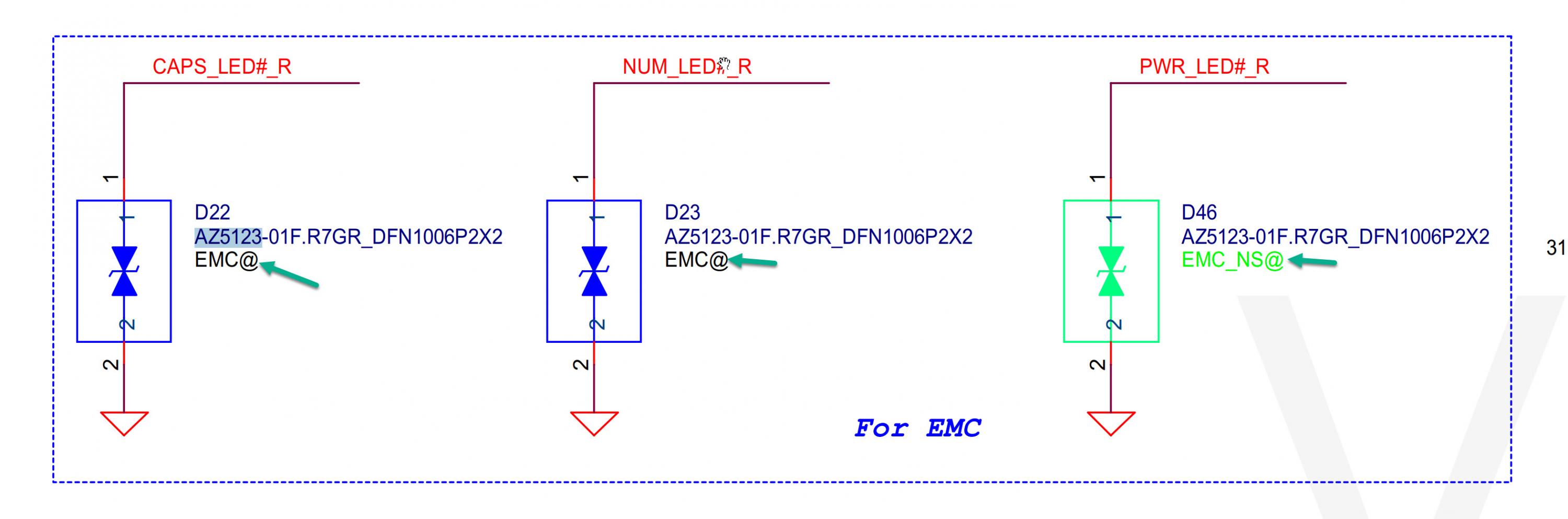

                              Hi mon2, good news, laptop is back online and fully charged. BQ24780s was faulty. I found out that there was some corrosion underneath the chip and also on D22 wich is a voltage supressor (AZ5123-01F), that is connected to Caps Lock light, which is now not working and also Numlock light. Do you think if it is ok to put in a 0 ohm resistor, bridge it or replace it with a filter

                                See attached. The diode @ D22 and others in the posted partial schematic are ESD transient devices that will be not active till there is a transient (surge). At that point, they will shunt the voltage spike to ground and often short circuit.
                                Respectively, you DO NOT bridge / short these pads. These are devices that camp on the signal rail and jump in to protect the line if there is a nasty surge voltage event.
                                Also note the '@' suffix which often means the part is NOT stuffed during PCB assembly time. Are you sure there were these parts even on your logic board.
                                A nice to have is to apply them if available but they will not stop the board from working. Each of these keyboard signals are ACTIVE LOW (noted with the '#' suffix = ACTIVE LOW). So if the line is LOW, the light should turn ON.
                                What voltage to ground do you read @ CAPS_LED#_R ?
                                  Re: Lenovo IdeaPad 3-15ADA05 Not Charging
                                  It's 3.34v, and yes it was there, because I was trying to remove the corrosion and it broke in half
