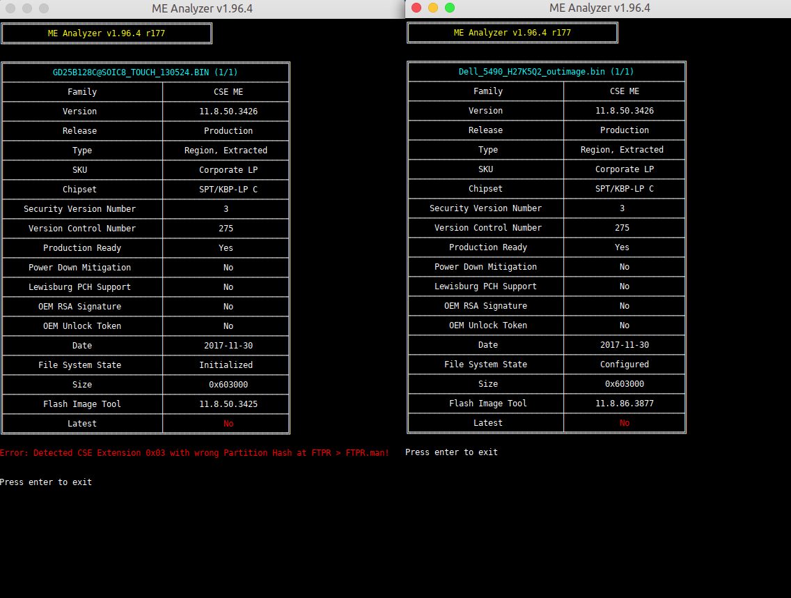

Dell Latitude 5490 LA-F401P rev 1.0(a00) need bios

    Thank you per your help but the notebook didn't work.
    Someone have other bios can i try?
    I remember my service tag: H27K5Q2
    Above there is there is my last working backup.
    Regards everyone

        I don't have any videos yet. Does anyone have any other bios to try?
        can I put a winbond flash instead of the gigadevice?
        the original is the 25B128C can I put a 25Q128JV?
        Thank you

            hi, with your bios the notebook LED turns on and after 1 second it turns off, while with the other bios it turned on and off 3 times remaining on (always with a black screen).
            Could you also explain to me why by reprogramming my backup bios and therefore what used to work now it no longer works?
            The problem that pushed me to reprogram the bios was because I couldn't update it and it also had a slow post.
            Thank you

                      hii...
                      some la-f401p (5490) need battery & ssd need for display output. try to insert m2 and battery
