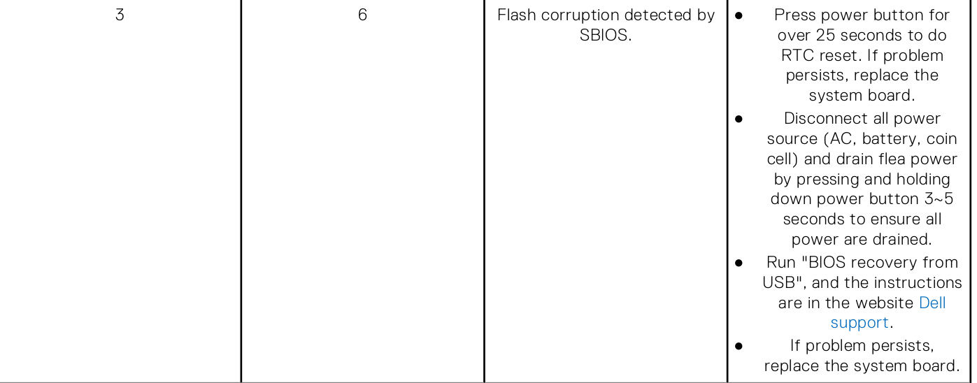

                                      Now you should be able to program the BIOS chip correctly.
                                      According to Dell Blinking pattern 3 x Amber 6 x white Flash corruption detected by sbios
