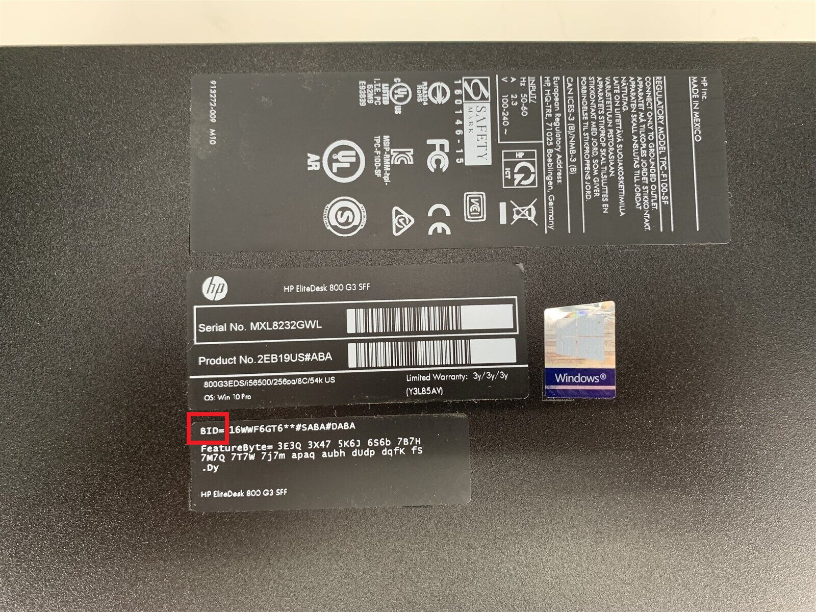

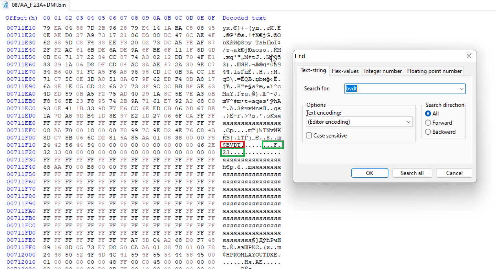

    Find BID number (Bios ID - not to be mistaken by Build ID also written as BID and printed at the factory label along with the Serial number, FeatureByte and other manufacturing info - the example is shown at the third image below in the end of the post) in your bios backup using a hex editor searching for $BID:
    In this case BID number is 087AA, and the bios version is F.23
    Bios version can also be found by searching for $BVDT:
    Example of Build ID written as BID and printed at the factory label:
