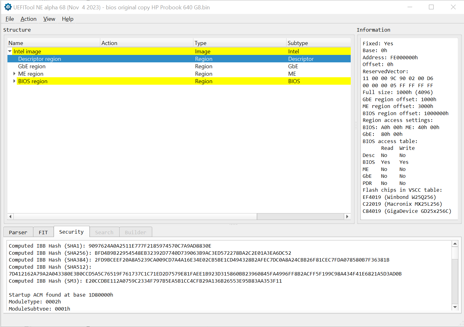

                Hello all, I have in a job lot a HP ProBook 640 G8, one of the bios chips is missing and I am not
                sure the chip that's fitted is even the original chip looks like its been replaced.
                SN, 5CD1360KBZ
                MB, DAOX8QMB8E0 REV E
                Is there any hope for this laptop? I have tried every set of chips I can find with no luck.
                Anyone have a good working set they could share please.
                Thanks.

                  What are the silkscreen markings for both, are there numbers like U365 or writing such as Bios1 EC_Bios .Backup the chip thats there and open it with HxD, download the bios from post 1 and open that as well, scroll through each one, if yours is a close match then it`s the main bios, but not necessarily the right one. Search for the serial number in the bios with HxD, a text search,and for the Text encoding option select Unicode ,if the serial number is found thats good. The main bios at post 1 has 3 chips in the VSCC table, see the picture below

                    Thank SMDFlea for trying to help on this one, It turns out the bios chip I have is the original.
                    I have got this info from the bin file, the mac looks a little odd to me.
                    Product Name : HP ProBook 640 G8 Notebook PC
                    Serial Number : 5CD1360K8Z
                    Product Configuration ID : 2Q013AV
                    BuildID : 20WWISDT601#SAK8#DAK8
                    FeatureByte : 3X476J6S6b7B7H7M7Q7W7m7saBaEapaqauawbUbhcAdUdpdqfAfPguhKhkjhk8mEn7nVpD.r7
                    System Board CT Number : PKXXL058JFM0RN
                    MAC Address : 88-88-88-88-87-88
                    I think the bios file at post 1 is a EC bios file and the one I have from the laptop is the Main bios.
                    Any more help would be really good as not sure what now, do I try both files together in the laptop see if it displays anything?
                    Thanks so much mate. I added my main bios may help.

                      Try these, flash both.
                        Hello SMDFlea thank you so much for your help, sorry I have been away for a few days, tested these files
                        all I get is an orange flashing led near the power supply, no post if anyone has any ideas that would be great thanks.
